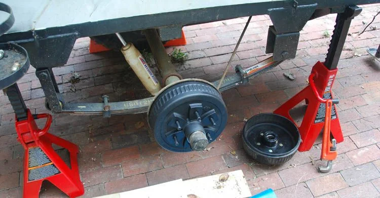

get the bearing details, that will help. when i gave the etrailer guys my bearings they told me i had a 3500# axle that took 10" drums, which are plentiful in many bolt combos. and they can also tell you if e-brakes are an option too (i left mine a physical emergency brake for now, electric brakes are on my radar, but i needed to get out and enjoy it for a bit first!)
new hub mounted, 'old hub' on the ground:
attachment.php
note how extended the emergency brake cable was - it actually pushed the shoes out and made removing the drum difficult. i think the e-brake lines being lenghtened (if they can even be kept) when i put on power-electric brakes will be on my list of todo's.

Hakalugi's trailer does not have the same axles as your WWII trailer. (His appears to be a Canadian M101 trailer.) Changing your lug pattern won't be as easy as your axle has full floating hubs and the center hole on your TJ wheels is too small to slide over those hubs.
Your least expensive option will be to order a Dexter axle with the appropriate weight rating and lug pattern, which you can order with electric brakes. You will need to do some careful measuring and take into consideration the backspacing on the wheels you intend to use. It won't be as simple as measuring hub face to hub face, but its very do-able. If you search this forum I think you will find at least one thread where someone has already done it and posted the appropriate axle measurements for a WWI military trailer using a Toyota wheel, and maybe even a TJ wheel. (Note: the Viet Nam era M416 will have a different axle measurement, be sure you are comparing apples and apples.)
I once researched the possibility of modifying the military parking brakes on the stock Bantam axle to operational service brakes. (I didn't need to consider a new lug pattern as my tow rig is a jeep with the 5x51/2 lug pattern.) My conclusion was that the only practical way to do it was to use an electric over hydraulic system with master cylinder mounted on the trailer. There are some slick setups, but way too pricey.
