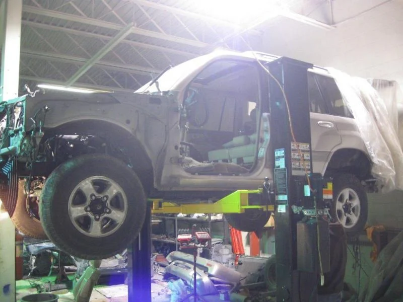

eleblanc
Droping body on frame!

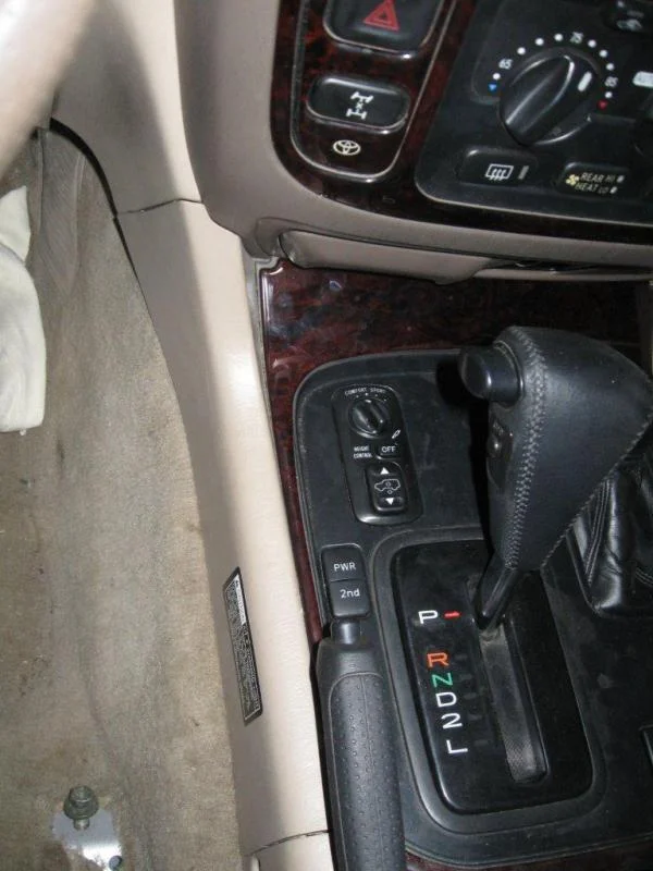

Factory locker! And power heater AWESOME feature, get your coolant warm enough for inside heat within 5 minutes, otherwise the diesel take 45 minutes to heat up to get some heat inside. It activate a Viscous heater.

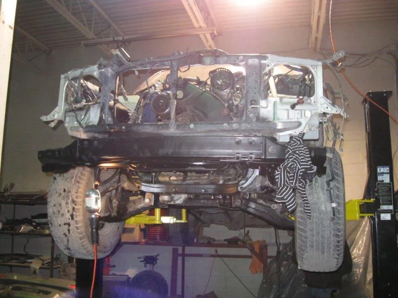

Concerning my experience between the UZJ and HDJ. The engine mount are not the same and not at the same location. Then the tranny mount is further back 2" on the HDJ frame, because the HDJ as a A442F and the UZJ a A343. And consequently the torsion bar cross member is 2" backward and the HDJ with has longer torsion bar.

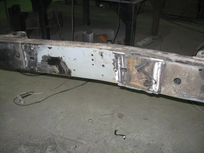

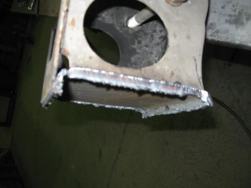

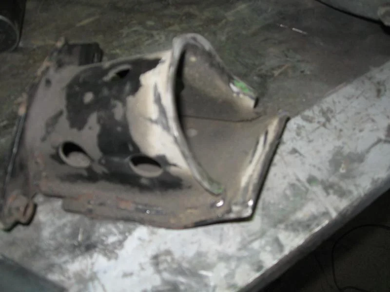

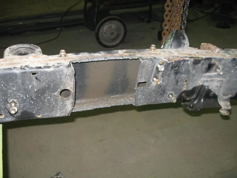

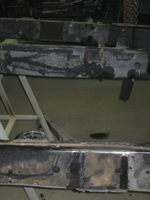

Fab work involved is very minimal, the HDJ was LHD, same for the UZJ. initially i knew the engine mount needed the be swap, But when we pulled the V8 out and realise the big difference in the tranny and a few measurement later we had to move the tranny and torsion bar cross member. So I decided to pull the frame from under the truck. But i think it took6-8 hours to cut the necessary part on the HDJ and UZJ frame and weld them back on the UZJ.
eleblanc
HDJ and UZJ frame side by side
attachment.php
UZJ frame with tranny and torsion bar cross member removed
attachment.php
Torsion bar cross member removed on the HDJ frame
attachment.php
HDJ Torsion bar cross member with part of the frame, once removed we grinded off the part of the frame on the cross member, once done we had a clean, like new, cross member to be reinstalled on the UZJ frame.
attachment.php
Engine mount ready to be reinstalled on the UZJ frame
attachment.php
