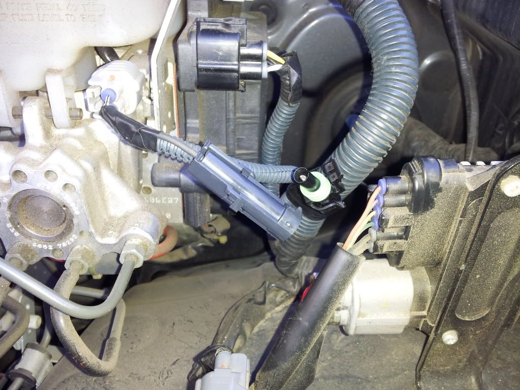

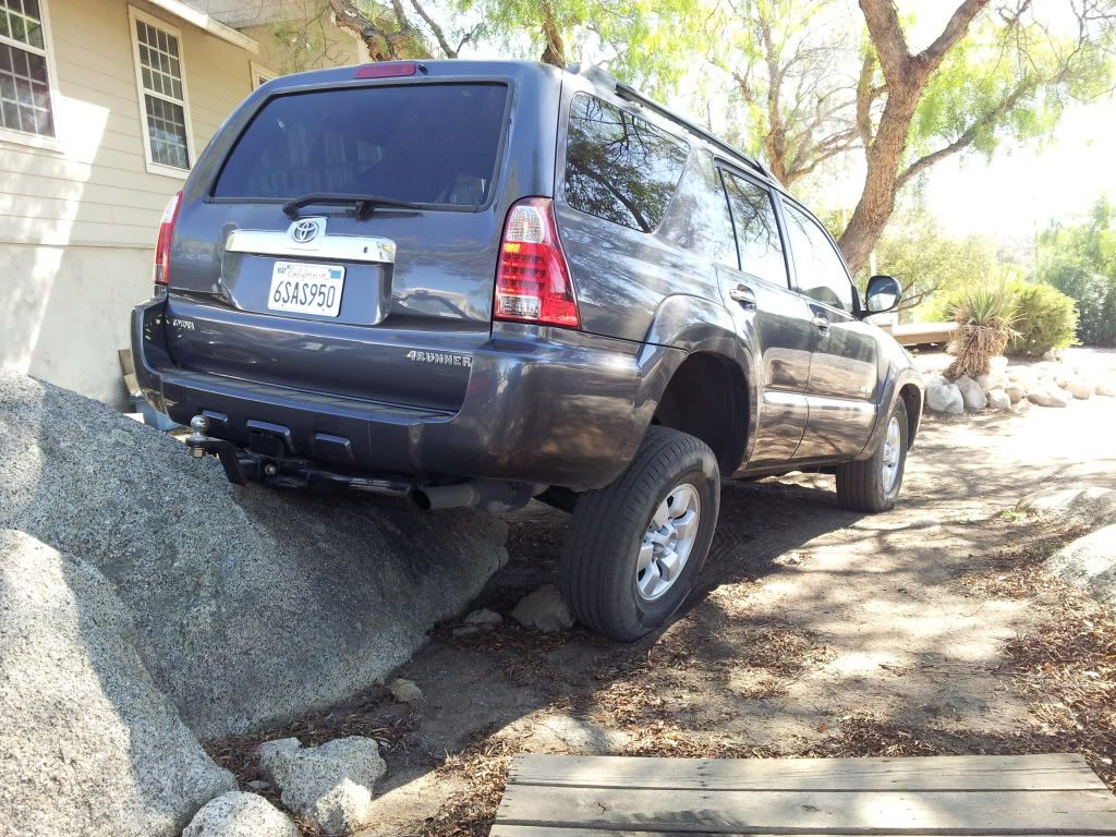

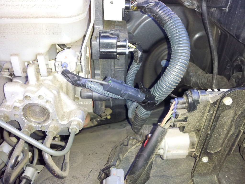

Ditched the carbon filter out of the air box. Started the vsc, trac disable mod. I put a single wire connector on the wire to provide the break in the circuit. I still need to get a switch and then I will just connect it to the connector, then to the switch. I figure this way if I have any other issues I can just plug it in under the hood and it looks factory.
And tested it on my rti rock (4lo works great too!)
Heres what the Subaru did on the same rock
Different view but I think for now the Subaru went a little further.
Lecoq
What is the wire mod going to accomplish? Does it turn VDC completely off without having to lock the front diff?
JacksonRally
Also turns off traction control. For instance with it connected I climbed that rock and when a wheel lifted and spun the traction control pulsates the abs module and does its thing. With it turned off you can just spin the tires when a wheel is lifted with out the annoying pulsation. Plus it takes you back a few years when we did not have traction control and we were suppossed to know how to drive :)

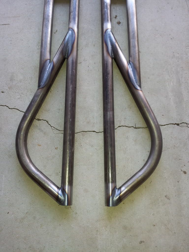

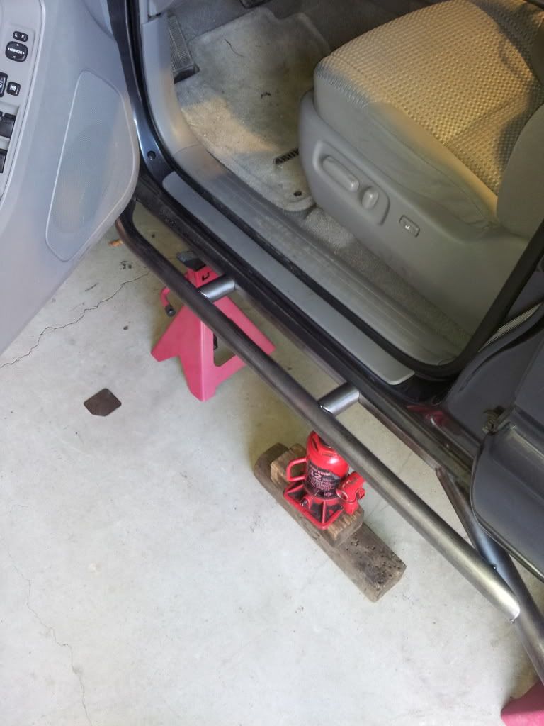

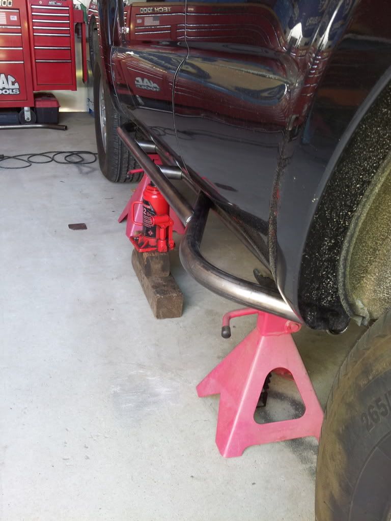

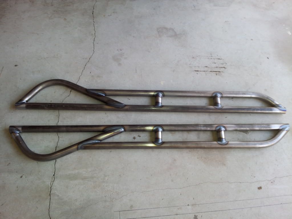

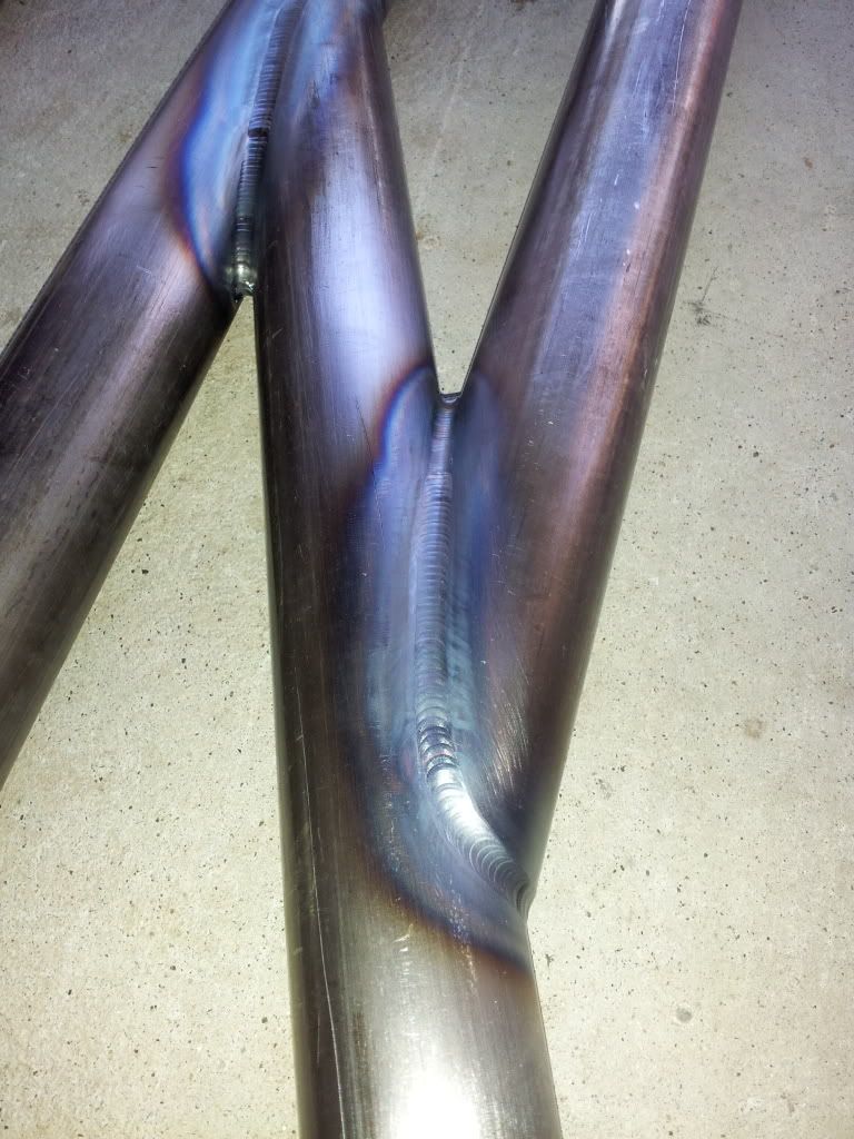

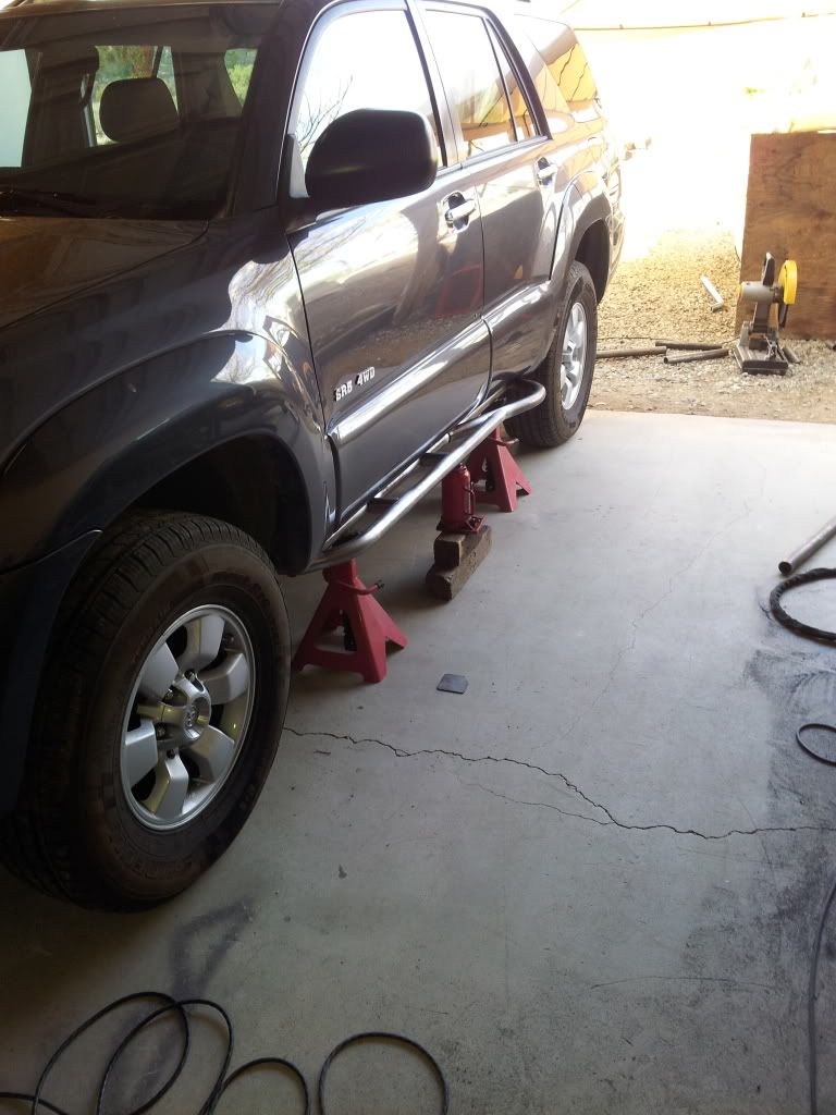

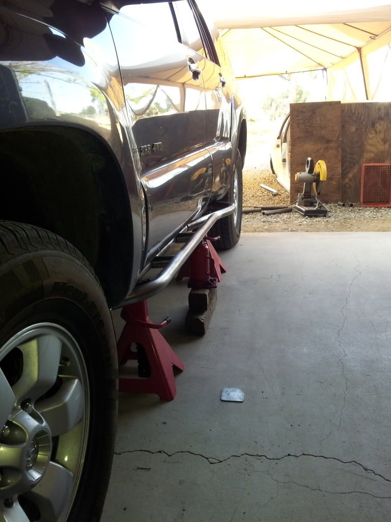

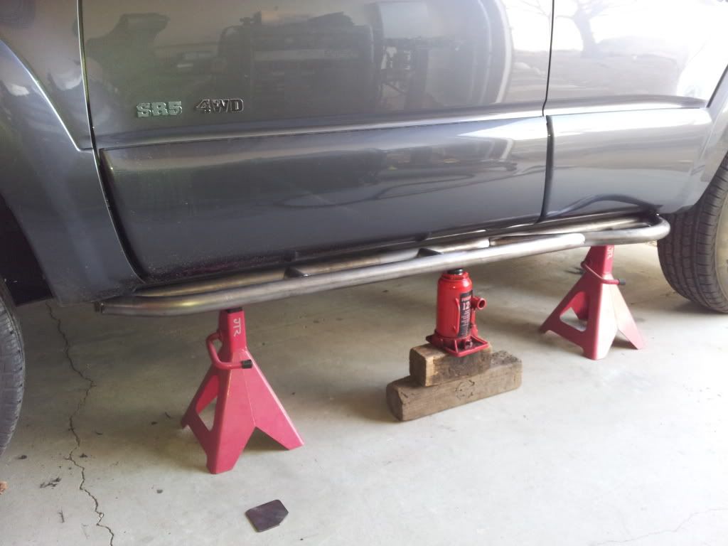

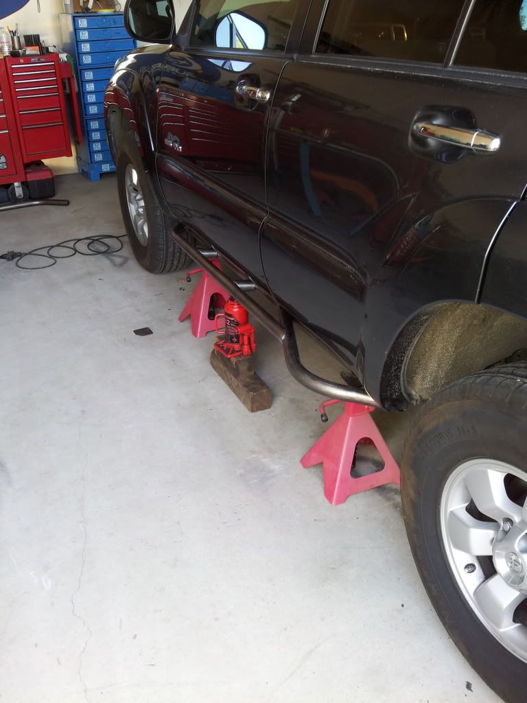

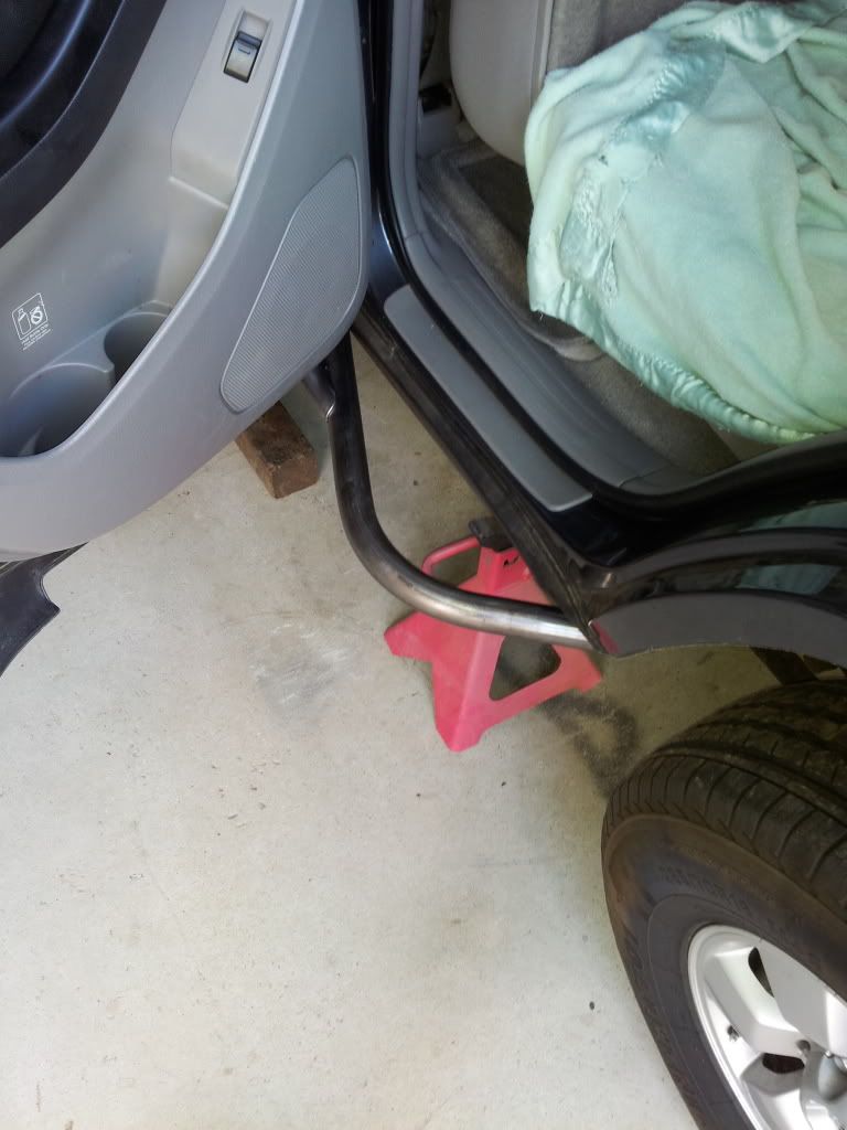

Found some time to get started on building sliders. Im using 1.75x.120 DOM. I will be welding these on but I am going to wait until I get lifted and proper tires.
I think I figured out exactly where I want them. I have not seen any in person so I am not exactly sure how far or close to put them to the pinch weld on the rocker panel. Im happy with where I have them mocked up, as they are pretty close to the pinch weld but plenty of clearance when opening doors. We'll see how I feel when it comes time to weld on.
Pics for now
ebg18t
those look awesome. Sorry for the delay, i was going to send you slider pictures next weekend once i get my truck back.
JacksonRally

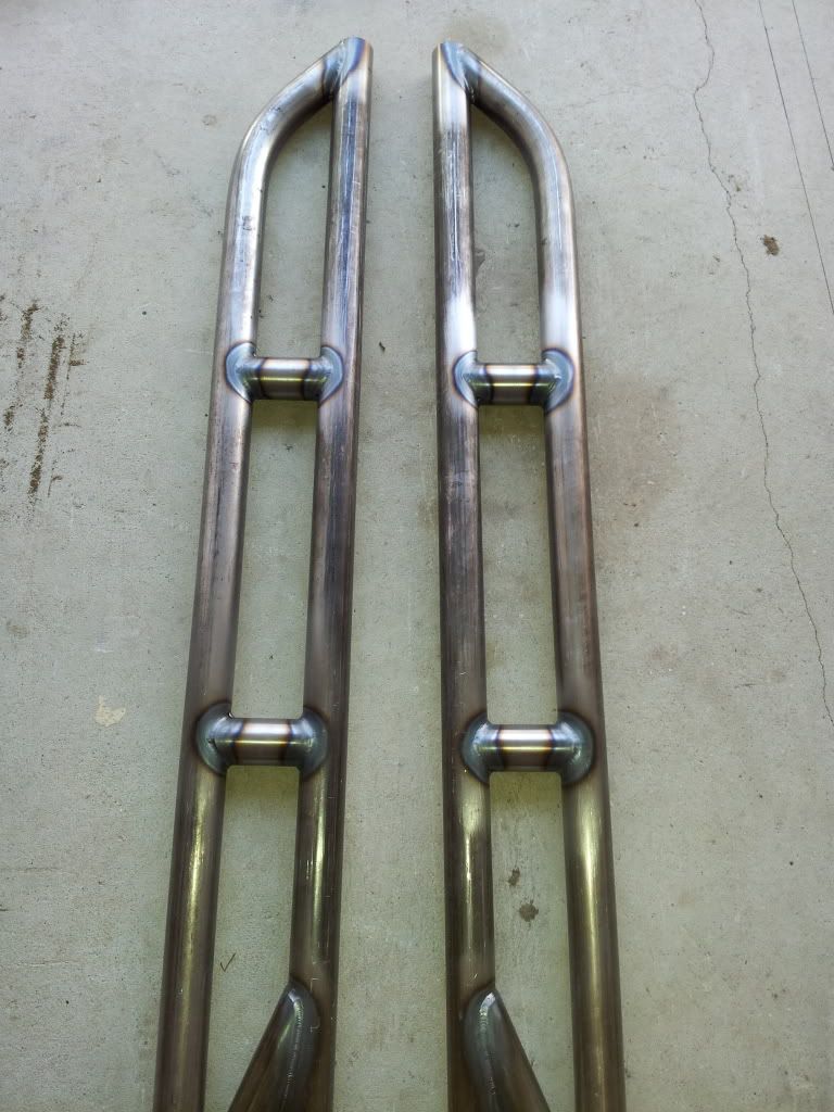

I got the main parts finished and welded. Ill do final install when I get the lift and tires. I really dont want to have to answer the questions people will ask if I install these on stock. More motivation to make some money for lift and tires :)
