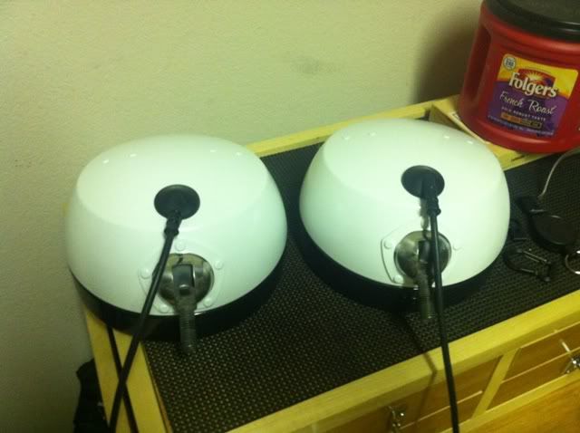

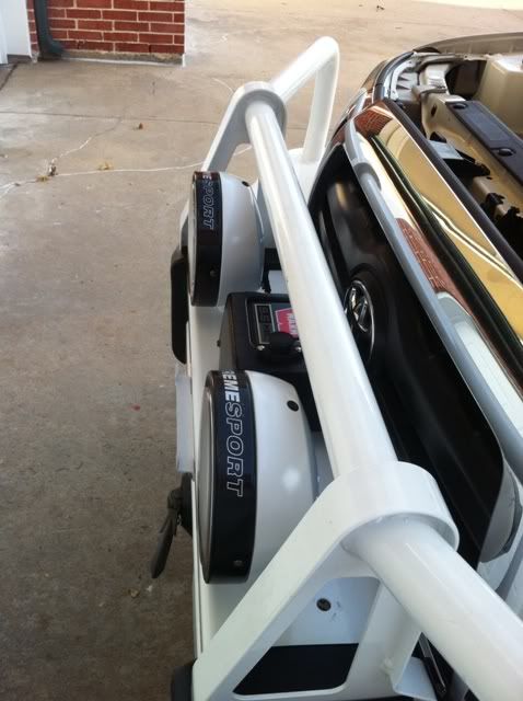

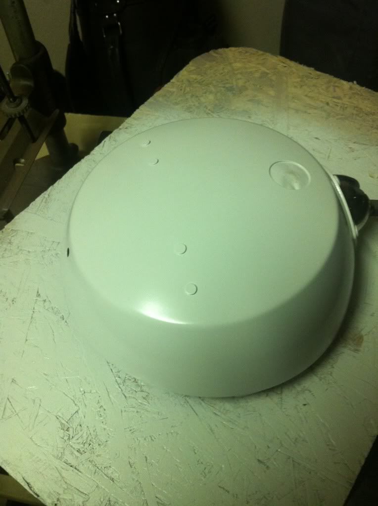

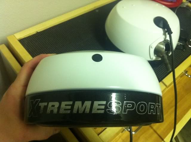

I decided to paint the back of my IPF lights white, to match the truck. The paint was starting to fade and chip in places anyways. I didn’t take any before pictures actually, but the lights were a gray color. The process was pretty easy, disassembled the lights and painted them with Rustoleum Semi Gloss white. I really like how they turned out.

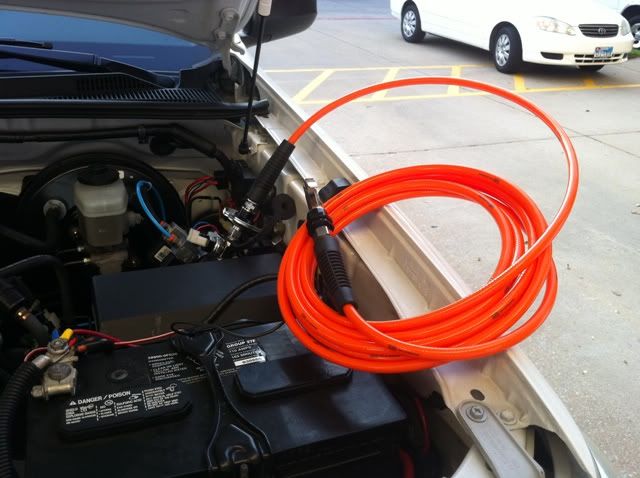

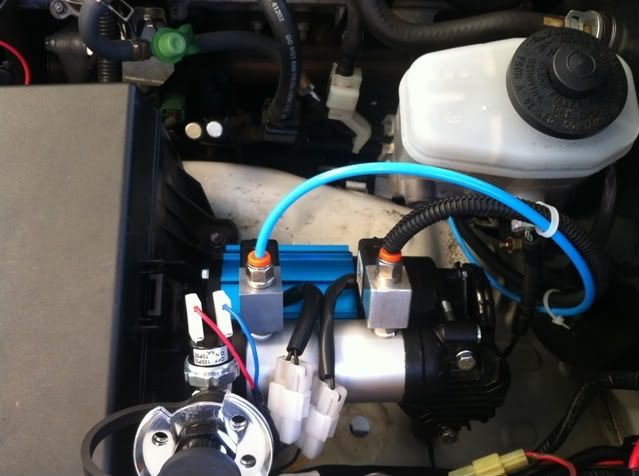

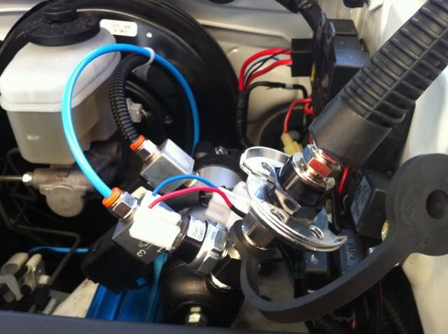

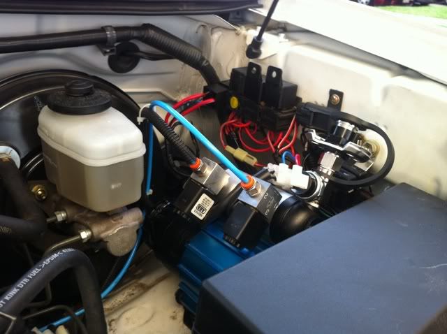

I also got my new ARB high output compressor installed that I bought from brand new off a guy on tacomaworld.com. He bought it new a while back, never opened the box, never installed it. He decided he didn't want it and wanted to free up some cash, so I got it for a few bucks less than retail price.
I had the smaller ARB compressor, but it was only for the lockers, and I wanted to be able to fill up my tires as well. It is so hot here in Dallas, and I was just trying to get it installed as quickly as possible; that I forgot to take some installation pictures. But, it was pretty straight forward, just followed the instructions. Heres a few pictures of it installed. I mounted it in the same place as the old compressor, under the hood on the driver's side behind the battery and fuse box.

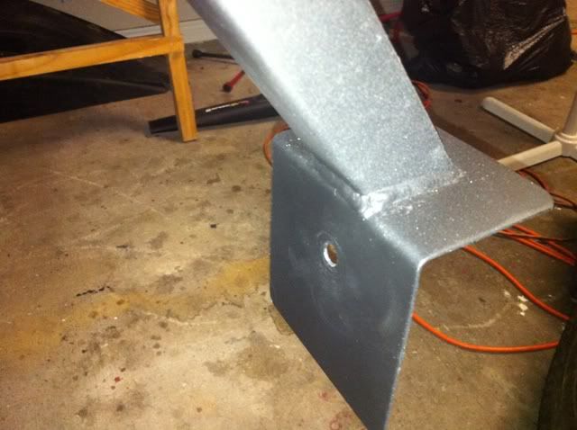

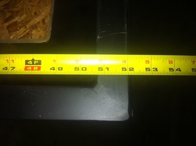

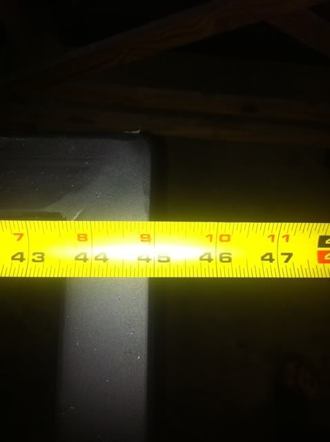

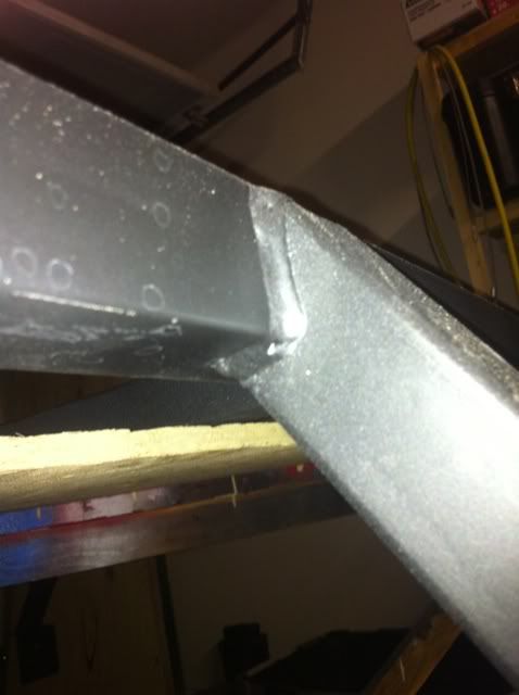

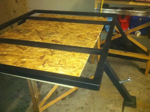

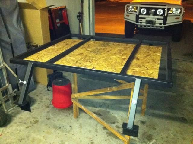

Here is some more pictures for you guys, I wasn't really sure what you wanted to see, so here it is sitting on piece of plywood on a saw horse in my garage.
The rack is 52" long by 45" wide. It is made with 2" square tubing, I think 14 gauge wall. But, the two cross bars in the middle are 1 1/2" tubing, 14 gauge wall, and the RTT clamps onto those; 2" square was just a little too big for the clamps provided with the tent.
The legs are also the same 2" square tubing, about 15" long. The feet (what sits on the bed rails) are 1/8" plate.

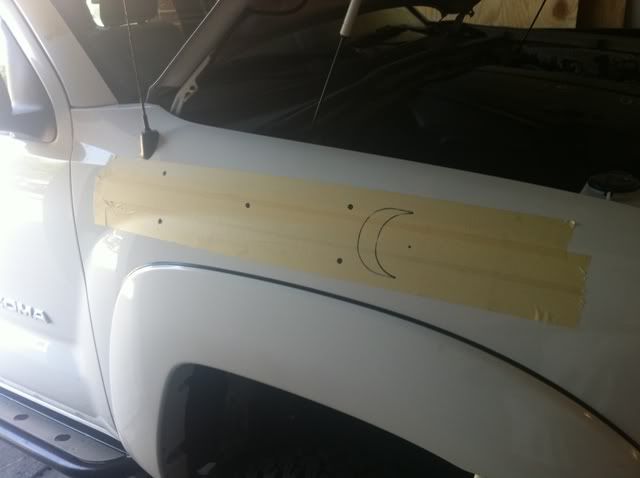

Well I feel like I am moving pretty quickly with this build, it helps that I bought the truck with a lot already done to it.

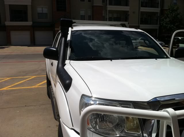

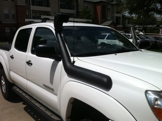

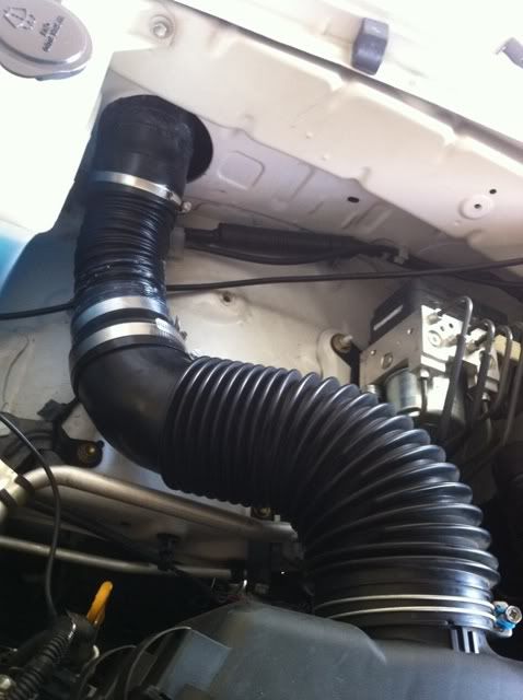

So I cut out a little early this afternoon from work so I could put my snorkel on. Other than it being hotter than hell here in Dallas, it went fairly smooth; I just took my time lining everything up. I won't get into the installation details as TACODOC has already blazed that trail. http://www.cruiseroutfitters.com/tec...o_snorkel.html
But, I did do something a little different for hose fittings; I cut the stock hose off near where it would go into the fender, and then used a small piece of flexible air duct I got at Pep Boys and connected that to the stock air hose, and to the rubber hose that was provided with the snorkel.
I think it will work well this way because I like having the flexible hose for when I have to change the air filter.
