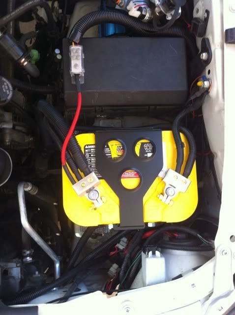

Put in an Optima Yellow Top battery recently; and also cleaned up all the wiring while I was at it. I also picked up a steel optima battery holder off eBay, which works much better than the factory battery hold down, since the Optima is a little smaller than the factory battery.

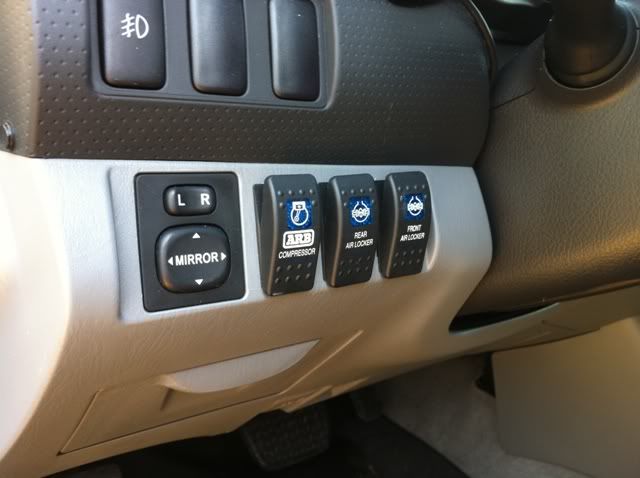

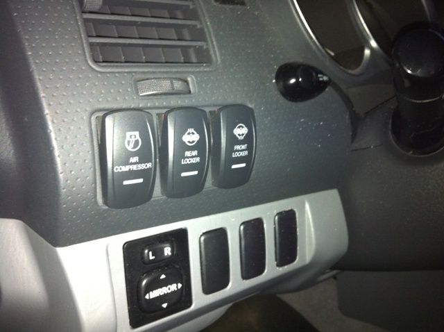

Anyways, I replaced my ARB rocker switch covers with some Contura laser etched switch covers from here; http://otrattw.com/index.php. I think they give it a more factory look, which I like. I also relocated them to the upper switch slots; before I found I was hitting the switches with my knee inadvertently.
Before:
After:

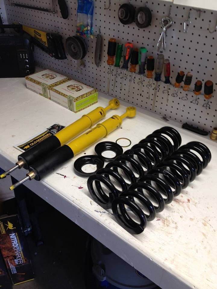

Installed new OME 886 coils and struts a few weekends ago. Had my brother help me and he posted a video on his YouTube channel. I had 886 and OME struts before, but they had about 95,000 miles on them, so it was time. The struts were pretty bad in fact after we got them off. I replaced the rear shocks as well, but we didn't get a video or pictures of that.
The video he posted is a how-to, and for those that dont know how to replace your front coilovers, this is a pretty easy method that doesn't require a spring compressor. Its easy, just be careful. Hope you guys dont mind a shameless plug here, but please check out the videos, and my brothers other videos. He is actually fixing up an old C10 Chevy pickup as a project and is documenting a few how-to videos on YouTube of his progress.
VIDEO PART 1: http://www.youtube.com/watch?v=5E6u7dC7EHg
VIDEO PART 2: http://www.youtube.com/watch?v=jo0FJSi-KYs#t=12

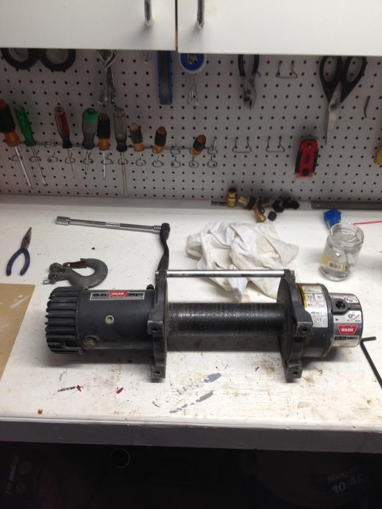

Recently I rebuilt my Warn 9.5XP winch, and replaced the old steel line with Warn's Spydura 3/8"x100' synthetic line. I had my brother give me a hand with all this, and he shot some video of the process and uploaded it to his YouTube channel.
The whole process was pretty straight forward; we just disassembled the winch, cleaned off all the old grease with brake cleaner and paint thinner, then re-packed it with new grease, put on new gaskets, and put it back together.
Along with the new synthetic winch line, I decided to replace the rollers on the fairlead with Daystar rollers, rather than use a hawse fairlead.
Check out the video for the whole process, it was pretty interesting actually seeing how the planetary gears work.
EDIT: I got everything from Amazon.com by the way; the new line, rollers, warn gaskets, and even one of the bolts that I lost that holds the planetary housing on the winch. You can find all the part numbers from the Warn website.
VIDEO HERE: http://www.youtube.com/watch?v=BADjA0t0g8I#t=91

I appreciate the youtube videos! That seems like a great alternative to using sketchy spring compressors or paying a shop $200 to do it! Thanks.
jsmarine
It is a good alternative! Ive used the rental spring compressors before on my old 4runner, and it was very sketchy! I ended up putting on an old football helmet just to finish the job because I was afraid they might bust! This was the first time I used this method, and it was very easy.

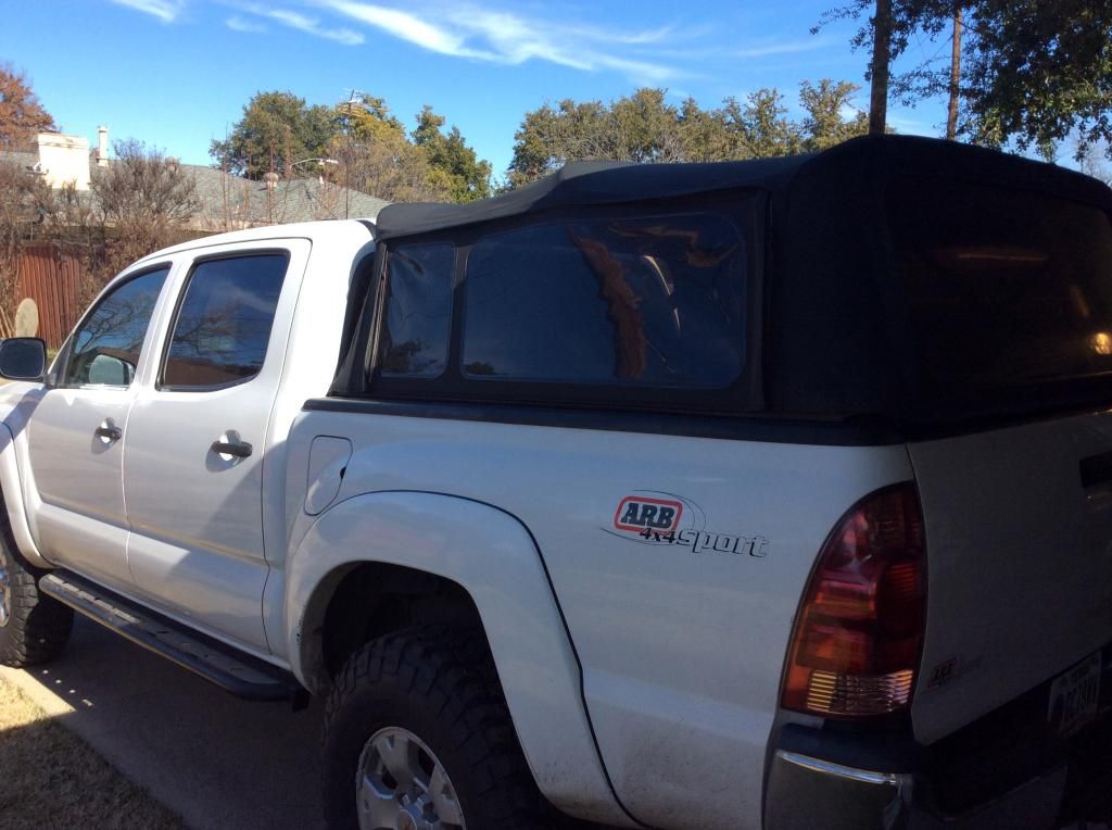

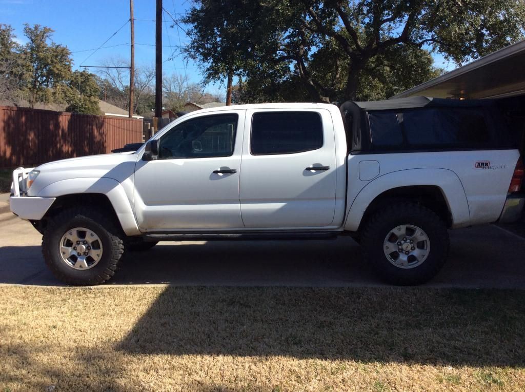

Its been a while since I've updated this, I picked up this Besttop soft top off craigslist about a month ago, its worked out great so far; and I like the look of it too.

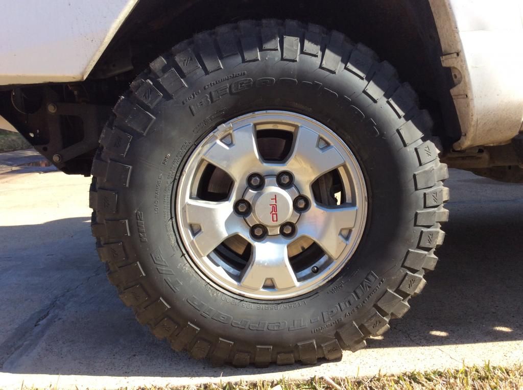

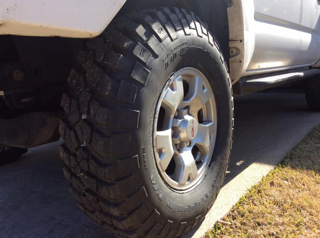

Two weeks ago I bought 5 new BF Goodrich KM2 tires, in 255/85 R16. Love them so far, I have always liked the look of this size.
