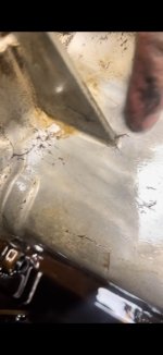

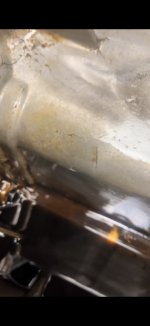

Update on my magical diff fluid filling. Stopped by the shop today to see the results of the mechanic's findings (thanks again, Dan!). It looks like someone cracked the oil pan at some point. There is a large crack in the housing that allowed engine oil to pass through, down onto the axle half shaft and then into the front diff. This somewhat lines up with what I was hearing on the FFRR forum, but this wasn't a worn hole due to misalignment of the axle shaft, it looks like the crack was made when the half shaft was being installed perhaps. Seems like they might not have wanted to take apart the hub assembly and tried to just angle the shaft in but it bound and cracked the housing because the angle was too much. The housing material is made of pot metal so shame on LR for the shoddy metal and the ham fisted prior mechanic for the forced entry.

BL Rover
Replacement Ebay oil pan ordered pretty cheaply, so there's good news there. Since we're in there taking things apart, why not go ahead and do the timing cover seal? Looks like this wasn't done when the donor motor was installed. Getting a new radiator installed as well. The rover developed a leak just before taking it up to the mechanic. Classic. Why do I continue to do this to myself? There are support groups for habits like this, right?

Oil pan is engine out?
Not quite. Oil pan is diff out and diff out is sub frame drop and half shafts removed. Fortunately, we didn't have to pull the engine on this one... unlike the timing chain job just done on my diesel X5. My vehicles are conspiring to drive me into financial ruin lately.
