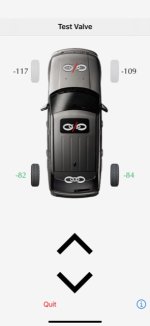

Just in case anyone needs another reason to love the air suspension and their Gap iid tool. We’ve got a fair chance of bad weather coming here in the next few days. Even on oversized tires with a roof rack and a roof top tent she still just barely fits inside.

I was getting a suspension fault telling me I had to stay under 30mph. Quick change of my front height sensors and the fault is gone. Celebrate the simple fixes.
