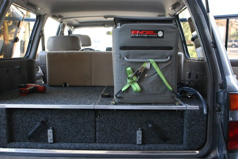

Here's a couple pics with the fridge...
view through the passenger side sliding window
plenty room for a 45...
and the slide is fully functional.

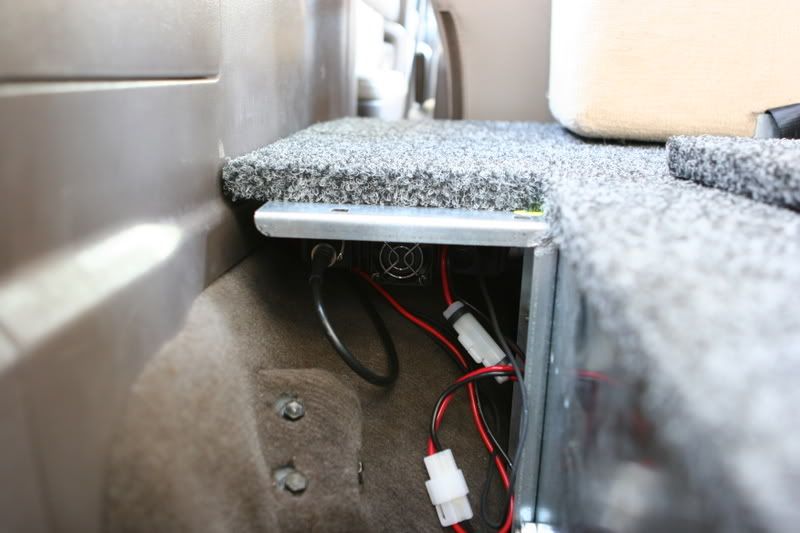

Here's where I put the radio. It's above the driver side rear wheel well. This way it doesn't really take up storage space, has fair amount of room to breath and I don't have to worry about it getting banged up. If heat becomes an issue, or if I just get really paranoid there's a couple places that I can install some computer type fans to aid in cooling. This orientation also allows me fairly easy access to the data plug on the unit to program it via my notebook.

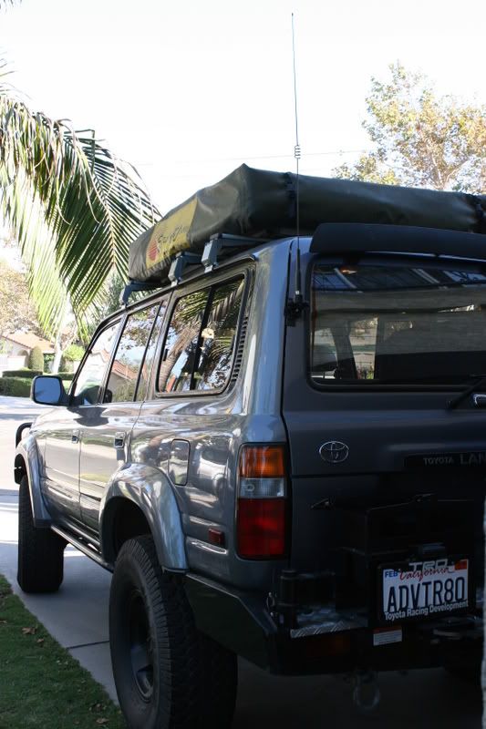

Here's the antenna, imho it works quite well. If I ever get time (a lot of time) I'd still like to drill a gigantic hole in the roof and mount it up top, aft the tent.

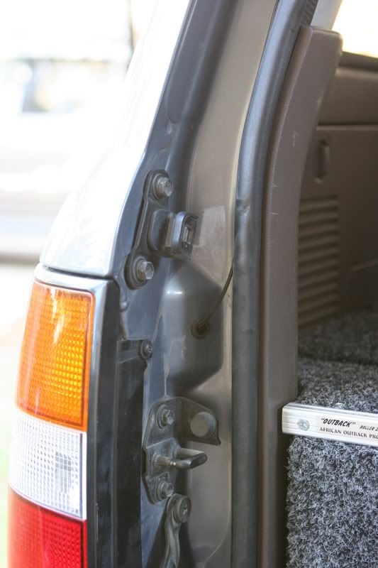

Antenna cable routing...I just need to fill it with some silicone.

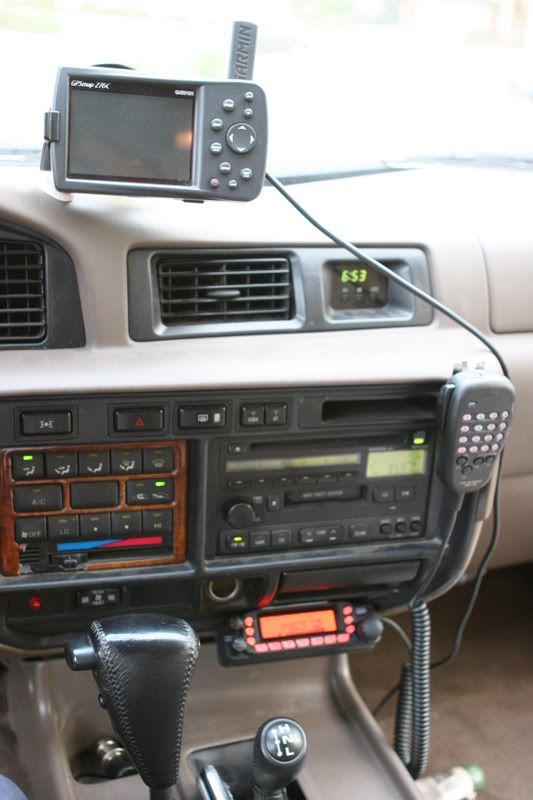

And here's the faceplace/mic mount. My goal with the interior is no wires and oem appearance (yes the gps wire is going bye bye too). The most functional location without it being in direct sunlight was here. It's within arms reach, the mic cable is not hanging in front of something and the lcd display is clearly ledgible from the drivers perspective. I'll have to snap a better photo :oops:

My initial faceplate location was in front of the sunroof controls but that was too close for comfort...
i was looking at that as well but you're right is was a little far back
and there's no easy way to angle it towards the driver side...

The only thing I'm wondering is if the mic cable will interfere with the mirror at all.
after sitting in the 80 again, I don't think this will be a problem.
