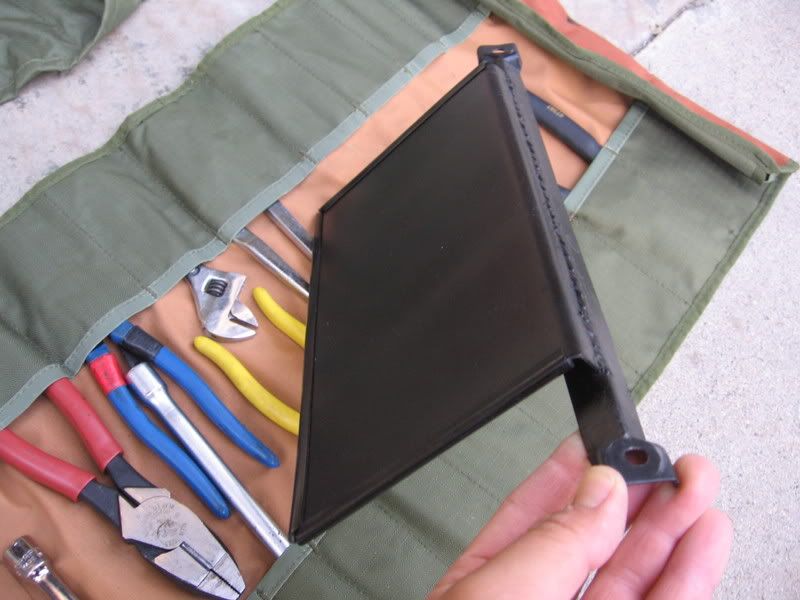

I had a friend weld a mounting plate to the oem hold down for the perfectswitch. I lined the edges of the plate with self adhering door molding to prevent any chaeffing or cutting myself.

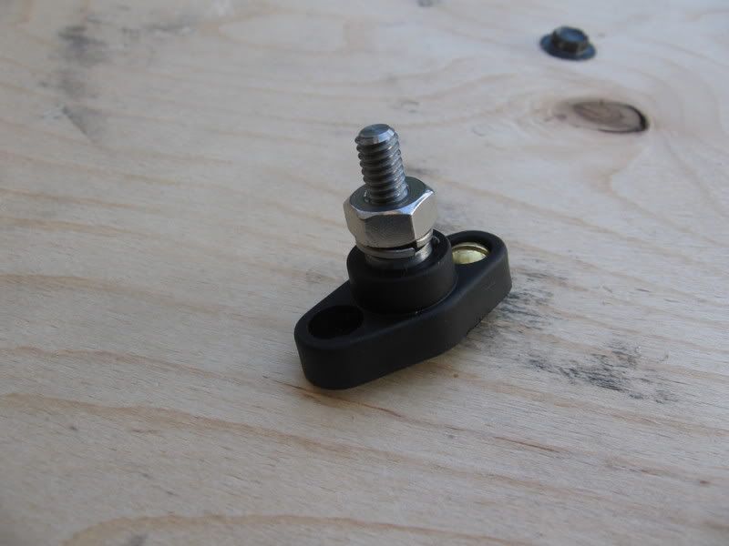

Now that the aux battery has it's positive and negative I moved on to the main side. I started by mounting this 1/4" stud to clean up some of the connections to the main battery. This isolator is installed inbetween the alternator and the main. So I took the cable off of the alternator, landed it on the 1/4" stud and ran a new wire (4ga) from the alternator to the isolator. On this 1/4" connection I landed a 2ga from the main battery positive, the existing cable to the starter, the factory cable that was on the alternator and a couple other oem wires.

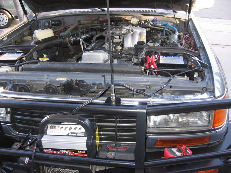

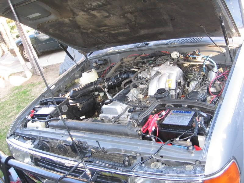

With the isolator mounted I completed the last bit of 2/0, from the isolator to the main, and finished off some of the smaller wires. I double/triple checked all of my connections prior to landing them to make sure I didn't fry anything. Per the instructions I hooked everything up and this is the result...
aux battery...
The aux battery sat for a couple months so I hooked them up to a battery charger...ignore the loom of wires on the drivers side:oops: That was left from the previous owner. I chose not to deal with it until the aux battery was in.
Now I just need to strategically place a few fuse blocks and clean up the existing wiring. Once that's done I can start adding all the other stuff in the garage like the aux fuel tank, water pump, lights, etc...
