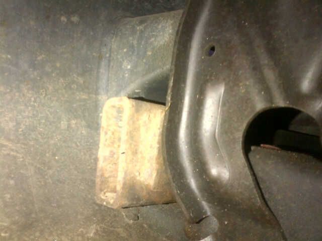

I finally managed to get the other busted fog light off the driver front of the truck (metal cut-off wheel).
The stock mounts were rusted and now cut in half, so I have been thinking for quite awhile on what I was going to do. I had thought about drilling and mounting into the plastic bumper cover itself, but after picking up the rigid lights they are heavier than I had realized, and I don't want them bouncing around while I am driving.
While I was underneath the truck, I saw that there is a support between the bumper cover and the rad, this runs perpendicular to the front the of the truck, its steel, and already has a pre-drilled hole at the exactly middle height of the fog openings.

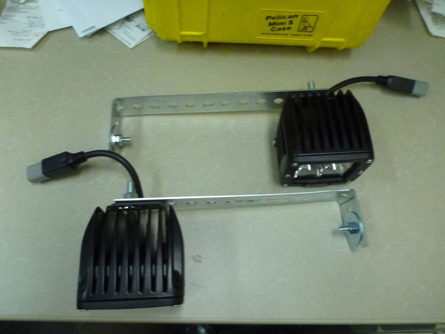

I went to home depot, and got some bar stock with pre-drilled holes. Cut to the right length and bent in a vise (hi tech!). The mounting bolts that come with the rigids are the petfect match for the holes in the bar. I used large washers where it will mount to the truck because the hole there is smaller than on the rigid.
Here is a picture of where they will be mounted to.
Kolpin is the name of the company that re-branded the rigids, but as you can see other than the faceplate they are identical, even the wiring harness says rigid on it.
Brackets, dont mind my messy desk!
They feel really solid, I am hoping they are strong enough to keep the lights still when on a bumpy road, its a bout a 9" reach from mount to light
