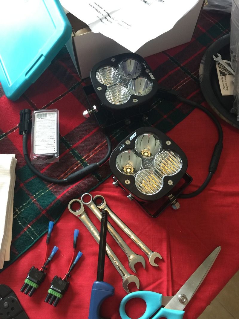

Santa just dropped these off last night. Baja Designs XL80 4" pods...
Installed them this morning. All the hardware and brackets are stainless and the wiring harness uses waterproof connectors. Really nice stuff! These replaced some 8" KC halogen spotlights. I can tell they are way brighter even though it's daytime, I asked my wife to look out the window and turned them on she is still seeing spots 5 mins later. Not a wise move on my part, lol.
Will have to wait until tonight to aim them properly and get the full impact, but really happy so far!

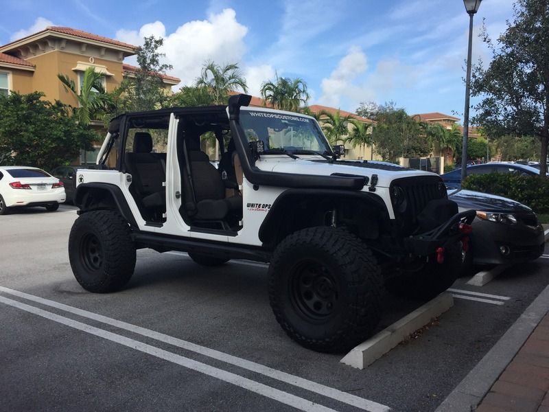

Yes, Boynton Beach Florida! Still waiting for it to get dark to aim and fully evaluate but check out this daytime picture taken with cell phone. That's JW Speaker LED headlight high beams, JW Speaker LED Fogs, and new XL80's all turned on. The XL's completely shame the high beams, lol

And finally here's some pics!
Scene 1 is a 2 lane road with a stop sign where the road terminates at a main road about 1/8th mile ahead. This is with JW Speaker Headlights (lowbeam) and Fog Lights:
Scene 1 now add XL 80's:
Scene 2 is a wharehouse area with a chain link fence about 75 meters ahead. This is shown with JW Speaker Headlights (lowbeam) and Fog Lights:
Scene 2 now add XL 80's:
Scene 3 is a 2 lane road which ends into a parking lot and signs about 1/4 mile up the road. Shown with JW Speaker Headlights (lowbeam) and Fog Lights:
Scene 3 now add XL 80's:
In conclusion... I can't imagine anyone not doing the Baja 1000 would possibly need more light than what a pair of these XL80's put out. I'm also thrilled with the color temperature it matches my headlights perfectly and is pleasing to the eye (not blue at all).
