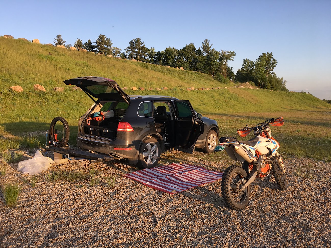

I recently picked up a VW Touareg TDI as a "goldilocks" vehicle (fast and fun to drive, great fuel mileage, great in snow and soft-road, huge towing capacity, etc.), and wanted to make it more practical for camping trips, but also still work as a DD.
For the trunk, I built a frame out of a steel pallet that my lawnmower came on, then mounted birch ply with carpet over top. I opted against slide-style drawers so I can swap out plastic tote bins with camping equipment quickly and easily. With the rear seats down, I can install a removable platform that mounts flush to the trunk frame (the rear seat backs are at an angle when folded, making it an awkward space to use). The full platform is ~68" long, so at 6'3" I have to sleep at a diagonal. Great for solo camping, but I'll definitely bring a tent as well.
