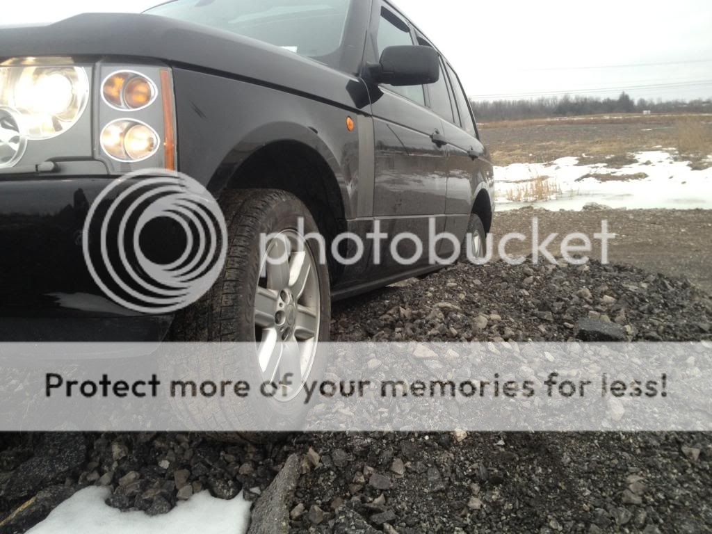

I'm interested in the build-up because I've always liked the Range Rover style and concept most of any Rover. I've been playing with the idea of getting a newer Rover this year and am leaning towards the L322. Similar prices to the LR3 too. I know the LR3 has some advantages, but to my knowledge, they don't seem to be that great over the L322. I have read on some the the UK and Aussie forums that the earlier L322's, 03-05 are better off road than the later ones, which have moved even further towards street use. . .
