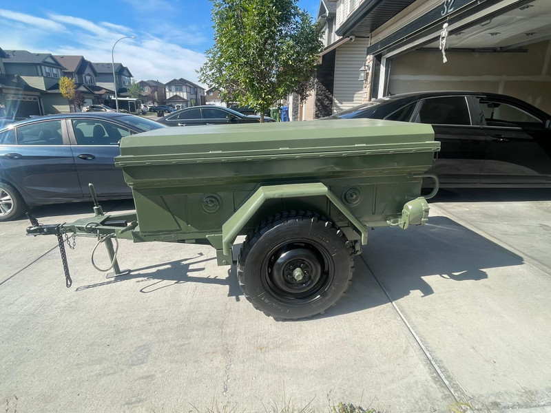

They really are great starter kits for a camper. Kind of heavy. 900 lbs? I forget the weight, but it’s not insignificant. A 3/4 ton or a M1101/1102 trailer would be just fine.
Securing it in a truck, or the 1101 is a bit tricky, but certainly not too difficult.
Good luck! Send me a PM if you have questions. I don’t check here very often. Just stumbled across your thread.
Also, post pics. Very few documented S250 builds online. Not sure why. It’s an easy enough project and they aren’t too expensive ($800-$1500 in 2023 dollars).
For what it’s worth, I can’t recommend the M1101 highly enough. That is the most bass azz trailer ever built. Has surge brakes, it’s wide, indestructible and not too heavy. The construction is amazing. Proprietary rivets that will not wear out, aluminum body and galvanized frame. And the 250 is designed for this trailer.

Copy that. I found a 2010 in Oregon for $1950, so thats not too far and on the more affordable end. I will see if I can get my hands on that one. Wasn't budgeting for a trailer...
