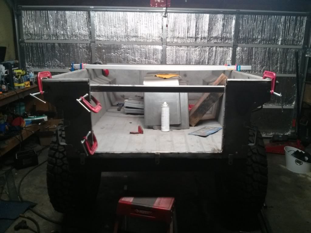

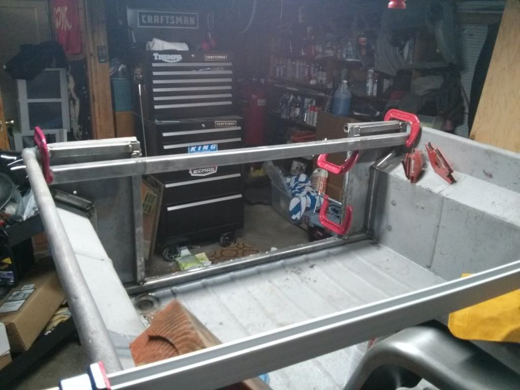

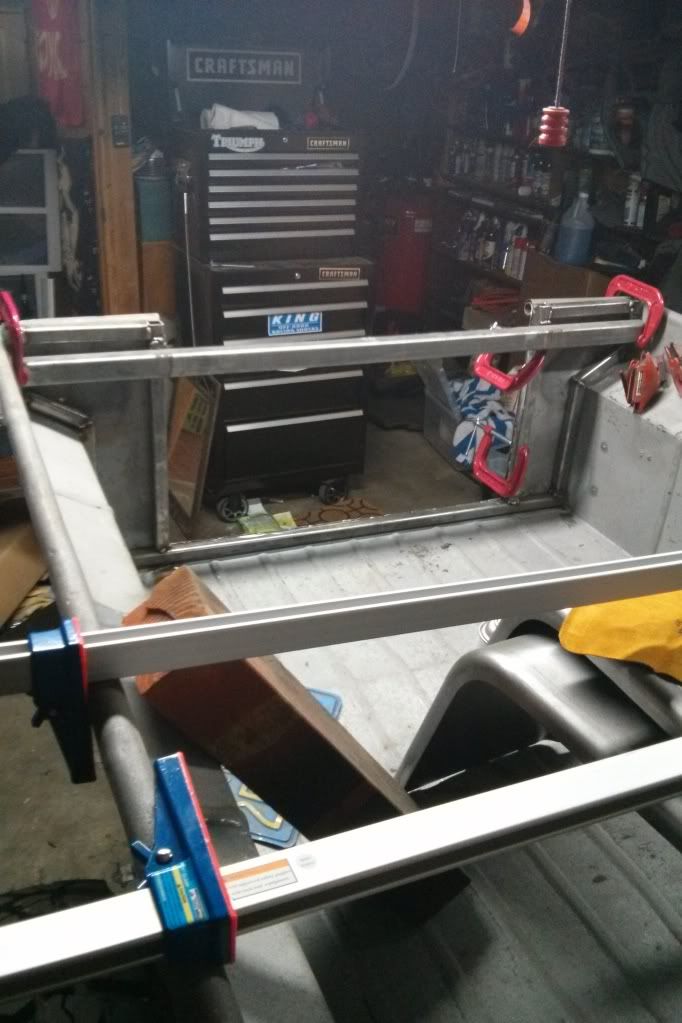

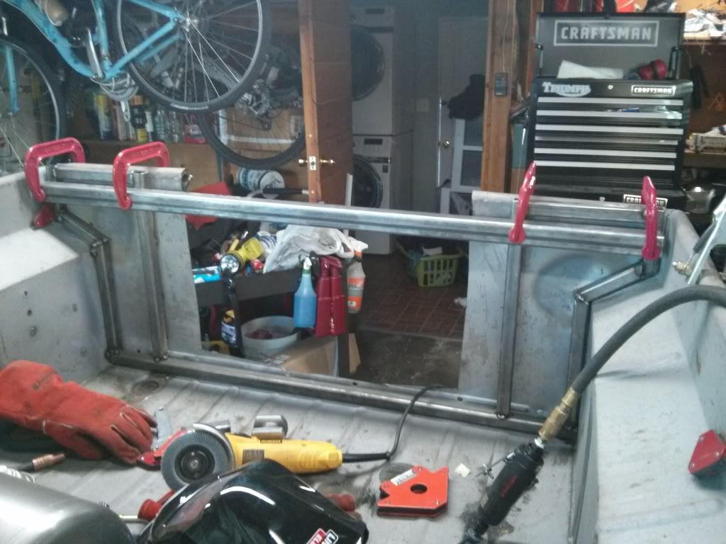

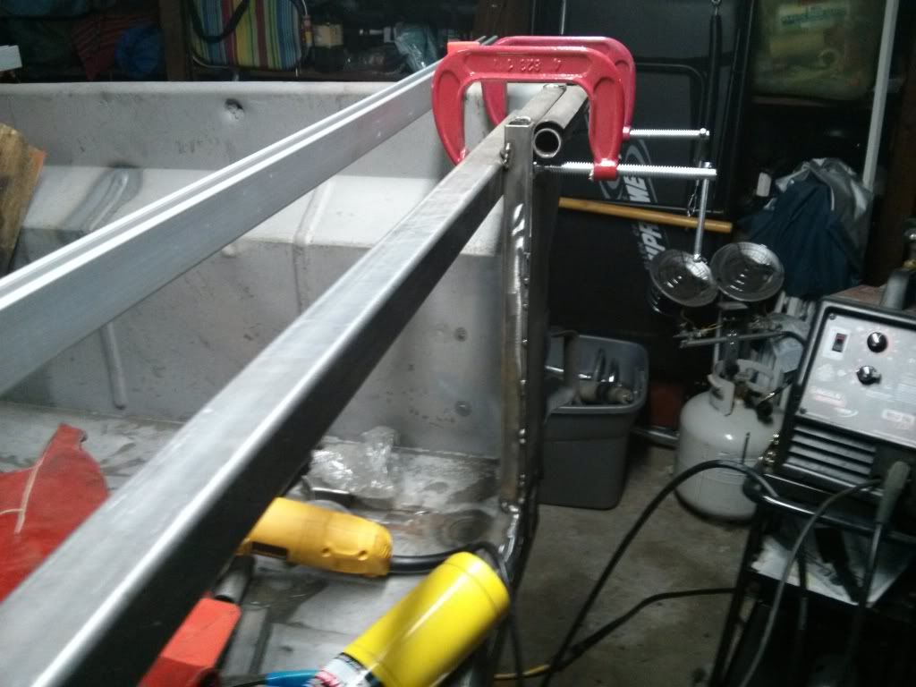

Today I covered a lot of ground with my trailer Now that my 4runner is getting some Fab work down at a buddys shop I didn't have that as a distraction.
I did some dent removal and then I just couldn't help but start on my tailgate mod. Everything is just tacked now and I still want to add a few more braces inside the structure to stiffen up the tailgate before final welding. I made the sides wide enough to house the oval brake lights in the upper corners.
Overall I had a lot of fun and glad that I finally started on it. I'm waiting on my c channel from my local metal shop to clean up the top lip.

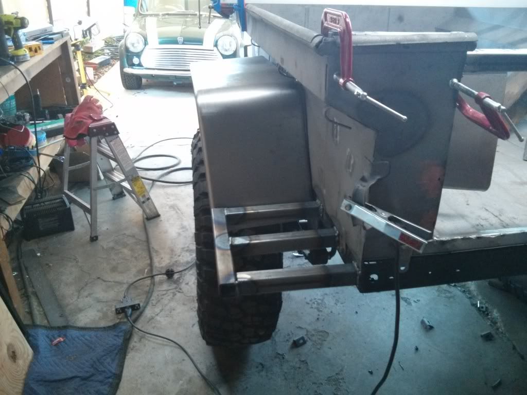

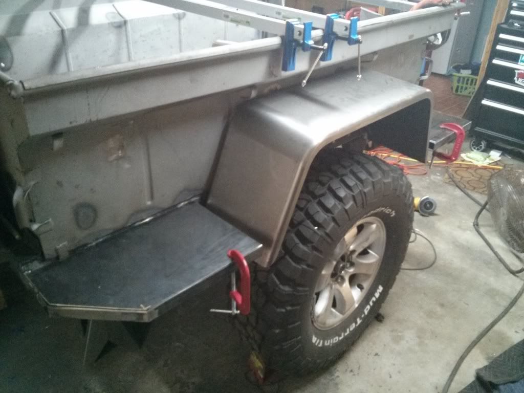

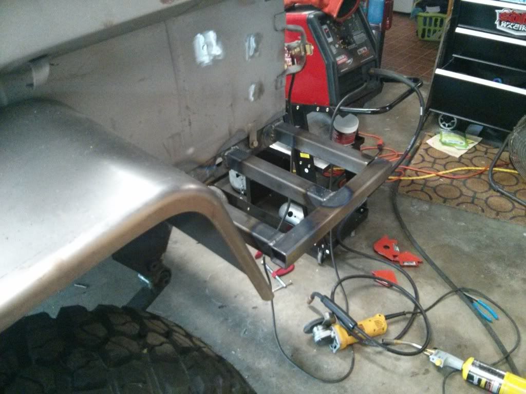

today i took the day off and spent most of it in the garage working on my nerf bars. i was able to knock out one side completely and ill continue on the other side and the top rail tomorrow. it was a ver fulfilling day and im very satisfied how they turned out
TheJosh
For nerf bars and fenders my original plan was too connect them but when I visiting sierra 4x4 to pick up my lid I saw a design with the same fenders and round tube Nerf bars and they weren't connected and it looked awesome so I decided to go that route. So instead of it looking like some long fenders there will be a small gap in the front and back and it seperates them and kinda shows them off as more of "slider steps" I still have some grinding to do but they are coming along great. I finished the other side today and started plating the driver side top.
