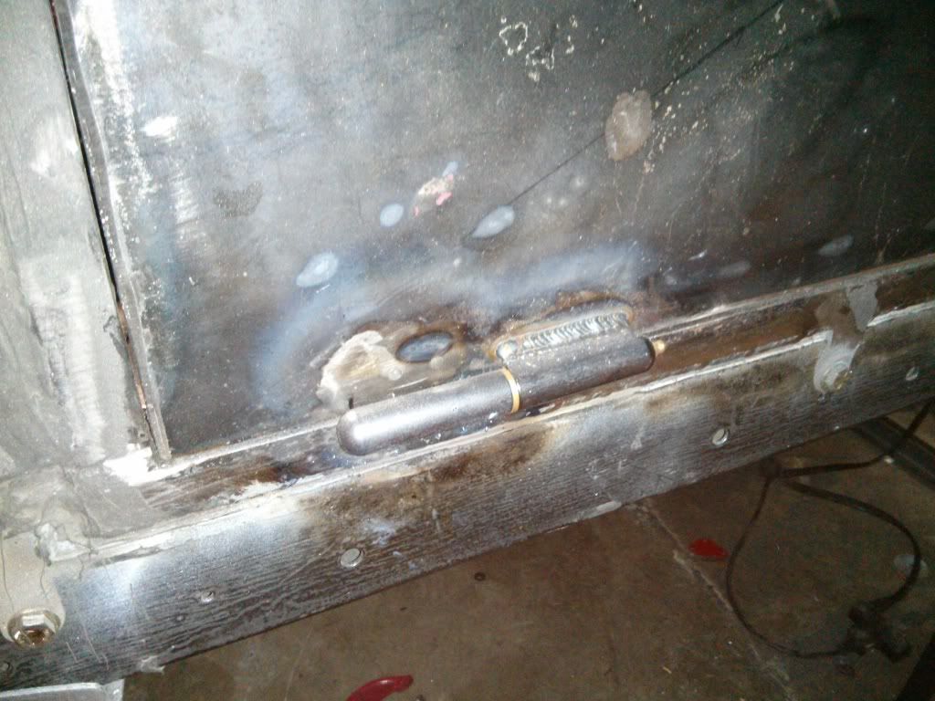

On my round of errands this morning I had to go To my local welding supply and I was looking at the barrel hinges again and I decided to go with the bigger 6" ones. I think they will be easier to work with and to get right. So I will cut off the smaller one grind it down and do them over.

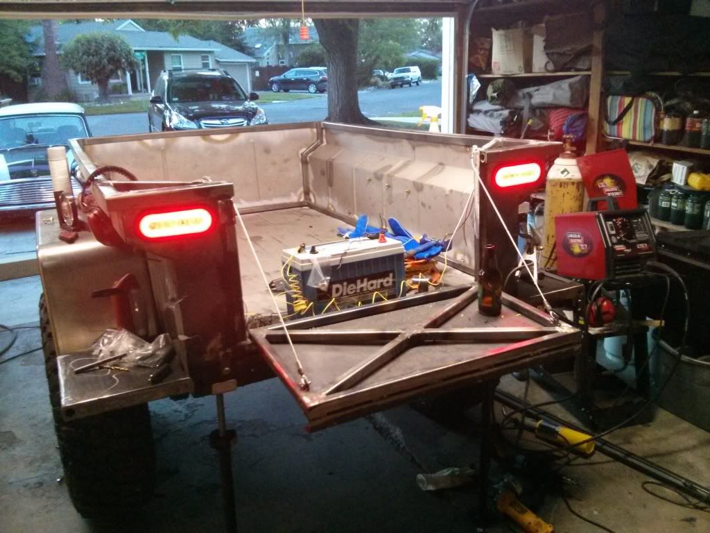

Today I installed my Tron taillights and cut out all the holes for the marking lights that are going on the Nerf bars which I forgot to snap pictures of

I grinded off the smaller bullet hinges and welded on the larger 6" bullet hinges. These were a lot easier to work with and look so much better.

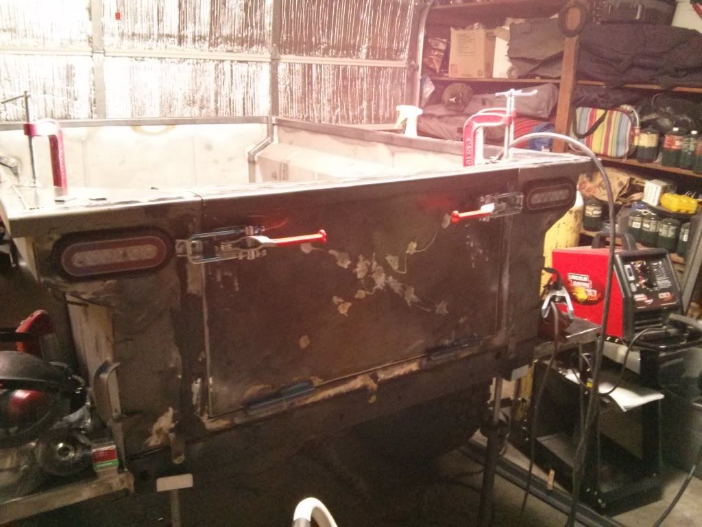

Then I plated the top corners and installed the powertec latches that's I picked up from amazon. Came out really cleans very heavy duty. Right now I'm just about done with all the welding I have to do to the trailer just some clean up work. I have been thinking about adding a rear hitch to the trailer that will pass thru the rear crossmenber and I'll build I string crossmenber under the tub for it to mount into. Not sure what I will use it for at the moment but I think it'll be a good idea.
Any who here is a few pics

For the lock I decided to do a latch on the inside of the tailgate. I kept going back and forth how to find a good looking latch and it was driving me crazy. Then I just came to the conclusion that if I just do I weld on latch inside the tailgate I won't have to worry about a lock and it will be cleaner. So if I am on the trail all day or camping I can leave it open and if we are on the road or its parked on public streets I can just close the latch on the inside and it will be all secure

True about not being able to visually confirm but I think the clean look with no padlocks with outweigh that. I finished up just now installed the interior latch and I really like how it came out

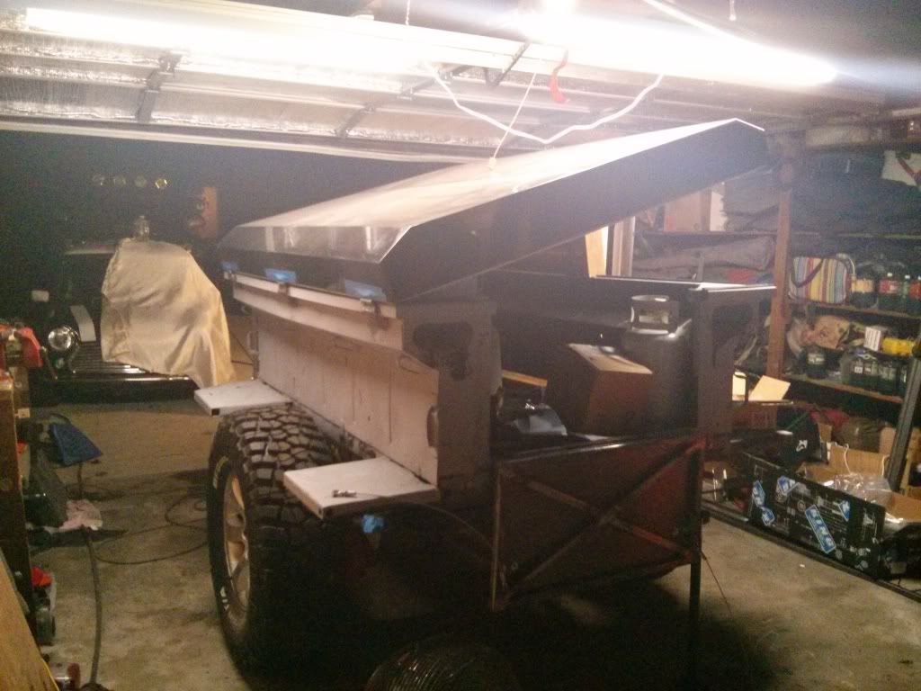

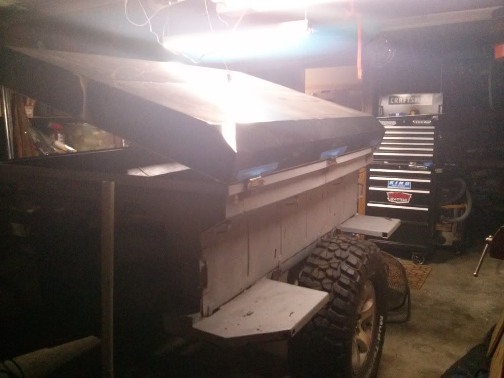

Been busy with a few other things lately but I had some time today to finally do the hinges. I cut off a few 3"x1" pieces of 3/8" stock to do a spacer under the hinges so they line up and open properly.
Worked as planned and the lid opens and closes smoothly. Tomorrow I hope to have some time to put the struts on.
Here is a couple pics
