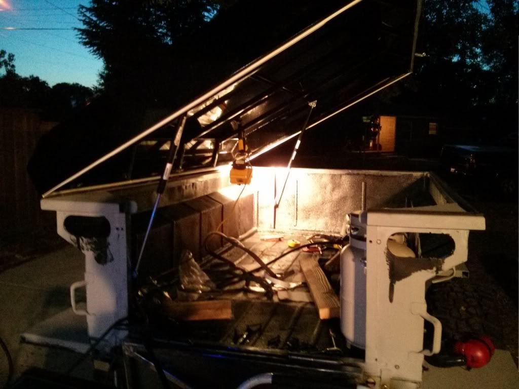

Not yet I haven't, any suggestions? Like is the any type of formula needed and how tall should I make the lid open?
No formula. Just prop it open as far as you like it. For me, it was as high as I could comfortably reach.
The people I bought my shocks from said to be sure to attach it as close to the middle of the lid as possible. So, just prop it open and from there, you can figure out where to attach it to the trailer.
If you have visited my thread lately, you probably saw how I mounted mine. I ended up mounting the front one on the outside and the rear one on the crossbar, which you don't have. I'll be interested to see where you mount your rear shock.
TheJosh
Thanks for the input.
I added a vertical support towards the front of the trailer so I can have the struts equal measurements between the front and back. I just need to add a 1/2" spacer on the top to clear the tailgate when its closed. Other than that it turned out great
Now for the tailgate... The tub seemed to have shifted when I tried to remove it a few weeks ago and now its a once again a very tight fit so I must ground down the sides again to clearance for the tailgate.... No fun!

Thats looking GREAT! What are the specs for the gas shocks?
It looks like the way I want to mount mine, from the hinge side. I would have to get them closer to the corner as my tailgate opening is bigger.

Thank you! The shocks are 125lbs each. Hopefully they will be enough with the tent on but I have a feeling they will, very strong

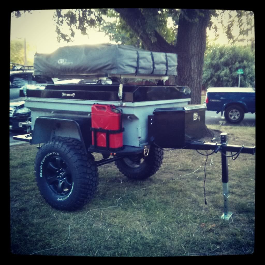

So today I made the tailgate snug once again and capped the open ends on the tub side. Also for the rear strut interfered with the tailgate when closed to I welded a little box on the inside of the trailer lid and welded to ball end for the strut not it clears just fine.
Before all that I tackeled the front drop jack mount. Which should have been easy but the quick disconnect pieces didn't fully fit over eachother once the stationary piece was welded on the trailer. So I had to use the chop saw to cut off a 1/4' in the jack mount which took some time because it was 1/4" steel.
Any who here is a few more pics.
The trailer is primered and spray painted temporarily just to protect against rust once I start testing it. Plan on taking it to pismo for 4 days to do a shakedown and when I come back fix anything that needs attention before final paint

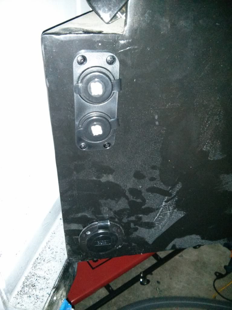

I worked on my wiring a bit today and drill out holes in the tongue box for wire routing. All I have left to do tomorrow if pick up a fuse block at west marine and run wire for all my lights and wires up the 12v outlets

Well the shocks are not enough to support the lid and the RTT. Now I need to find some before next weekends trip. Anyone have any suggestions?
