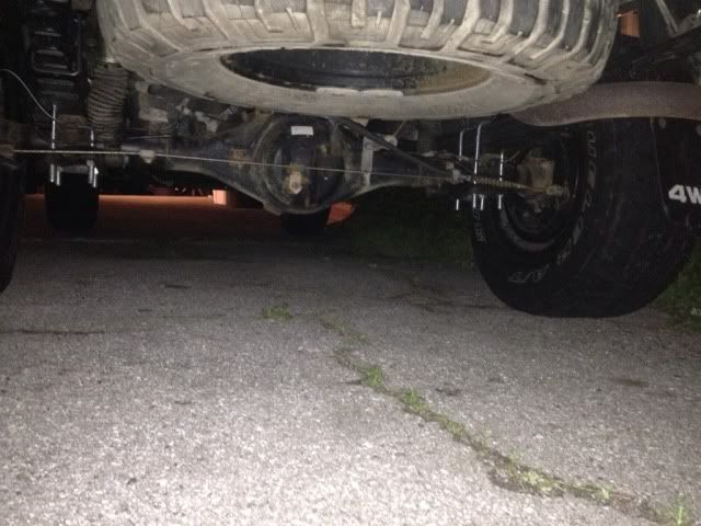

Hey Nick,
I read your deavers install. I noticed your e brake cable is above the leaf pack, while my is under the leaf pack.
Yours:
http://i51.photobucket.com/albums/f374/nicwillman/Suspension/DSC01942.jpg
My:
Willman
Hey Nick,
Yours:
My:
Working on my dual battery set up now, it will be good to compare the two when done. Nice looking Taco.
Mike
I believe newer tacos are wired like that.....I like yours better....Mine is barely off the leaf....

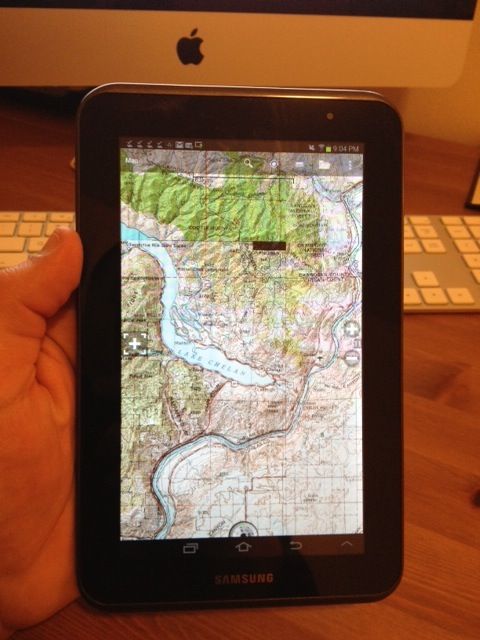

Tablets are getting cheaper....I have been kicking this rock down the road for years.....I wanted a laptop but too big and my wife would hate it over time in her lap.....
I'm a apple guy...BUT...after some research found a better alt. to the ipad...The Samsung Galaxy 2 7". (reason - Cost!)
So....Here we go.....
Tablet GPS:
Unit - $189 (costco Samsung 7" tablet - Built in GPS)
http://www.samsung.com/global/microsite/galaxytab2/7.0/index.html?type=find
32gb card - $30 (extra memory - Useless without)(Waiting for the ExFed man to bring..)
http://www.bhphotovideo.com/c/produ...dqui_032g_a11_32GB_microSDHC_Memory_Card.html
Mount - $100 (proclip)(have not pulled the trigger on this yet...soon)
http://www.proclipusa.com/brodit-ve...5-2004/proclip-center-mount-852253-13283.aspx http://www.proclipusa.com/brodit-de...00)/holder-with-tilt-swivel-511381-18977.aspx
Back country Navigator - $10
See Google play app. store
Total - $329
Not bad for a 7" GPS.....Plus i can watch movies too.....(not while driving of course....Or maybe....)
Waiting for the mount to fully test this thing. The only bad thing is that it doesn't like apple products....which is all i own....but i keep my phone in the truck to play music etc....

TacoDell
I prefer the earlier design as it's less likely to get snagged while off road.
Yes... I've seen that occur
I read a thread somewhere, where someone made extensions to the upper portion of the lever(s) at the hubs.
and this raised the cable higher, allowing clearance for a 10 lf cust. spring pak.
Courtesy of Hytenor (Chris) @ TTORA
I have cust. deaver 9lf paks... and it clears... just barely.
I did bend the guides upward just a hair and that helped for a quick fix.
Probably increase wear of the nylon inserts... but that's life
* for those with the lower e cable assembly...
I believe the axle's backing plates can be rotated to bring the cable back to the top...
tho' I don't know what else needs be done concerning the cable mounts on the axle housing.
