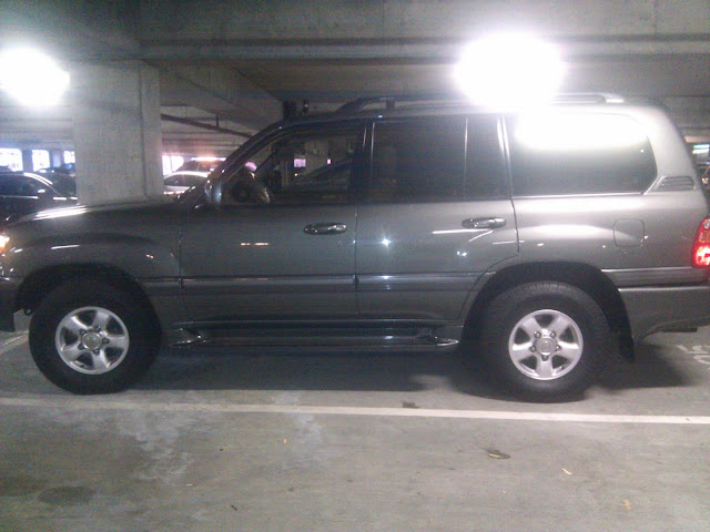

After searching around for a while I finally found what I was looking for. A 2002 UZJ100 with 82K on the clock. It had been owned by a doctor and had been garaged full-time both at home and work. Here is my 02 Land cruiser as she sat the day I got her (please excuse the terrible quality of the photos):
Note: I removed the gold pin striping on the drive home!

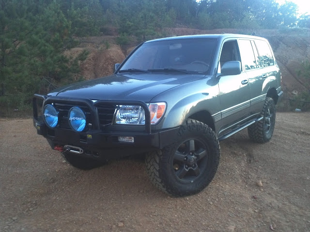

And here is the latest incarnation of the build:
I have done a fairly good job at documenting progress along the way so if anyone is interested, I could show the build at different stages while describing anything notable during the modifications.

Mods to date include:
  • Remove running boards
  • Remove gold pin striping
  • De-bling (remove gold emblems and replace with chrome. Plasti-Dip emblems in black)
  • Remove vibration dampener
  • Remove bug/sunroof wind deflector
  • 03-07 Land cruiser 18" wheels (painted in Duplicolor Mazda graphite)
  • 295/70/18 Nitto Trail Grapplers
  • 1.25" front wheel spacers (Just Differentials)
  • McMaster-Carr SS smooth band w/ rolled edge CV boot clamps
  • TJM T-15 (steel) front bumper (sourced from ih8mud member in OZ)
  • White Knuckle Offroad DOM sliders w/ kickout
  • Slee single swing-out rear bumper
  • Hi-Lift Extreme 60" trail jack
  • Titan TW12 12,000 lb 6.6 hp winch w/ wireless - 3/8" Dyneema (Amsteel Blue) synthetic line
  • Viking safety thimble/rock guard
  • Slee fairlead aluminum hauze for synthetic line
  • 4.88 Nitro gears (Just Differentials)
  • ARB front and rear air lockers
  • ARB high capacity on-board air compressor
  • OME (Old Man Emu) 303001 torsion bars
  • OME 863 rear springs 3" lift @ 300-500 lbs.
  • Slee differential drop
  • Carl's UCAs (Just differentials)
  • King 2.5 shocks w/ remote reservoirs
  • Fog light switch mod
  • Slee dual battery tray
  • SpressoFAB 80/100 series frame recovery brackets
  • Yakima rail grabs w/ 50' cross bars and boatloader
  • Lightforce Blitz 240 modded to 100W HID w/ blue combo filters
  • 55W 5000K DDM HID low beams
  • Philips HIR 9011 high beams
  • 5W Q5 CREE high power LED reverse bulbs in OEM sockets
  • Full LED interior (11 OEM locations)
  • 500W power inverter
  • Catch-All Xtreme front floor mats
  • Catch-All middle row floor mat
  • WeatherTech Digital Fit cargo liner
  • Window tint
  • Mobile 1 synthetics all around
  • Mobil 1 M1-209 oil filter (60% greater capacity that OEM)
  • TJM AirTec snorkel
  • Timbren front and rear bump stops
  • DT stainless steel headers
  • Front Runner Slimline 2.2m roof rack
  • 50" LED light bar
  • 2" LED work/backup light (mounted on Slee rear bumper)

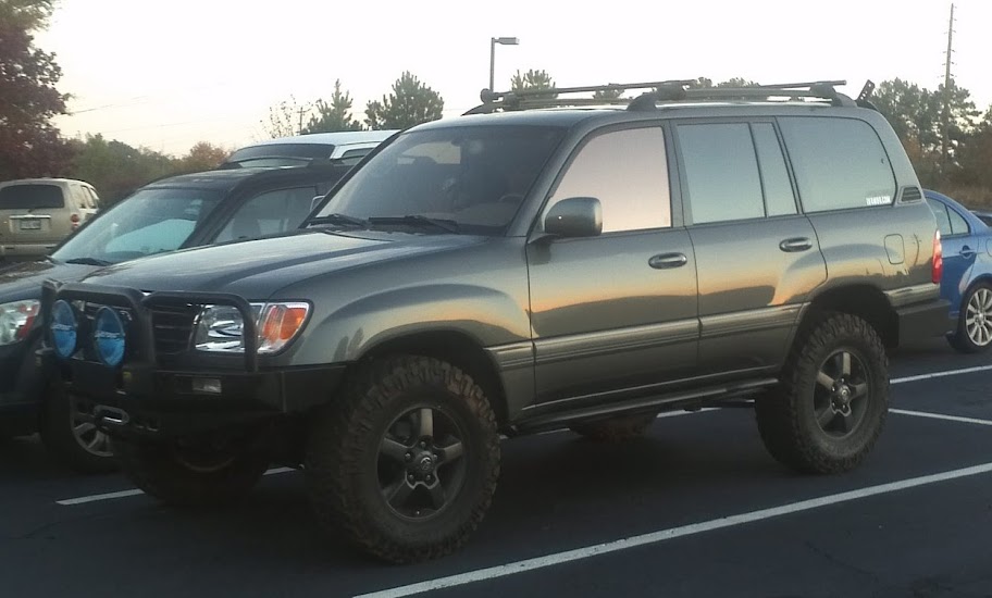

As for the Cruiser, The only thing I have done lately is install a 20 inch LED light bar. Here are the latest pics from my last outing with 2000UZJ and YetiInGA:
