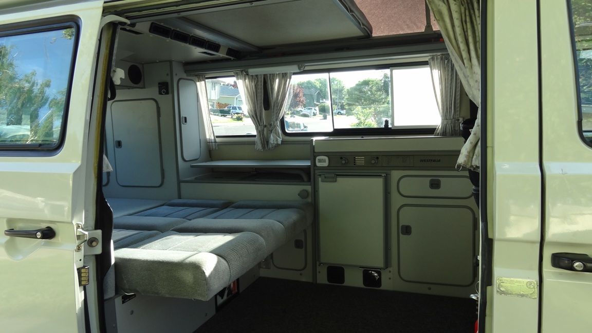

New to the site. Thought I'd post up a few pics of my Subaru powered Syncro Westy. Finished the build a while back and have been enjoying it since. Looking forward to posting more on the site in the future. I've listed some highlights of the build below.
1990 Syncro Westy
54K original miles
*2" lift springs with Fox Shocks
*2006 Subaru Legacy 2.5L Drive by Wire
*Propex 2800 Heater
*Upgraded fridge (Truckfridge)
*Rear cabinet door mod
*Undercarriage completely gone through. New seals, bearings, powdercoating etc.
*Dual Batt Banks
*Custom electrical Sub Panel
*330W solar system on roof
*RMW Bumpers, swing carriers and engine conversion kit
*Euro headlights/grill
*Dual awnings with custom mounts
*16" Wheels
Here's a link to my original build thread, lots of detailed build info here: http://www.advrider.com/forums/showthread.php?t=802924
