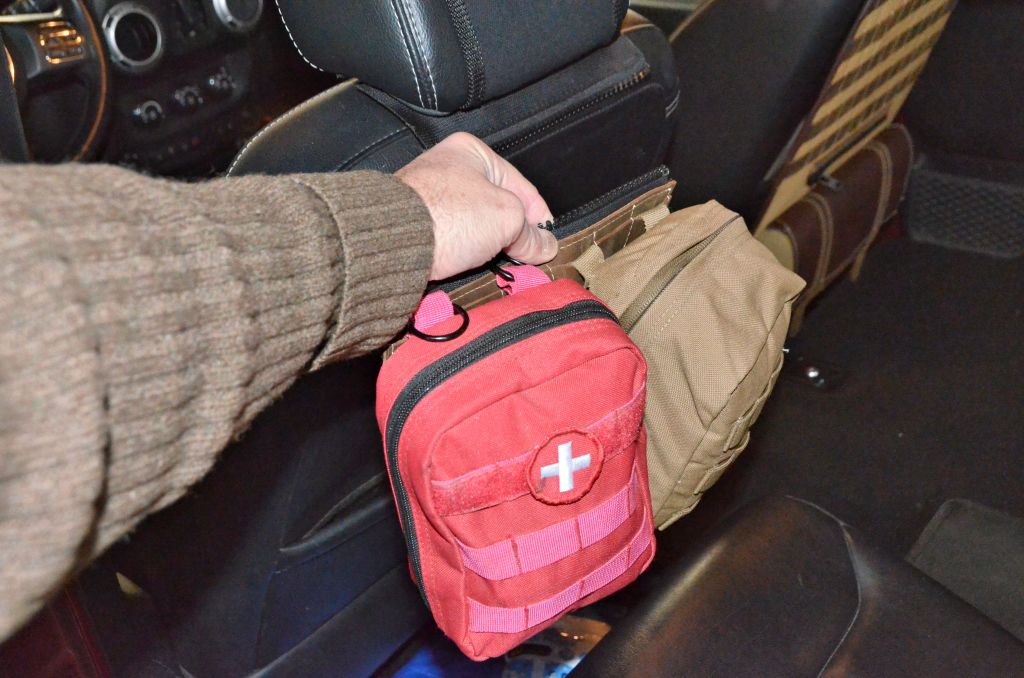

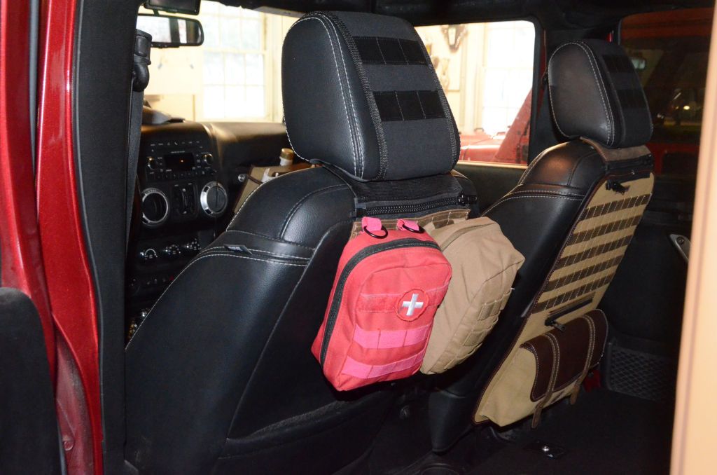

Overland Outfitters has several products that attach to the seat back using a zipper that hangs from the headrest posts. It's a handy place to hang bags; I carry their Zip & Go bags on my seats often.
Recently I wanted to hang some Molle bags there so I sewed a quick Zip & Go/Molle adapter.
One benefit of hanging Molle bags with zippers is that they can be removed very quickly - no messing around unthreading the Molle straps on the back, just unzip them,

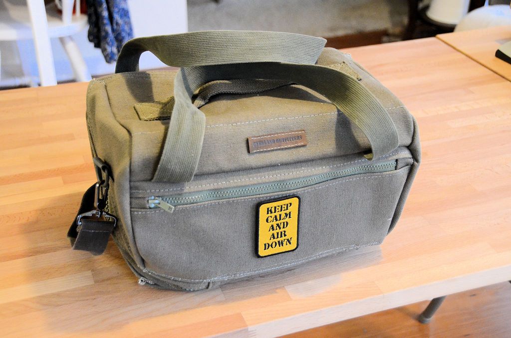

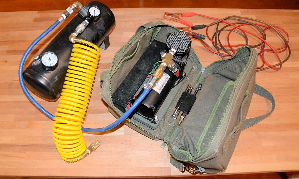

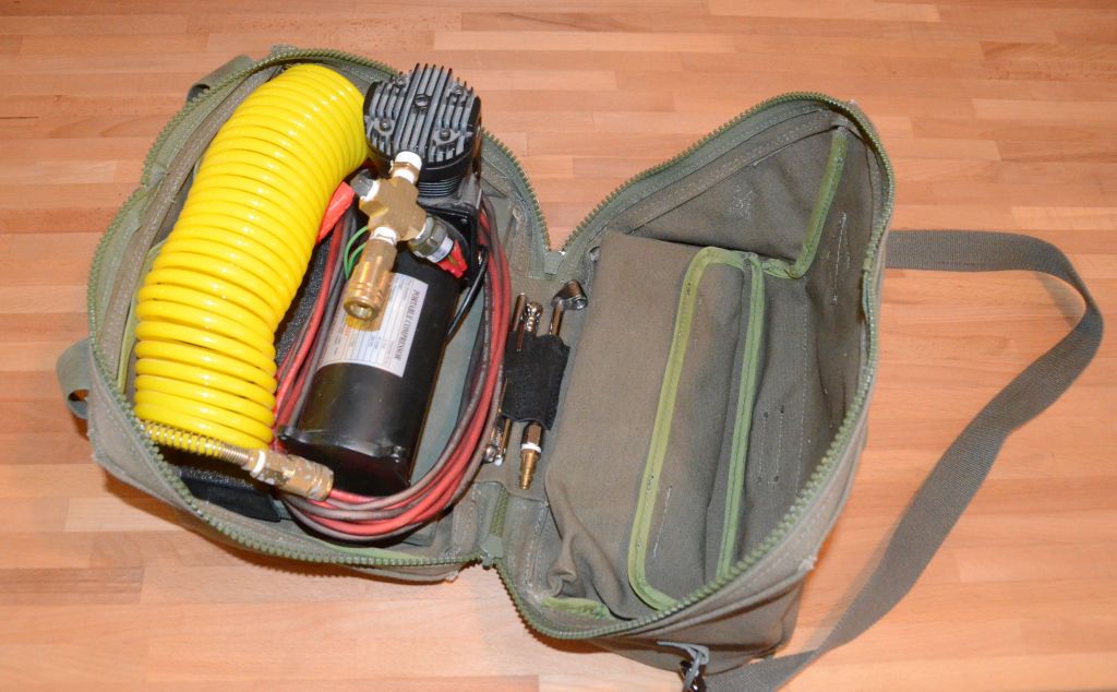

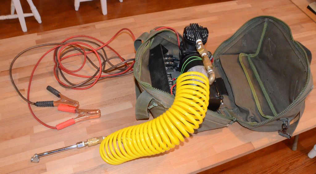

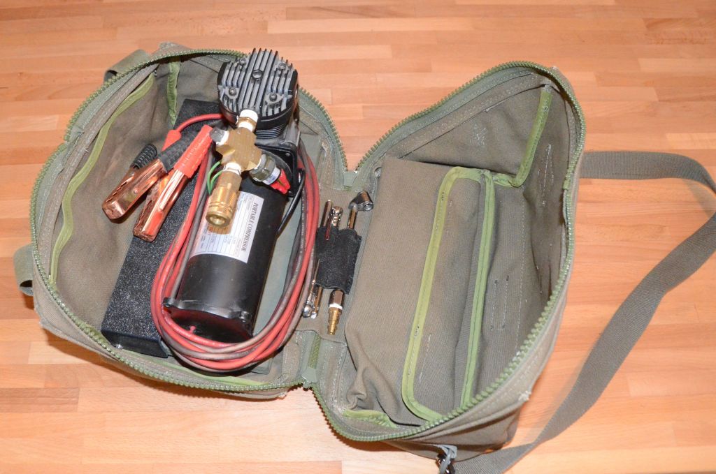

I finished sewing the prototype compressor bag:

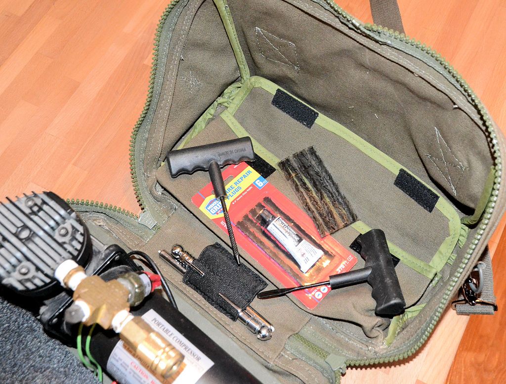

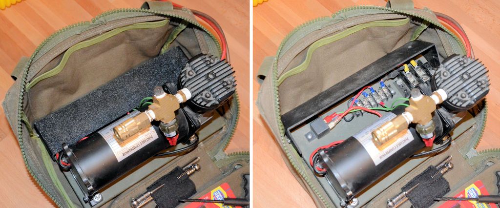

It has a plywood bottom for mounting the compressor and opens diagonally to provide full air flow for compressor cooling. There are outside zipper pockets on both sides of the bag, plus pockets on the inside for things like tire repair supplies (tire plug tools, etc.). There's plenty of room inside for a coiled air line and long power cords to connect it to the battery.
It's wired with a pressure shut off switch and the hoses are set up so it's plug and play to use it with an air tank.
There's wiring to support the pressure shut-off function; that's on the plywood base and is protected with a swing-up cover:
There are two pockets on the outside and two on the inside as well as elastic to hold a pressure gauge and inflator. In this photo the contents of one of the inside pockets are laid out and the elastic for the tools is also visible.

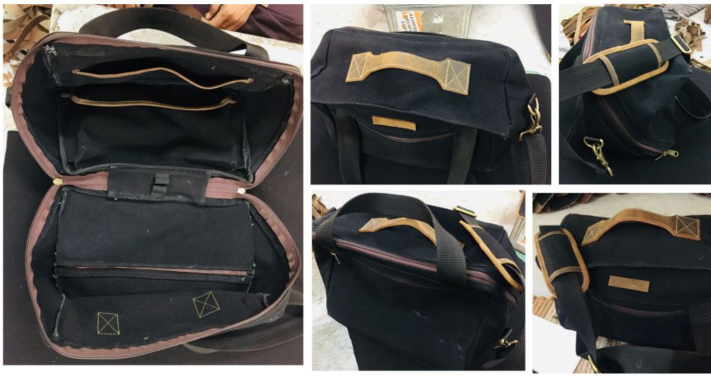

I turned the patterns, drawings and construction details for the compressor bag over to Overland Outfitters last week and they seem
to be moving quickly on it, they sent me some photos of what they call a "mock sample". A mock sample is the first work they do after receiving the design and details from me. It's a very rough sample, sometimes not made from final materials, so they can build their own production patterns and sewing workflow for the product. Sewing for the mock sample is sometimes rough, and once they finish the mock sample they'll use the patterns they've developed from it to sew a preproduction sample which is complete and final quality. They'll send the preproduction sample to me to verify and test before starting production.
This is what they've said to me about these photos:
This is a mock sample, making another final sample, pockets will be fixed, used leather piping, added shoulder pad on strap, YKK vislon zippers will be used in final one.
This mock sample is done in heavy black canvas with leather accents. I did my prototype without accents but they typically add refinements like that to the final product.
These aren't the best photos but they give some idea of what a final bag would look like in black.

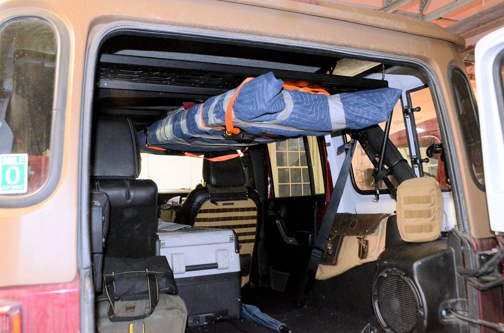

I'm posting this in case the idea may be of use to someone someday...

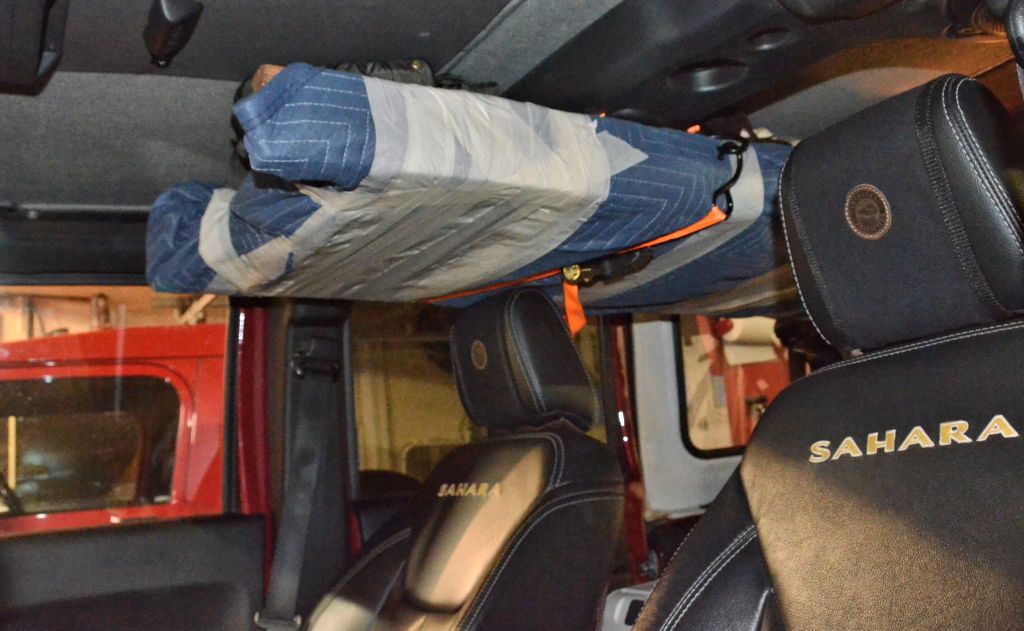

What do you do when you're 1300 miles from home and your significant other finds something on Craigslist that she's wanted for a long time but it's too big to easily fit in the Jeep? Of course you have to get it for her but how do you get it home? On Saturday I was challenged to fit a 6.5' tall carved room divider into the JKU so it could be brought 1300 miles home. In case you haven't measured the inside of a JKU there's less than 6.5' between the tailgate and the back of the front seats, even when the seats are slid forward.
The item in question:
The 4 sections fold together but it's still too long to easily fit inside. I could have put it on the roof rack but I wasn't sure I could wrap it in something and make it weathertight enough not to be damaged if we ran into serious rain or snow on the way home.
My solution was to hang it from the roll bars with ratchet straps. I wrapped it in a Harbor Freight movers blanket to protect it and ratcheted it up snug against the roll bars. It's over the passenger seat and she's about 5'6" so it's just above the top of her head. Not sure what I'd do if she were much taller :).
I took these photos in the garage this morning just before I took it out of the Jeep. She had no trouble sitting under it for 1300 miles.
It looks like it's resting on the headrest, but it's not, it's just above.
