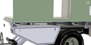

* Storage lockers are fully fitted now with doors and locks
* The last fitting of the hydraulic lifting RUB bar is ongoing, I am very happy with the design we came up with and AV execution of it! It has towing and MC lifting capacity with 3 2" receivers for stability
* Box brush bars are fitted
* New battery design incoming too, stay tuned for that one!
* Water tank and inlet fitted as well as various grey water plumbing, more info incoming
* The steps have not worked out as planned unfortunately, AV have been really understanding to be honest because we were not happy with how they functioned so they have been removed from the deliverables, it is pretty clear that not all custom design items go as planned. We have to come up with another solution but it might be a step ladder for a few years ;) I have to say I am super happy with how AV dealt with this, the steps were perfectly functional but not as stable as we wanted, so they were very accommodating with our request to remove it.

Living vicariously through your updates. The run under bar looks so pro! Brush bars and lockers too. Seems like AV is having a bad luck streak with their steps, we also decided not to go with theirs... -.-
What design did you go with in the end for steps? We will have some space for a telescope ladder or something similar where the steps were supposed to be housed, I think I will just have some come up with a custom design of my own once I get the truck back from AV...

Ah, TBH we had not considered the issue of having a handle. Maybe that's a mistake. But the Krug steps are really very big and stable, so I guess we'll see first how we get on without a handle. If we weren't planning on having a dog we would absolutely go for more sensible steps like what you have, those look great.

I am also trying to figure out what to do with the step situation, I have quite a large space available where the old steps where supposed to reside to store some sort of temporary steps while something more permanent is designed.. any ideas from the community appreciated :)
