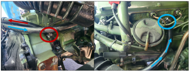

These are the engine loops I am currently plumbed into that are connected to the boiler loop, will have to make some mounts for the furnaces here too:

There is no need to bypass the Webasto units, they are designed to pass coolant when not in operation. The Webasto coolant pump will only operate when the Webasto is on. so if you want to use a plate exchanger between the camper and engine you will need the second pump.
Our system is simpler, no plate exchanger. coolant is allowed to flow around camper and engine loop, so when the engine is running the engine water pump circulates, when the vehicle is parked the Webasto pump circulates. A manual valve between the cab and cabin can isolate the two loops.
Diagram is Italian, Basically 2 loops with the Webasto in the middle. The three radiators in the camper all have shut off valves so you can heat water with the engine without heating the camper (warm weather operation). The valve that shuts off the two circuits was electric now manual.
This simple set up allows engine pre-heat, camper heat, individual radiator heat, hot water heat or any combination. It has run flawlessly for 30 years, the only issues being Webasto related (maintenance requ'd)
