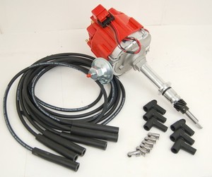

Here is a quick rundown of HEI and why it is an upgrade over your points.
http://en.wikipedia.org/wiki/High_energy_ignition

As Jack linked regarding HEI electronic ignition…. HEI is GM’s electric ignition that began in 1975. It is a very robust and reliable ignition system with a slight bump in performance. Your truck currently has breaker point ignition which is stone age simple, requires a lot of maintenance but yet not very robust or reliable, which some people may disagree (remember back in this truck era a tune up was required about every 10,000 to 20,000 miles. I’ve owned 6 or 7 of these old trucks and have had issues with points on all of them. I learned at very young age how to replace points and hate them! After converting each one of the old trucks I’ve had over the years (and one boat with a 250 I6) to HEI there was never another issue. Some people with complain about ignition module failures inside the HEI distributor but part of that is due to people running cheap dime store part store made in Taiwan modules.
Even though I never suffered an ignition module failure on any of my old HEI trucks over the years I always kept a spare module in the glove box just in case, which is why Murphy probably never dealt me a failure. If are interested in an HEI conversion do some research as you would also need to replace the power wire from the ignition feed in the switch to the actual distributor as the breaker point ignition power wire is a resistor wire where it would not fully power a HEI distributor. Don’t be scared….it is a very easy swap. You should be able to find a straight 6 HEI distributor in NM pretty easy from any old 250 or 292 engine at the bone yard. All the Chevrolet I6 engines use the same distributor.

Would this HEI work with my truck?
http://www.jegs.com/i/Mallory/650/8548201C/10002/-1
Do I need to buy a special wiring as well?
No, that won't work. That is for a V8...you need one for a Chevrolet I6 (inline 6). I'm not much of an aftermarket part fan anyway. Just go find a stock HEI dizzy at the junkyard. You probably won't find one in roadsalt ridden Indiana as these old trucks rusted away many moons ago, but you shouldn't have a hard time finding one when you get home to NM. Yes, you will need different spark plugs and wires too and the clean 12 volt power wire from the ignition switch that I mentioned above. There are lot of write ups on that on the website Lance mentioned.
