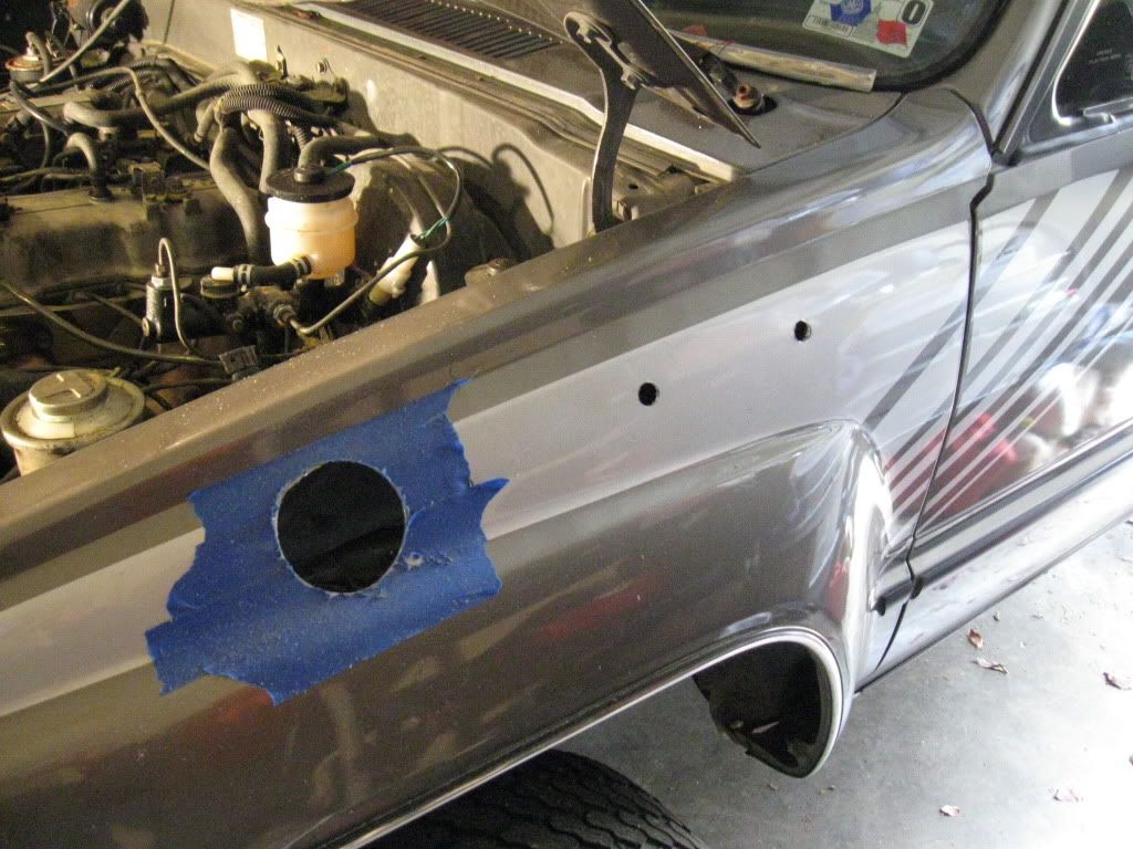

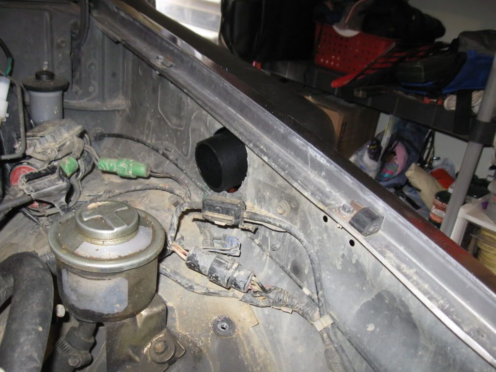

I didnt have a 3" hole saw, so I made a trip to Lowes. Will try to get it finished up in the morning. But, I need to figure out how to route the air into the airbox. May go PVC, may go to a junk yard and find some other hoses.... who knows.

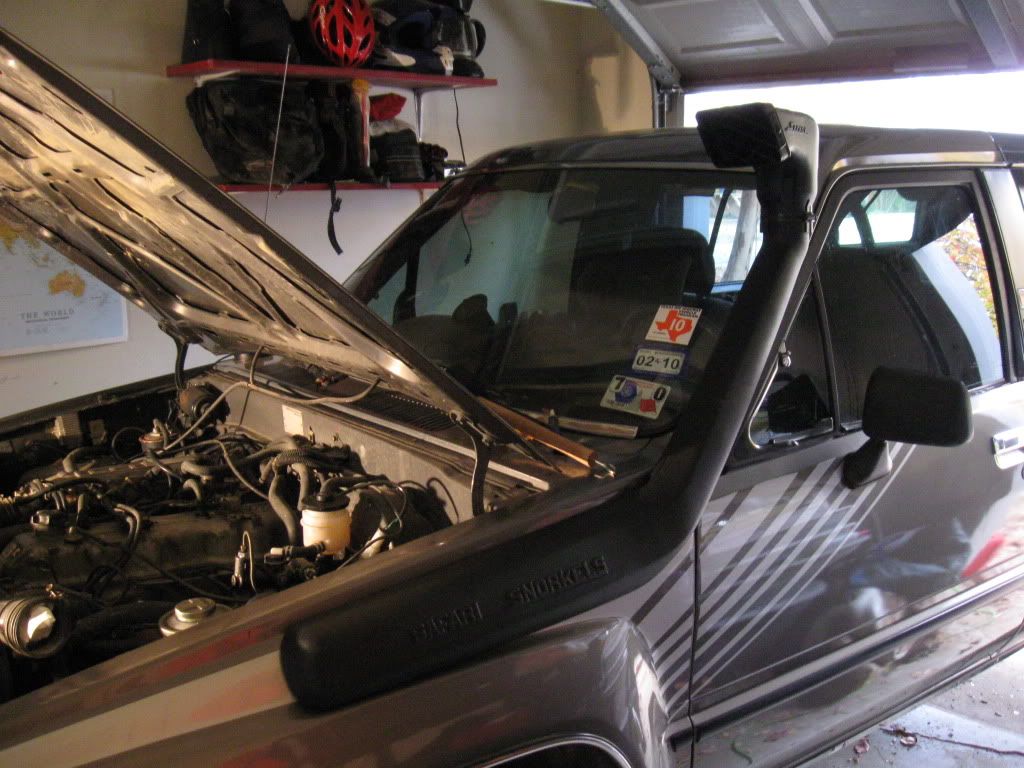

They used a hose from a Mazda truck (center), the stock intake hose (left), and the bit from Safari (left). The problem that I have is that the intake hose on my truck is chewed up pretty bad and quite holy.

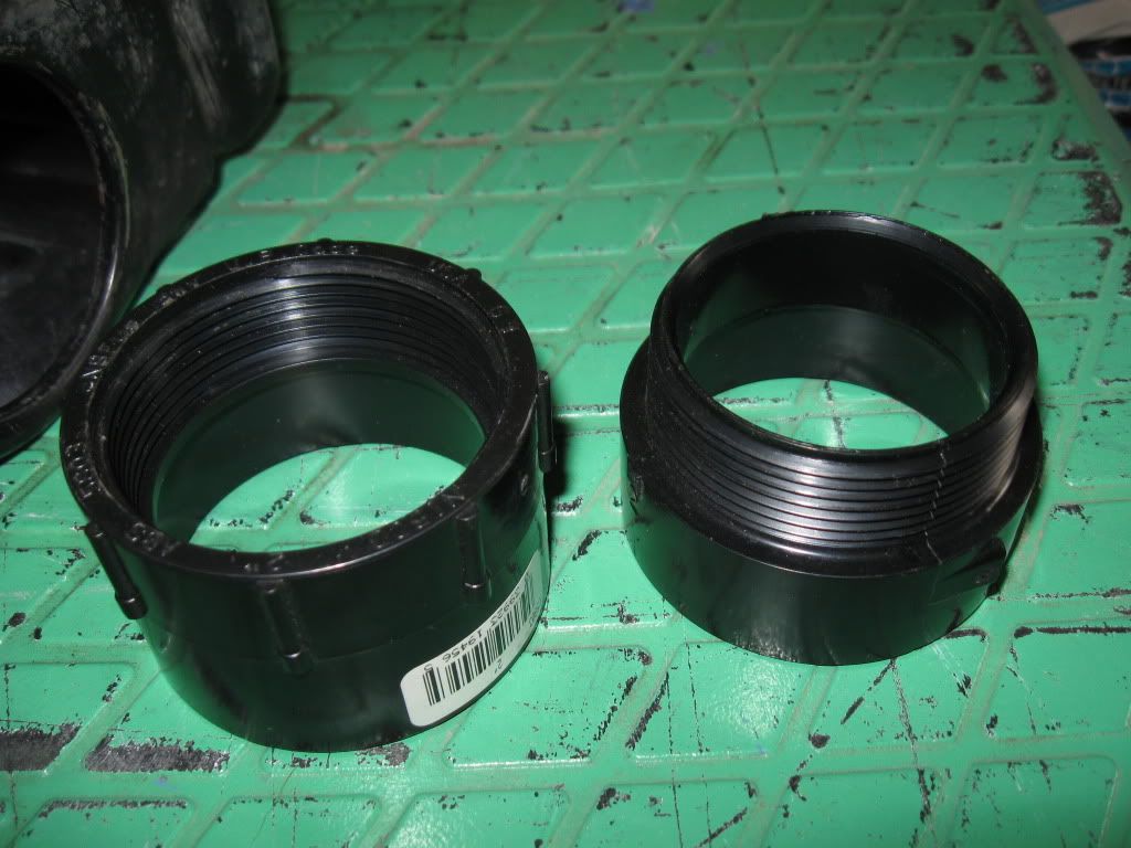

A female and male threaded adapters, they fit nicely into....

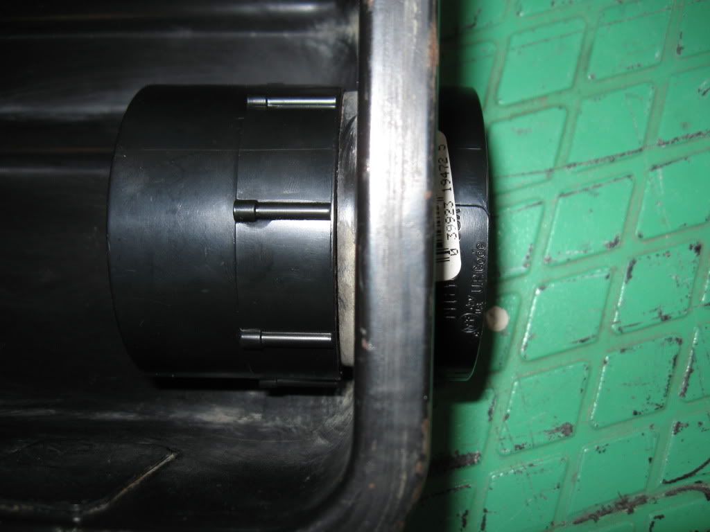

The original inlet to the air box.

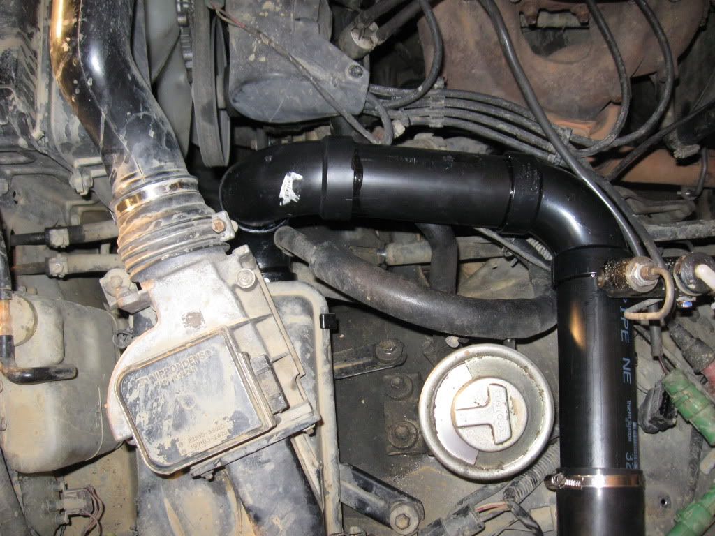

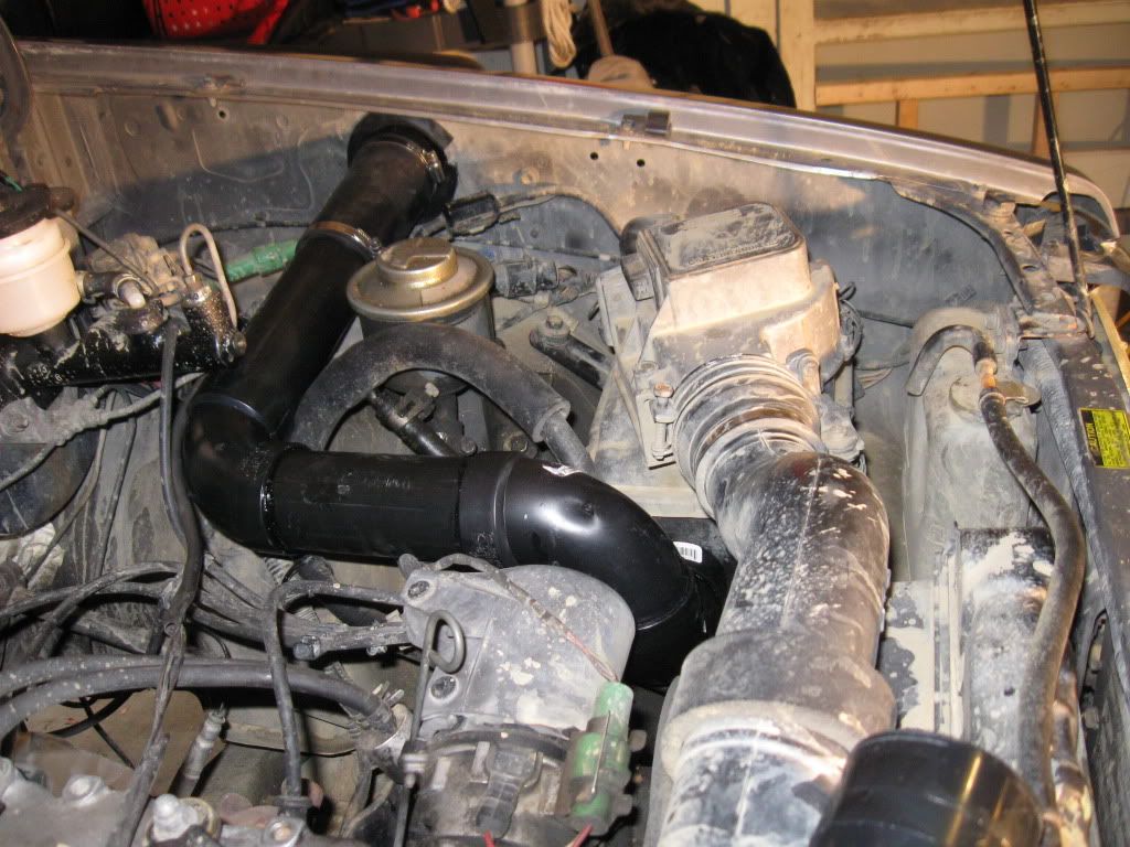

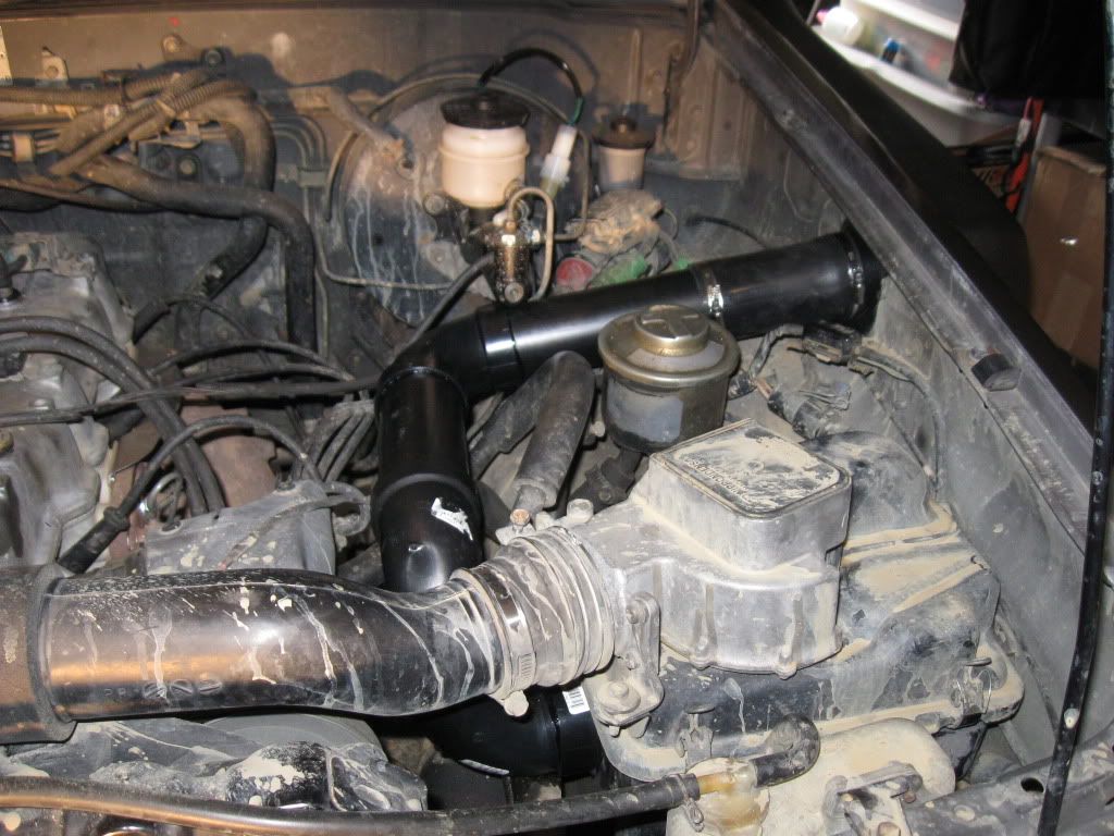

Due to the power steering lines, I had to make another trip to Lowes to get another elbow to finish the routing.
Below are three views of the finished ABS pipe routing.
I used about 2 ft of ABS pipe, a 90* elbow and two 90* "street" elbows. The regular elbow has the two female ends to receive the pipe into them and the "street" elbows have a female end and a male end, allowing the male end to be stabbed into a female fitting.
Worked out quite nicely I think!

It appears to be the prettiest thing under there! :coffeedrink:
You are moving at lightning speed. Way to go! One of the fastest build threads I've seen!

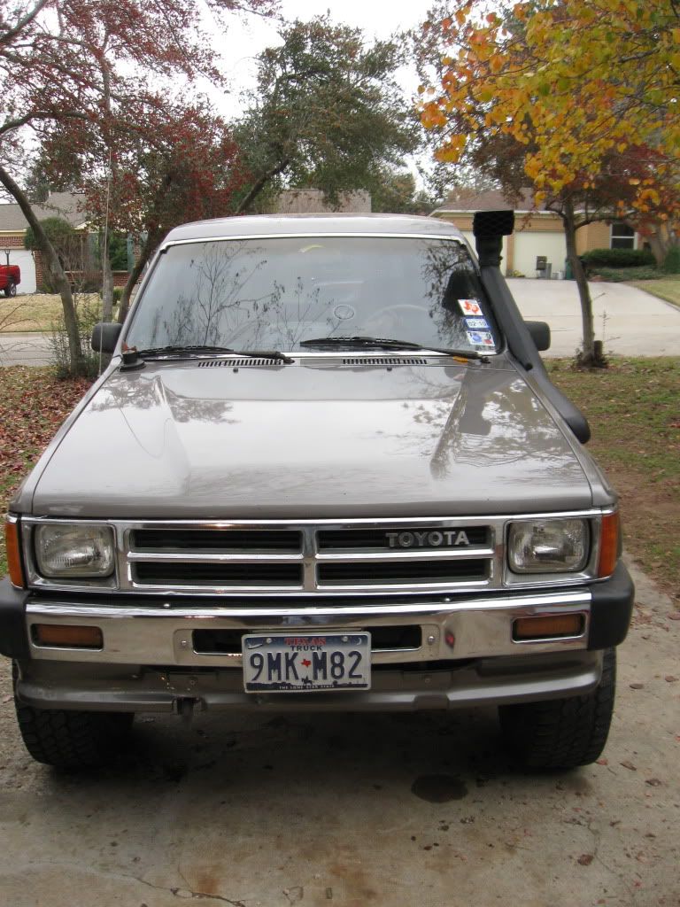

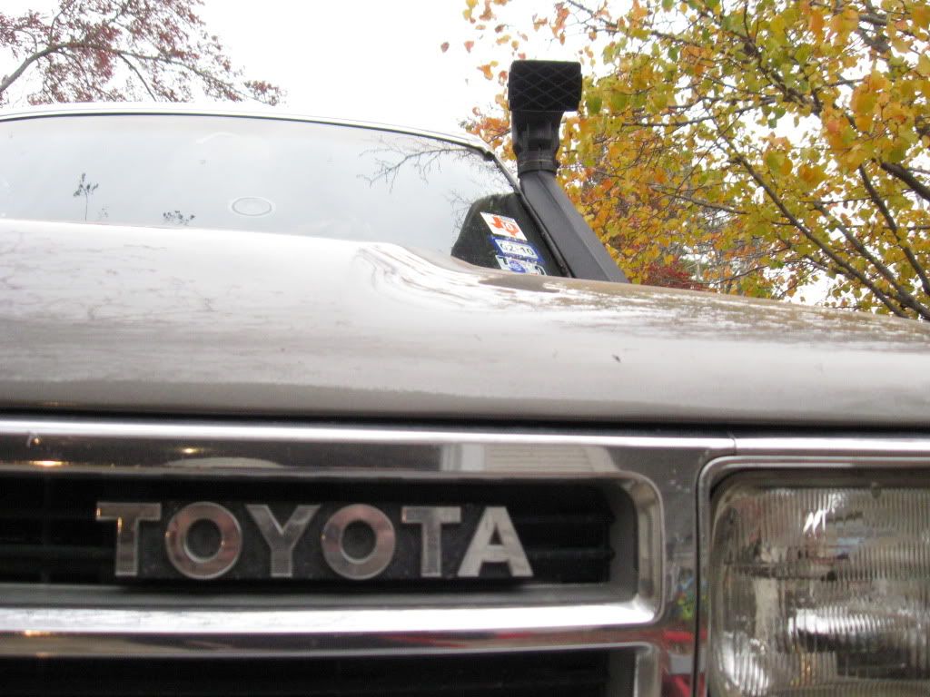

And the finished product! I like! My wife came outside to admire it and said... "Now all you need is a roof rack," of course I also reminded her of the need for an ARB bumper.:sombrero:

Looks good but...be careful with the ABS pipe. It gets brittle in hot or cold temps and if it burns puts out a very toxic gas. I am sure it will work and not be an issues but keep that in mind.
Curious why you didn't use some silicone turbo pipe? And say some stainless steel fittings?
I'll keep that in mind, but I thought ABS was the better choice over regular PVC?
As far as not using something else? Product availability. I used what I knew about and what I could find. Where would I find "silicone turbo pipe?" I may change the setup later if the ABS fails.

All PVC pipe is brittle in cold or hot temps and all of it puts out a toxic gas when burned. If you want to commit suicide just smoke some PVC pipe and youw ill be dead in a hour! Obviously I am being sarcastic about the suicide part!
I hear ya on using what is available, I just used 3/4" pipe in my trucks water system. Overkil for sure but I had a bunch of 3/4" fittings around so I went for it. Doing it over I would just buy 1/2" fittings and use 1/2" pipe.
ABS pipe is for waste. It is thin wall and a non-pressure rated pipe. Ok I think for air intake. SCH40 is a high pressure pipe and is the most common type of PVC besides ABS. There is also class 100, 200, ect. rated for different pressures. All PVC pipe though is pretty much manufactured the same and all of it gets brittel in hot cold or even from lots of sun exporsure. Like I said though I think you will be ok for the air intake.
