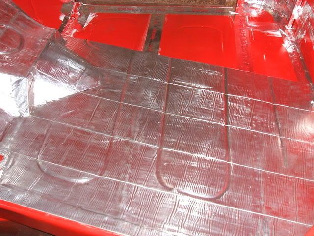

I definitely need to address the noise in the truck. Next big project is to get some of that sound dampening material to line the inside of the truck. Anyone have any recommendations for the best bang for the buck material to use?

I put Dynamat with a sticky backing in a buddy's Altima, that stuff is super dense and kills a lot of noise.

Search around a bit - I seem to remember people using some kind of roofing material as a cheap alternative to Dynamat
quick google search for "dynamat alternative" found this here
Peel & Seal is the cheap alternative to Dynamat. This is the stuff you get from Lowes Hardware. It is the same as the original Dynamat but a lot cheaper.
I started putting my fake Dynamat down. This is the stuff that they have been talking about on HAMB and a few other forums. I paid less than $15.00 for a 6in. X 24ft. roll. It's very, very close to Dynamat other than the price. It has a 40 mil rubberized aspalt sticky back, two layers of high stregth polymer film over a reflective aluminum surface.
I was worried a little about how good it would stick. I pre cut what I needed then I used a heat gun on the backing. Let me tell you!! When you stick it on you can't get it off. Even if it just bearley touches it. Make sure you have it all lined up before you touch anything with the backing.You can use a wall paper wheel to smooth it out. I didn't have one so I used an unopen pop can. As you can see from the bead rolls in the floor it takes the shape of where up put it. Cool thing is this stuff is used for flashing and as a roof patch. Any small holes you may have this will seal them and not let the water in. They do sell a better version of the Dynamat. It is the sound and heat Dynamat. It is almost twice as thick as the original. No problem. For the price difference put a second layer over this one. Even with the floor half done I can tell a difference in how it sounded when I close the truck door.
