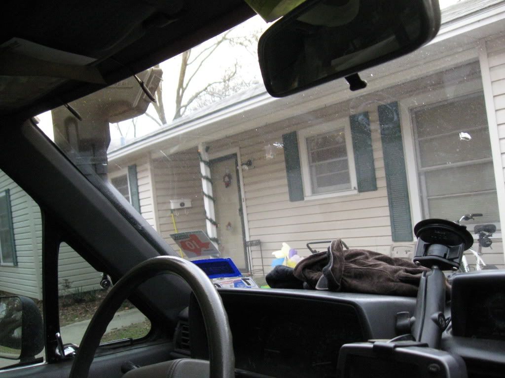

Use the "built in lock" on your 4Runner... If the top is off, put the window up like a 1/2 inch(or less, just enought to trigger the 'lock mechanisim' in the tail gate.). Now you can't open the rear gate. I'm planning on a drawer system so that if the top is off the you can roll up the window and pull the top bolt that complete's the circuit (I belive one of the ones on the rail behind the Driver's seat. Also I have jumped my window terminals so you can use the window switch w/o the leys in the ingn. so you could jump in and lower the window and get in the gate), put your stuff in the drawers (that can't open because of the tailgate not working ;) ) and you're good to go. What I REALLY want for these trucks is a metal, replacement LOCKABLE glove box... I keep looking at the box an thin king I could make one a little different shape and have a cut-out to accomodate a CB or Lap-top mount. Make it out of metal (for security) and mut in a nice Tuffy-style lock. Secure storage i9s one of the things that has led me to not really use the fun "top-off" feature of these amazing little trucks. Sucks too because I really want to take it off and takr a trip to the beach for a weekend. Sleep in the back, under the stars... But I need to be able to lock up at least SOME of my gear eh... I also think that metal or maybe even plywood and automotive carpet to re-make the interior rear panels would be a good idea too. then the rear compartments could be used for some real lockable storage as well. There's alot of potential for these trucks too because like all old vehicles they can be taken apart, modified and put back together in a reasonable fashion without things not fitting or looking wrong with the swoopy lines and complex design of todays modern SUV's

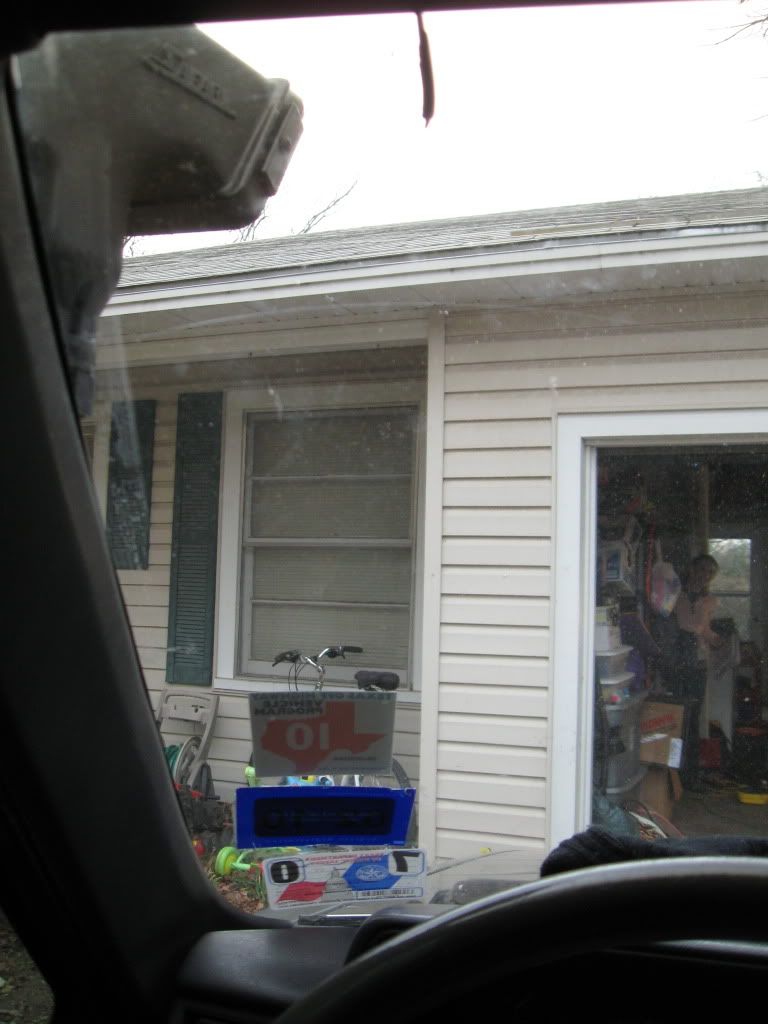

Love the Snorkle too bro, this truck is taking shape at lightning pace... YOU'RE MAKING ME JEALOUS!!!!!!!!!!!!!!!! :D :D I gotta ask too since we have near identical trucks, how does the Snorkle work in respects to visability??? Does it bloick much of your view??? Part of what I really like about these little trucks is they've got pretty good visability and with my small lifty I really sit up above the rain spray and splashes. The Snorkle on the 70 Series Cruisers I ran in Australia were on the oposite side of the truck so it's not the same. I'm really thinking about geting the snorkle soon as I've already hafd a few run-ins with water where I was quite nervous. I've got some other ideas about further water-proofing the truck beyond that but the intake is an imprtant part obviously. Plus the dust protection in the summer is invaluable IMO. I think I may run the "cyclonic" pre-filter when I pull the trigger too. anyway, I'm rambling. Nice truck.
Cheers
Dave
One of the main reasons I got the snorkel setup was for when I travel down to Mexico. Many places along a couple of the routes I've been on before (and planning to do again soon) look like this.
This is just from one motorcycle going through the area! Imagine 2-3 trucks!
Visibility issues? None.
In fact, the only thing I have noticed with the snorkel being there is a slight increase in HP during cold weather. And, the only thing that pisses me off about the snorkel is that my window swivel vent thingy is pretty much non functional. Yes you can open it just fine, but no wind is directed in! Grrr. I really like to use those!
