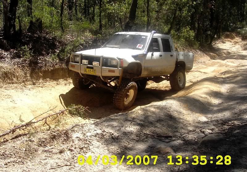

Anyone know if I could retrofit this ARB bumper onto my truck??
Thats for a Jeep Grand Cherokee 1993-1998
Mr. Leary, your fabricator buddies... reckon they could fab up a bumper similar to this one?

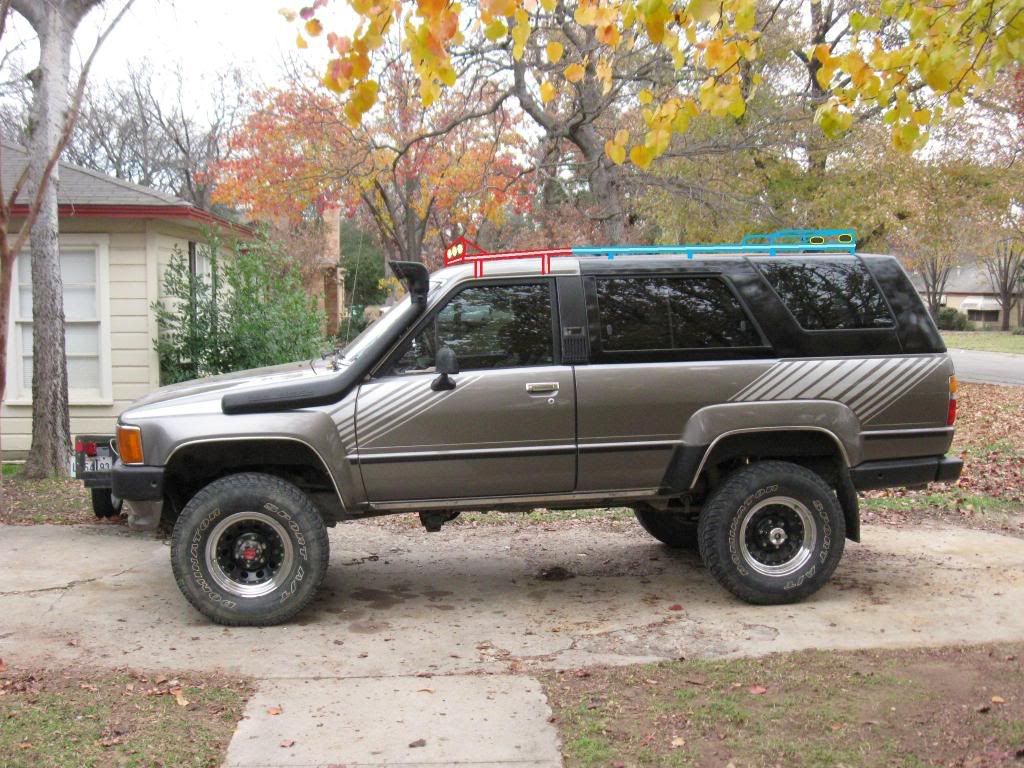

Roof rack idea.
I'm going to start working on my roof rack tomorrow. I'm thinking two different sections.
RED:One on the metal section of roof that attaches to the gutter rails. Going to make my own mounts there.
BLUE: Then on the fiberglass section, another rack that hard attaches to the fiberglass roof.
Why? Well, I DO intend to take the roof off during the summer. I want to be able to use some sort of roof rack, plus if you notice I've got some lights shown in there. I'll have 4 lights, that are removable also removable, actually, The light bar is one that I've already made and used on my Xterra.
