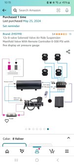

I rigged up the bags to an 8-way low voltage solenoid valve system. I did this because I wanted it remote control operated and I wanted to control them individually. This way I can level the camper truck when it's on a slight incline.
To power this system, I have a battery in the same box on the bed. (I am keeping the truck and bed battery systems separate). In that same box is the Viair, continuous duty, onboard, air system I installed. Along with a pressure switch and water separator af the exhaust check valve of the compresor. 1000001039.jpg1000001032.jpg1000001031.jpg1000001052.jpg

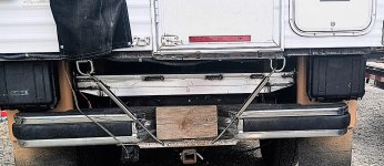

You can see in the above photo that I've Configured my rear camper mounting as well. I'll build a beefier bumper for it soon and I'll make its mounting similar. I also have the front camper mounts figured out in the below photo. Notice the mounted and finished air tank below the generator too.

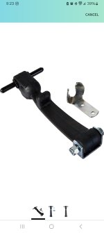

Lastly I removed these old crazy latches that would just barely hold the pop-top down. I replaced them with some Buyers heavy duty rubber ball latches.
And on the last latche install, I find this... ROT. So that's going to need some serious attention when I get back from work in a few months... I'll ********** the 1988ness right out of that camper....
