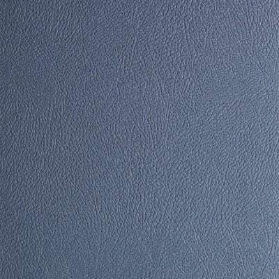

Other than that, I have cut all of my floor insulation (1/2" pink foam) and cut the rigid floor panels as well. I chose PVC board again for longevity and because it's extremely flat, consistent, and nice to work with. Here's a piece fresh after cutting on the CNC.
I ordered some industrial vinyl flooring but it will take 2 weeks to arrive for some reason, looks like this except I ordered brown to stick with the creepy vibe-
