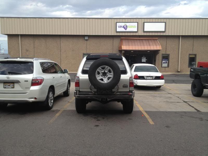

Some more progress as I move along. It is almost finished now
The hitch in the carrier is for a bike rack, or other hitch mounted rack that would be a pain to deal with if it was in the bumper hitch. Most of the time it will have a cap in it. I will build a rack that bolts into it for jerry cans as well, so that I can carry gas.
I braced the tire mount and the main hoop some more. The tire mount now has tube welded behind the plate as well, so that the entire structure is fully welded to the main hoop.
Lastly, I upgraded my latch to a 2k lb one from McMaster Carr, as well as I got the option for a secondary latch to keep the handle from rattling open on washboard roads.

I finally got it done enough for now. I have a couple things to add down the road, but this is where it is at, and I need a break for a while. I painted it, but i think I'll add in a few things in a week or two and then get it powdercoated. The paint has already chipped in a few spots :mad:
On saturday I removed my old man emu rear springs, and installed a set of FJ80 fronts to regain the height loss in the rear from the weight of everything. It sits about perfect right now, just a very slight forward rake, which will sit level with a full load of camping or hunting gear, and not butt sag (I hope).

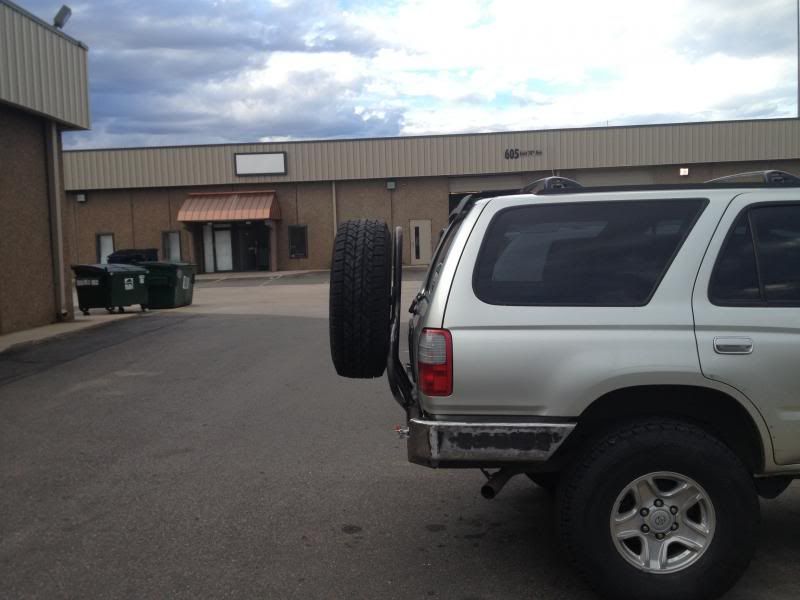

AxleIke
Thanks! So far, I'm discovering I really need a Stay, to hold it open when the truck isn't level. Working on some ideas for that.

I ordered up a stay pin from TMR Customs. I'm currently using a hood prop from an 86 truck, which I just pin against the back of the truck.
Got the truck out in the dirt this weekend, and discovered a couple of issues.
I don't have anything to block the spindle from mud, so when wheeling, the back side of the spindle gets covered in mud. Not a big deal, but I'll need to figure out how to make that not happen, as I can see it getting muddy enough to hinder operation (mud jamming against the body of the truck as the spindle rotates).
The entire thing is REALLY stable on the bumps and washboards, which is great.
I also need to get the plastic cover back in from the factory bumper. it just looks goofy with the hatch open. I'm planning to cut it down and use some weather strip to seal it against the bumper.
