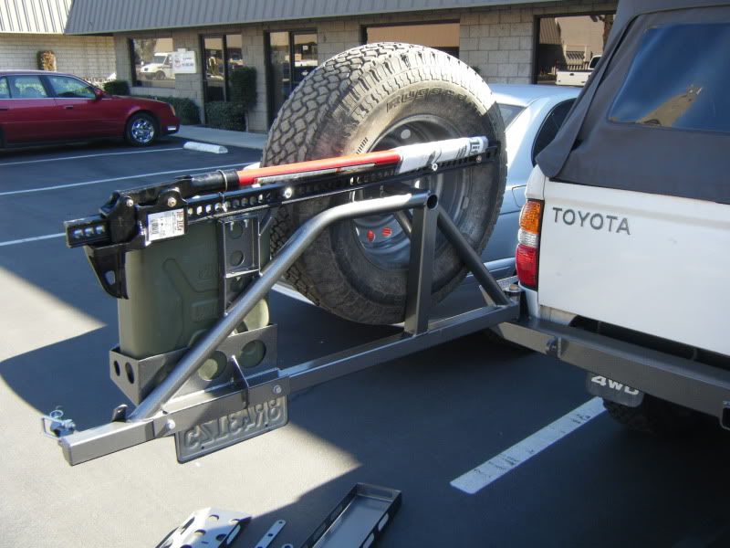

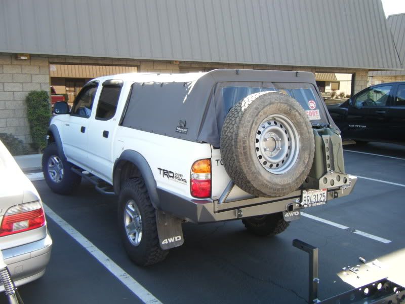

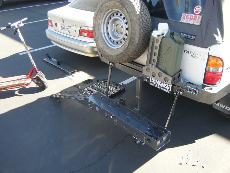

Great rear bumper setup. Are they gonna start production of those? I'd squeeze in a hi lift mount too. I really like the looks of the 4Runner front bumpers they make just need some more pics on the website before I shell out 750.
There is a hilift mount on the bumper and I will have a photo taken soon with Thanks for the reminder. Btw they are going to start production soon as the 4runner crowd has shown much interest. Will update everyone soon.

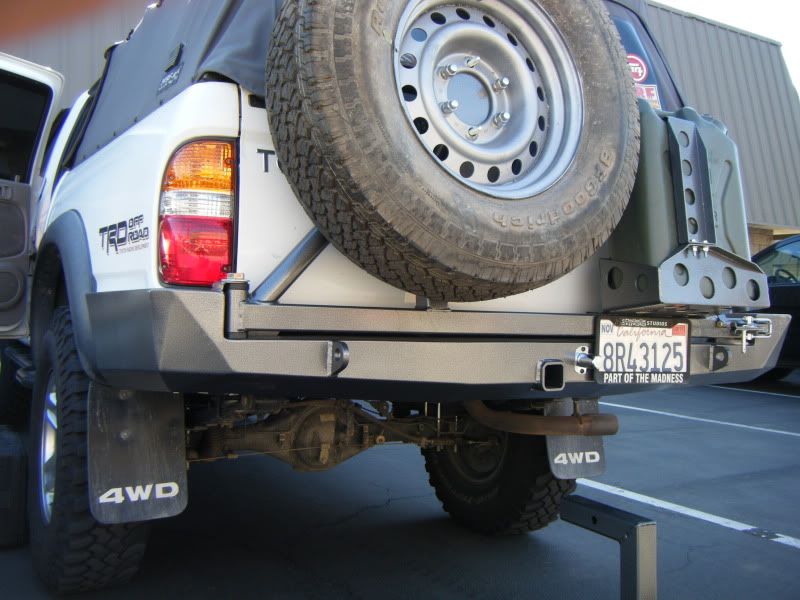

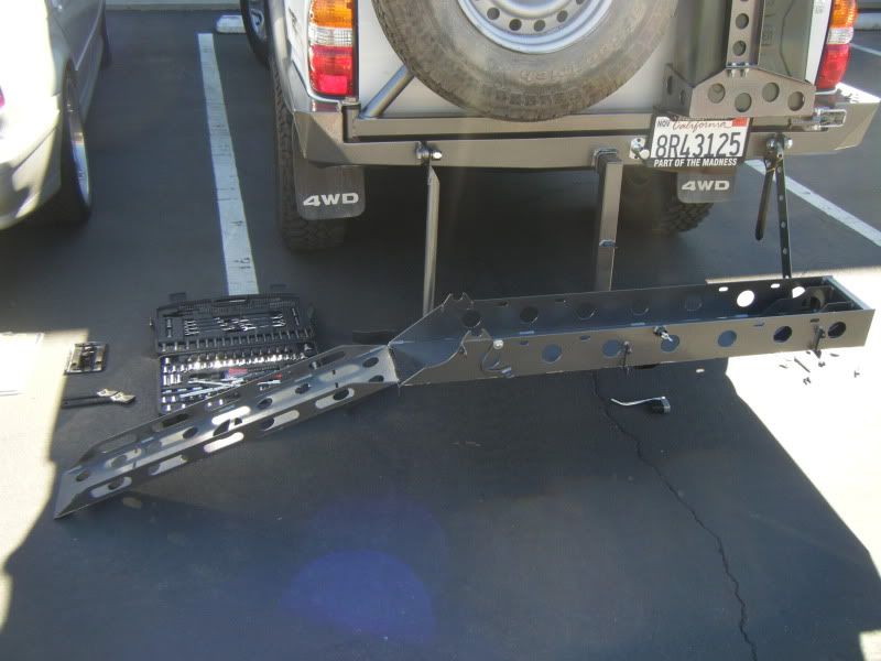

I kinda skipped over the thread, so sorry if you've already answered this, but did you do the rear frame plates? I know some think its not as much a problem on the 01-04, but I would think with all the weight of that bumper, it'd be a nice "piece of mind" thing to do. I'm def planning on doing frame plates on mine regardless of what bumper I end up with.
I was very surprised when I was under there to see it was C channel:Wow1:
We ran a plate on the out side and under side. Think of an ( L ) then with in the frame is another smaller ( L ) does that make sense?

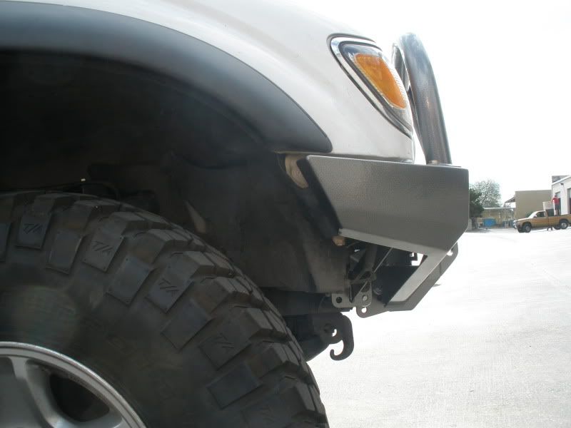

2003 Tacoma Front bumper
Back in the shop for some new mods :

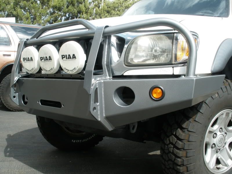

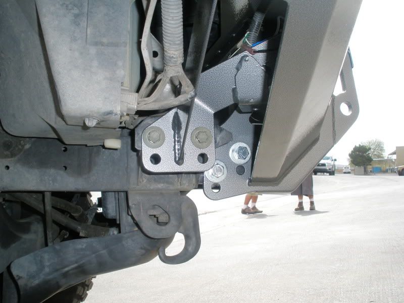

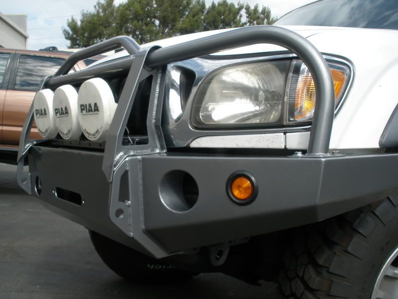

Our buddy Poe has been waiting to get a front bumper to match his rear. We finally had some time to sneak him in..
Per his request he wanted the brush guard to be bolt on so he can play with the look and style as he wanted. We worked with Poe over a couple of weeks looking at ideas and designs that captured the look he wanted.. Hope you all like it as much as we do
