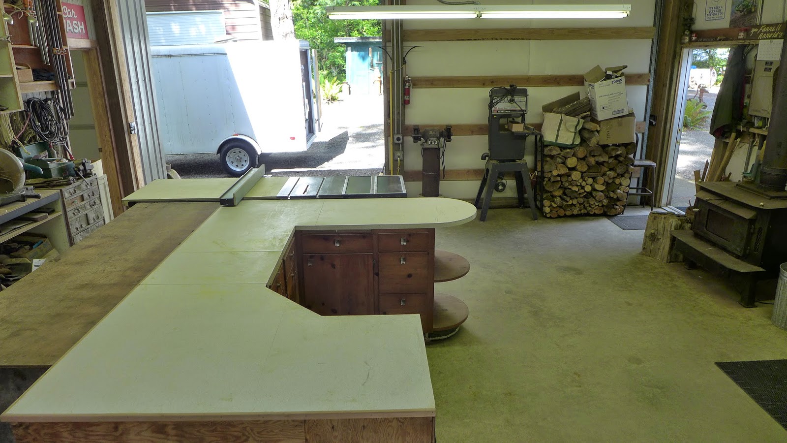

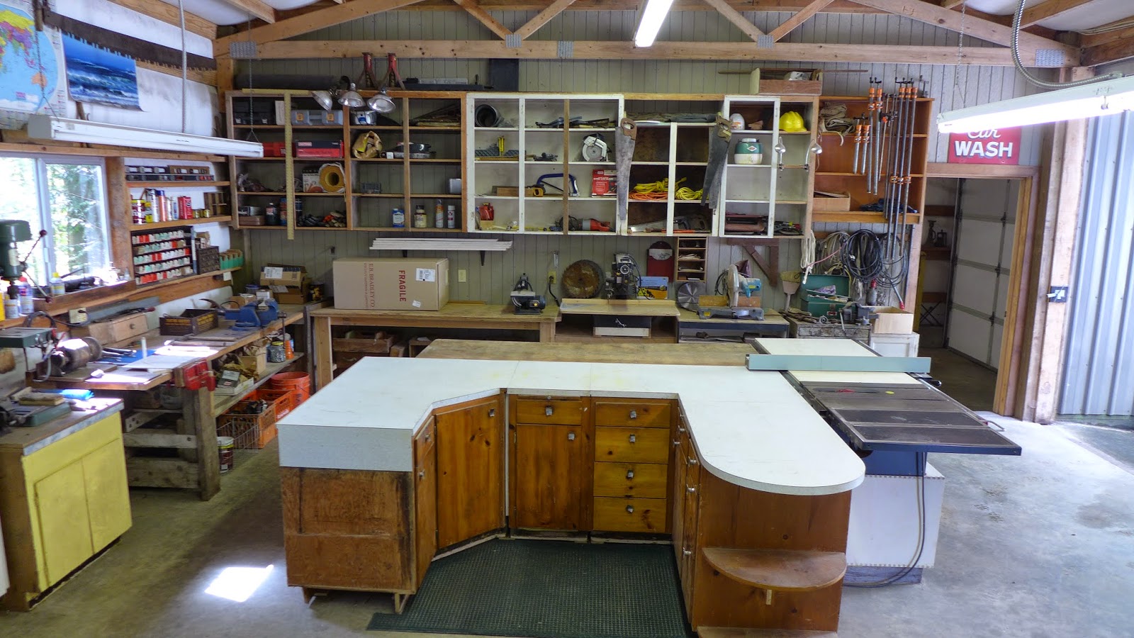

(above) First off, I will be working out of here soon... A very nice place to visit...

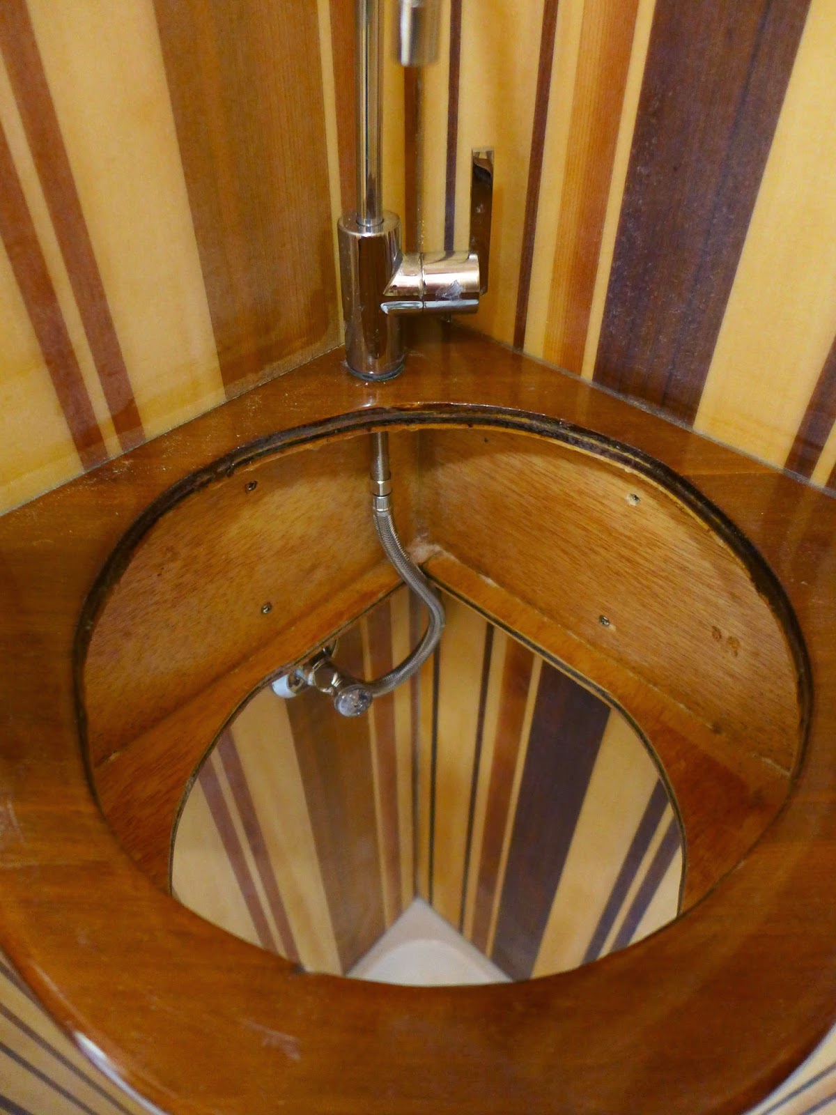

(above) Shower sink just before close-up...
(above) Simple...
(above) Got lucky finding some attractive cedar... Back-screwed with SS screws... It comes out without juggling...
(above) A flood coat of water repellant will help it not get blotchy, if that even matters...

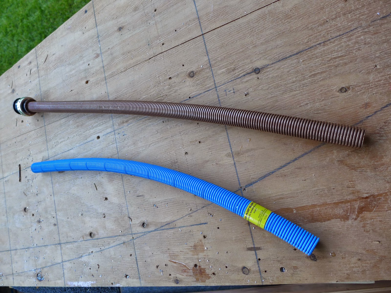

(above) The shower sink drain is a standard tailpiece, with a 3/4" Carlon coupling epoxied into it... The tubing is electrical conduit epoxied into the fittings... Later it was painted with hammered copper paint... it will sit in the hole in the wood deck...
