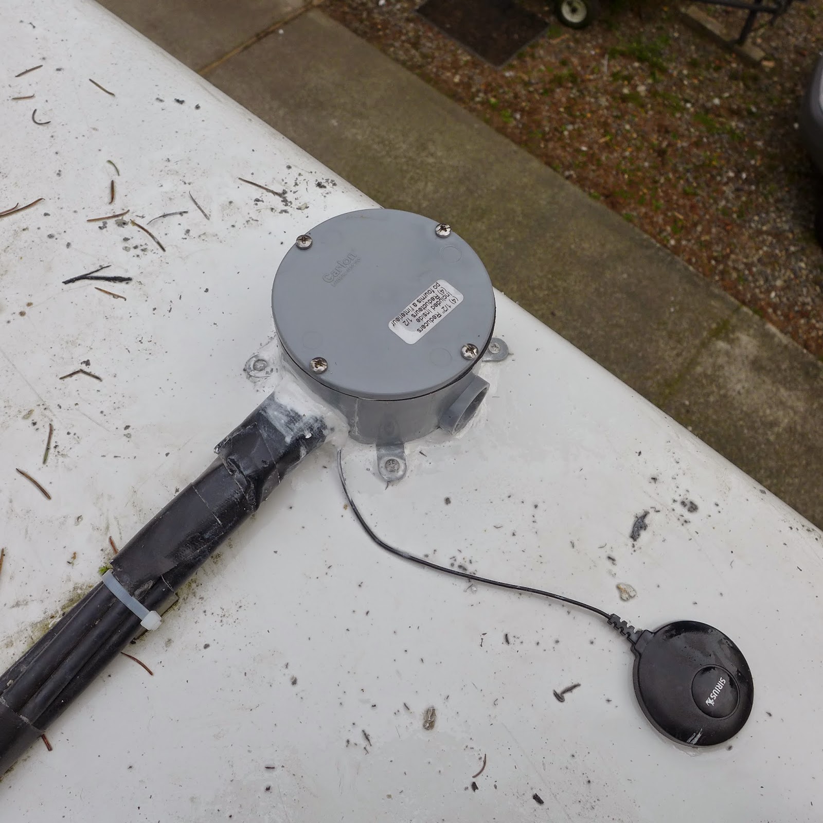

(above) The antenna for the satellite radio needed to have the cord go through the roof...The old junction box for the swamp cooler lines was cracked and held together with caulking... It was leaking a little... A stronger and UV resistant box replaced it...

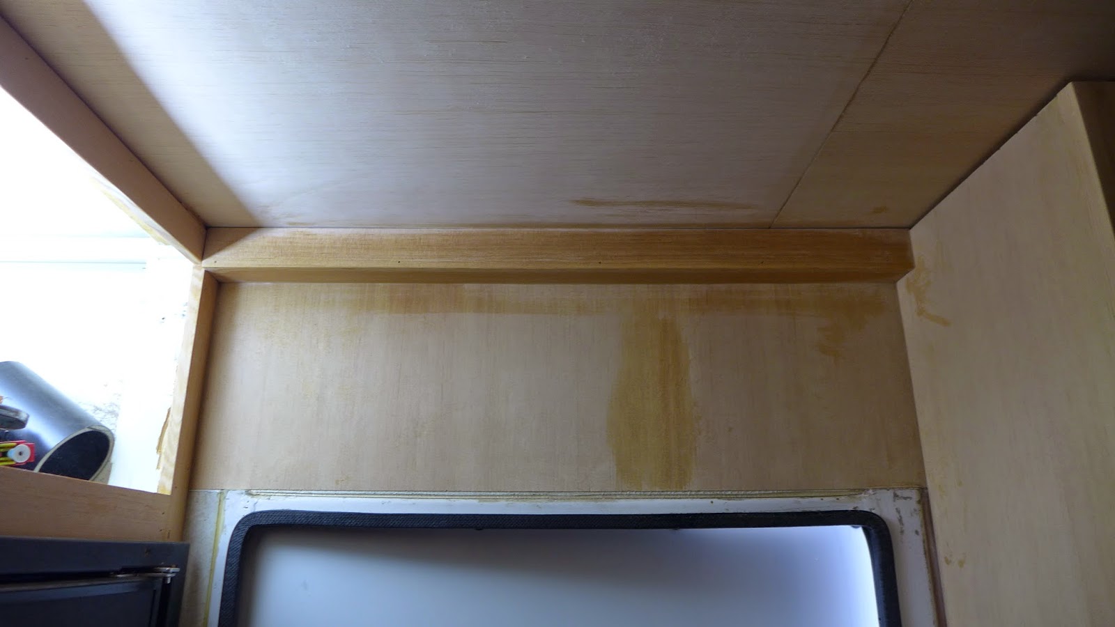

(above) The face of the fridge cabinet got a fresh wood cover...
(above) Looking back from the fridge...

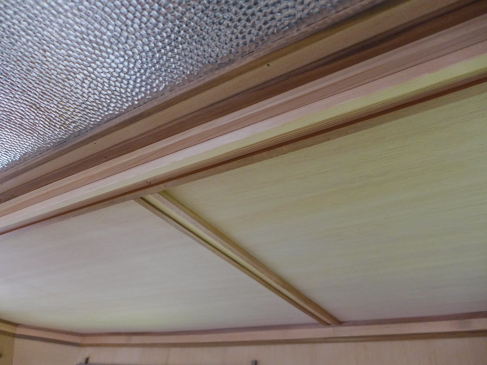

(above) Layer by layer, the ceiling trim is taking shape...
(above) Just enough, not too much...
(above) Finishing the ceiling trim was a bit of a milestone...

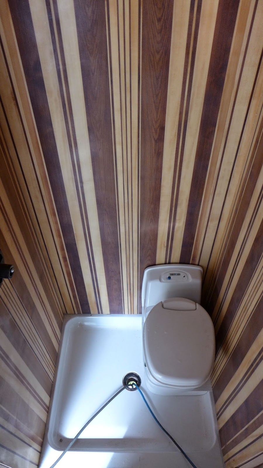

(above) The shower panels were cut to size and fitted in the rough shower stall...
(above) I might have to do this in my house...
(above) The panels were brought back in the shop and sanded to 400 grit, then buffed with a wool pad and buffing compound... After the dust settled, the panels were buttery smooth... Next, the upper hammered aluminum panels were glued in place, then the first wood/fiberglass panel was glued to the wall with polyurethane construction adhesive... Bracing pushes everything tight... The next panel goes in tomorrow...

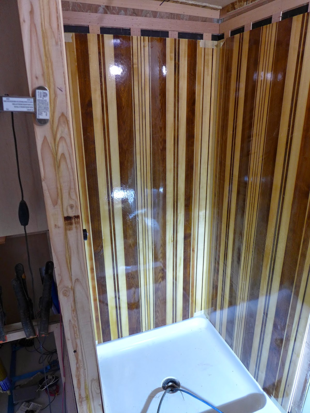

(above) Back in the shower, the bracing from the first wall was removed, the new panel was wiped down to get it relatively dust free, the walls had Poly-U adhesive gunned to the panel backing and the new panel was braced tight...

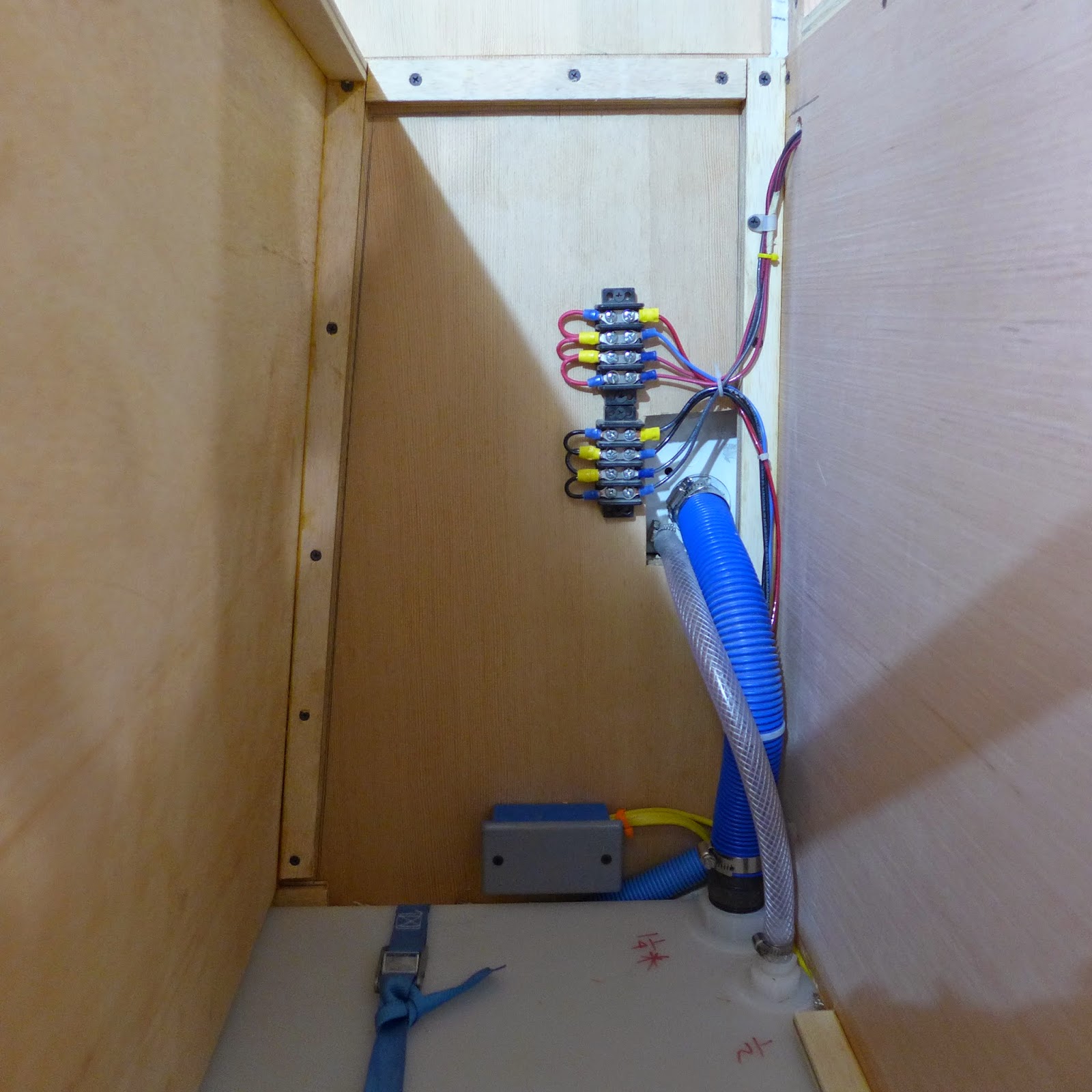

(above) Back in the Fuso, the water-tank, water-level viewing /cleaning port was drilled into the tank, the port was bonded and screwed to the tank... The old tank had a similar set up...
(above) The seat has a wood access port to the tank port...
(above) With the tank fully set, the seat/tank cover, was also finally set...

We now have our Sirius antenna stuck to the top of an inside cabinet and it works. It's magnetized to the bottom of a steel pizza pan as a ground plane. Thought it had to be outside but obviously not.
