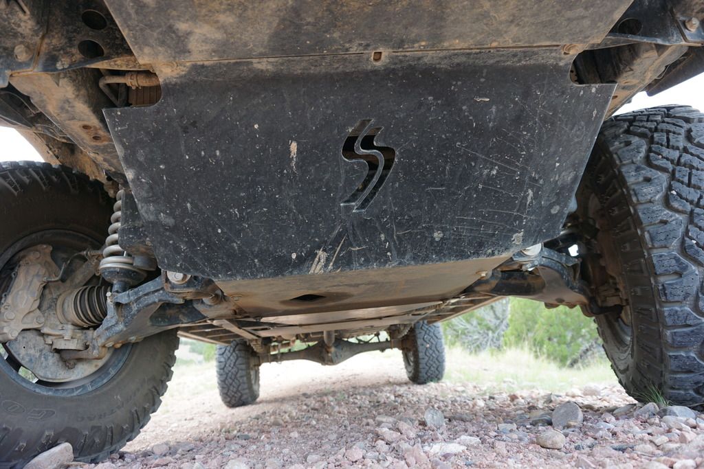

Alright. Fishing was excellent and the weather was nice and crappy! It made for solid hatches, fewer fishermen and not so hot photo ops for the truck. I took these en-route home with weather significantly thinned and some in my driveway. Let me know if there are more specific pics that you want to see of the new goodies and I'll try to take some. I also am hoping to take it out one of these weekends and get some flex pics as well as some measurements on the wheel travel. Enjoy
I noticed a lot of my shots are from the back, here is her from the front!
Nice flat steel belly.

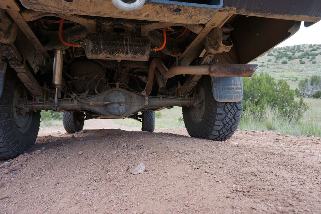

I forgot to add that when I put in the new spring packs I flipped the u-bolts too, also you can see the air tank I added and you can almost see the remote resi's from the new rear shocks.

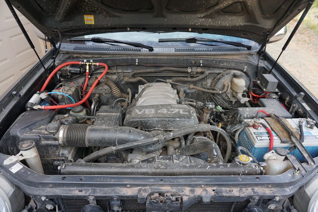

Now the bay (wiring) is nice and clean.

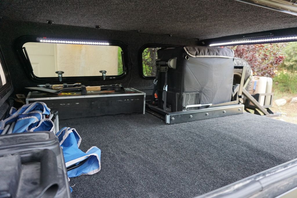

View in from the DS windoor. LED Strips over each windoor are triggered by each windoor opening. (DR windoor turns it's light on, PS windoor it's light, Main rear door turns on all three)

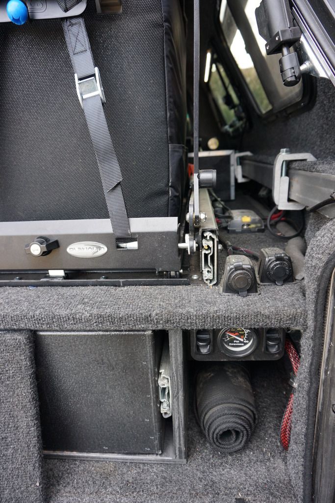

Next to the fridge slide, power outlets one cig lighter style, one pair of USB. The Aux panel in the background and the air-spring controller below.

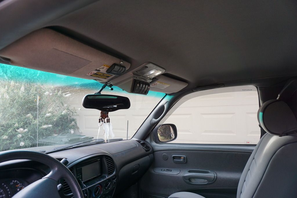

Forgive me if it's already been covered...where did you find that switch box? Been wanting to set up something similar. How hard was it to run cable to it? Did you have to remove the headliner?
Sent from my OnePlus One using Tapatalk.
The overhead switch bank I fabricated. I looked around quite a bit and couldn't find a part that worked. I have seen them mounted flat into the sunglasses holder or garage door switch plate (what I had) in the OEM console but I honestly didn't like the flat layout for looking at the switches or the clearance for wiring behind. I fabricated mine on the existing panel with some ultralight MDF I had in my shop: 1/2" as a base and 1/4" around the switches. I seamed the MDF with epoxy and the base is epoxy and has a few small screws from behind to make it really stout. The sanding and bodywork/paint took longer than the fabrication. I put a removable panel in back to make it possible to re-install it as the two screws toward the windshield are really hard to get to. It took a lot of work but I love the result.
Running wire isn't too hard. If you pull the A pillar cover and the existing overhead console you can fish across the headliner pretty easy.
Thanks for the info! I was hoping I could just fish cable through there but was going to talk to someone who had already done it.
Thanks for the update. The overhead switch panel is sick. I would buy one unfinished and I would just do the bodywork/paint !!!
