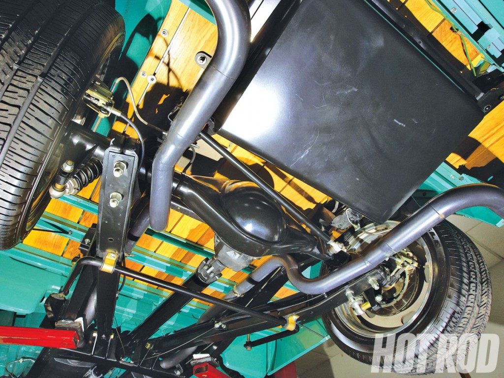

What's old is new again. The 1961-1972 Chevy C10 truck had coil rear springs and trailing arms. I think leaf springs were an option.
hrdp_1011_03_o+holley_performance_products_LS3_1967_chevy_c10+ford_9_inch_with_a_factory_trailing_arm_suspension-1024x768.jpg
Yes sir, that used to be the hot setup for running Baja, before people started fabricating their own...they would harvest those.
