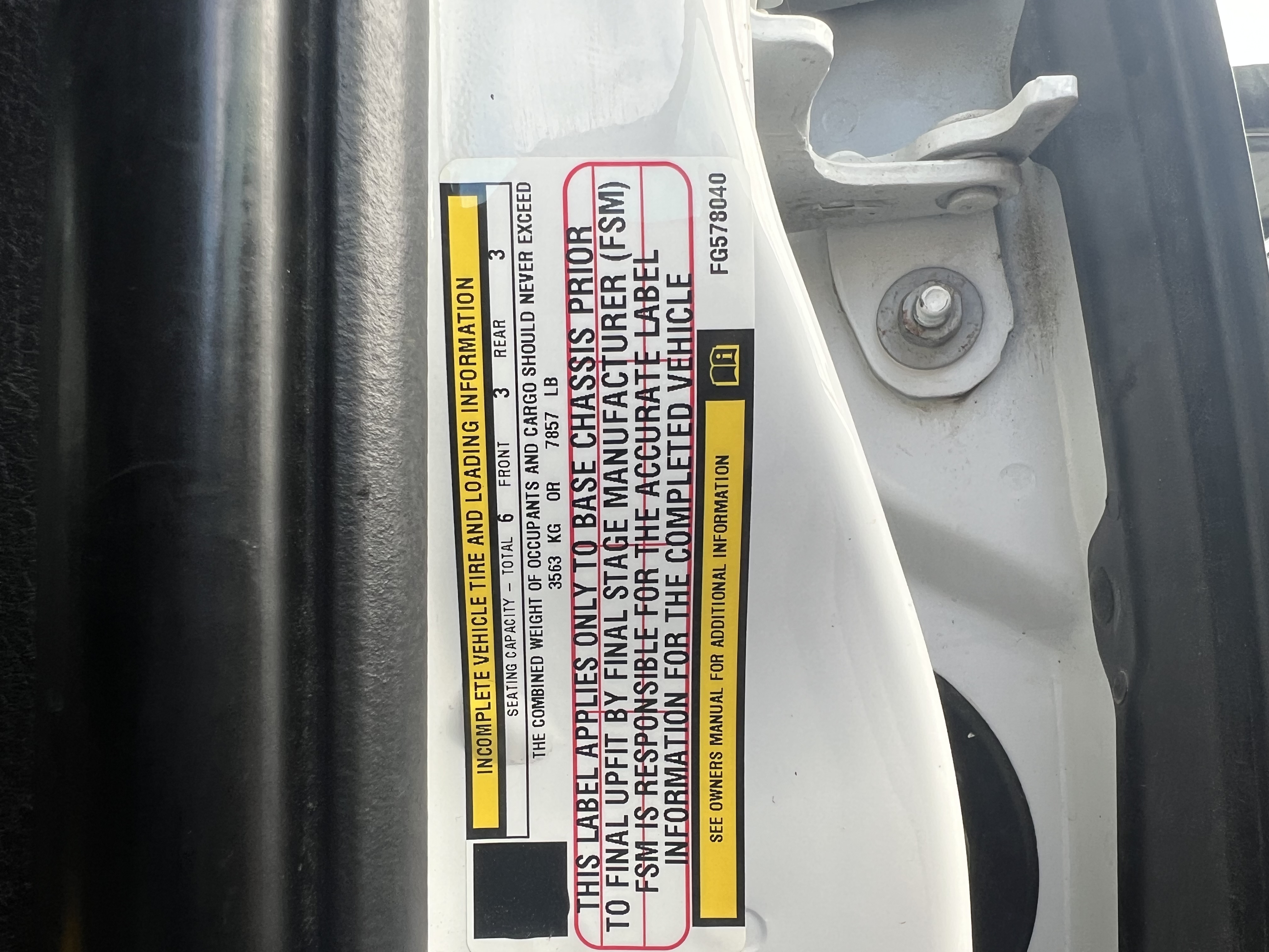

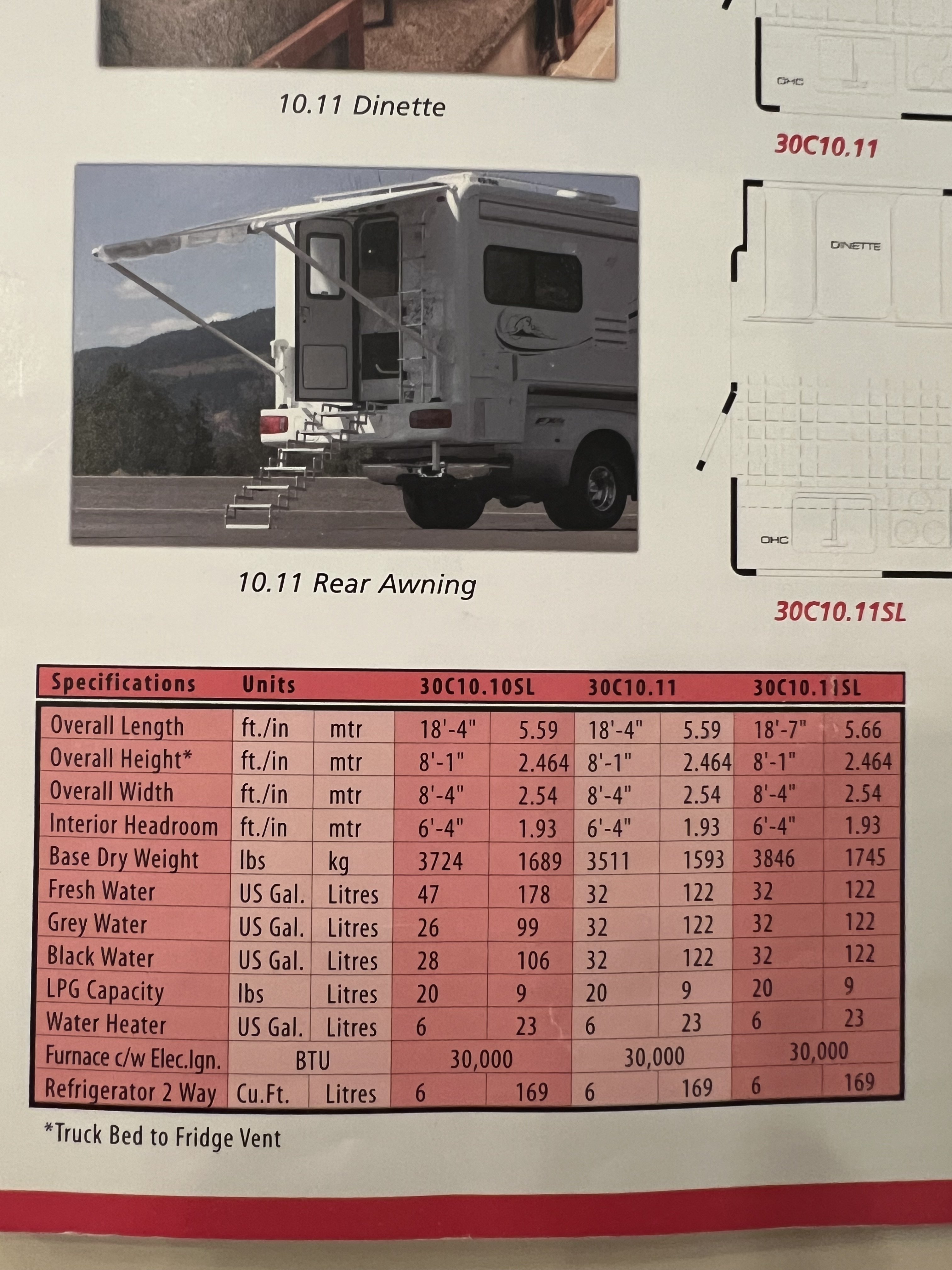

I’ve never weighed the truck/camper. The door sticker states total payload of base chassis prior to any alterations to be 7857lbs. The truck has an 11’ CM truck bed Model 1510308 with listed weight of 1260lbs. The camper is a Bigfoot model 30C10.11 with a base weight of 3,511lbs. 32G fresh water tank @8.34lbs/gallon= 256lbs full. No black water bc composting toilet. 52 gallon fuel tank on truck @7.1lbs/gallon = 416lbs full. Let’s say the Hammerhead bumper/winch and tool boxes are another 400lbs - total guess. That totals 5807lbs. Payload of 7857-5807=2,050lbs for passengers and other gear. Again these are theoretical as I haven’t actually weighed them together or separate. Hope that helps!

Finally got back out to the truck to measure the wheelbase. It’s the 197.1” version. The door sticker also lists the total GVWR as 16,500 lbs. GAWR rear is 12000lbs. GAWR front is 7000lbs.
Thank you, dubs. Now that's a payload, 7857 lbs! And the remaining 2050 may be enough. Checking back in a few days. Thank you.
