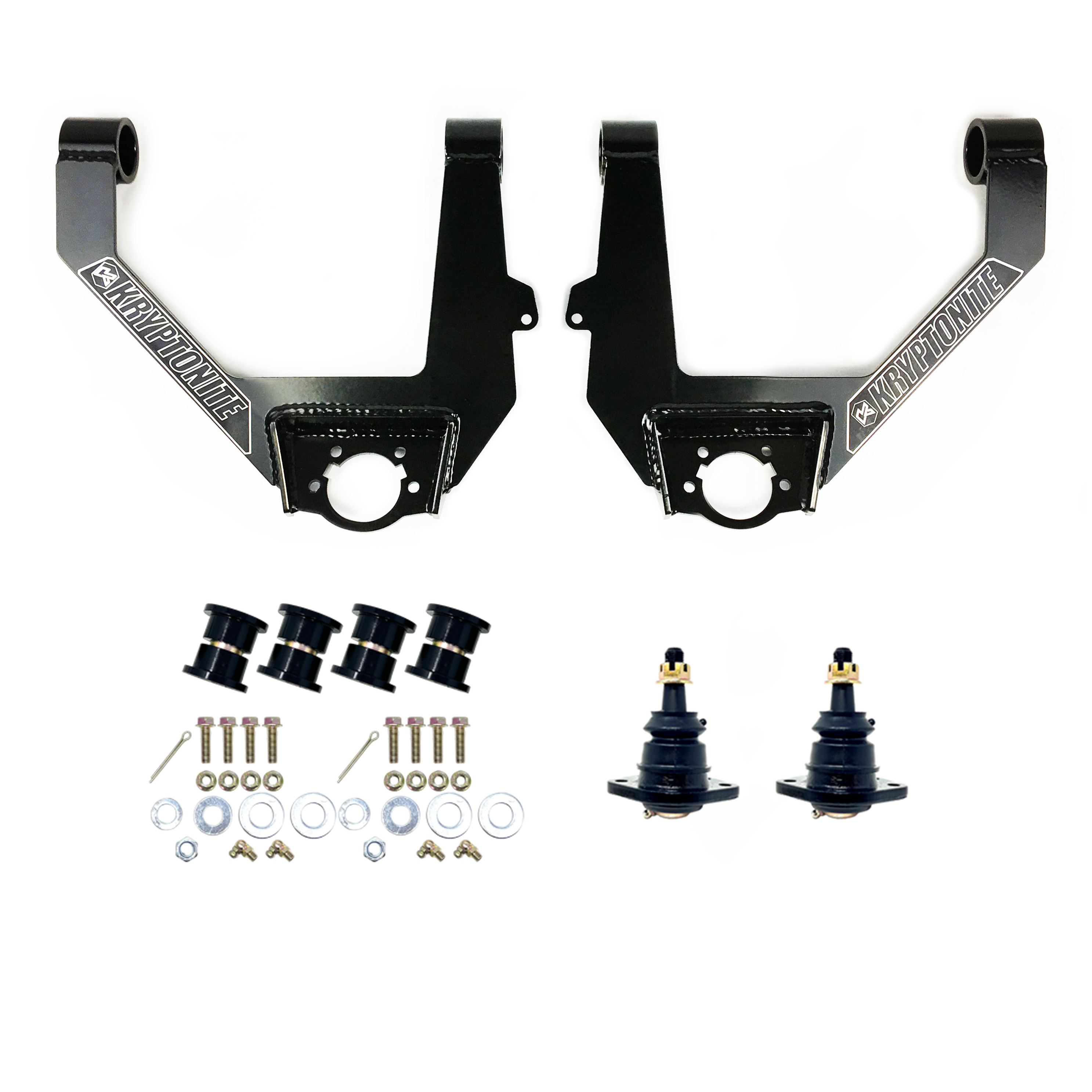

I am debating between the two control arms:
Ready Lift
#67-3500
$410
Cognito
#110-90293
$515
When I did UCA on my old 2500, I went with the boxed version from kryptonite. It seems like Cognito was comparable build quality to those.
Cognito arms seem solid
I do like the bolt on ball joints that are greaseable
I wonder why they don't have zerk fittings on the mounting bushings
