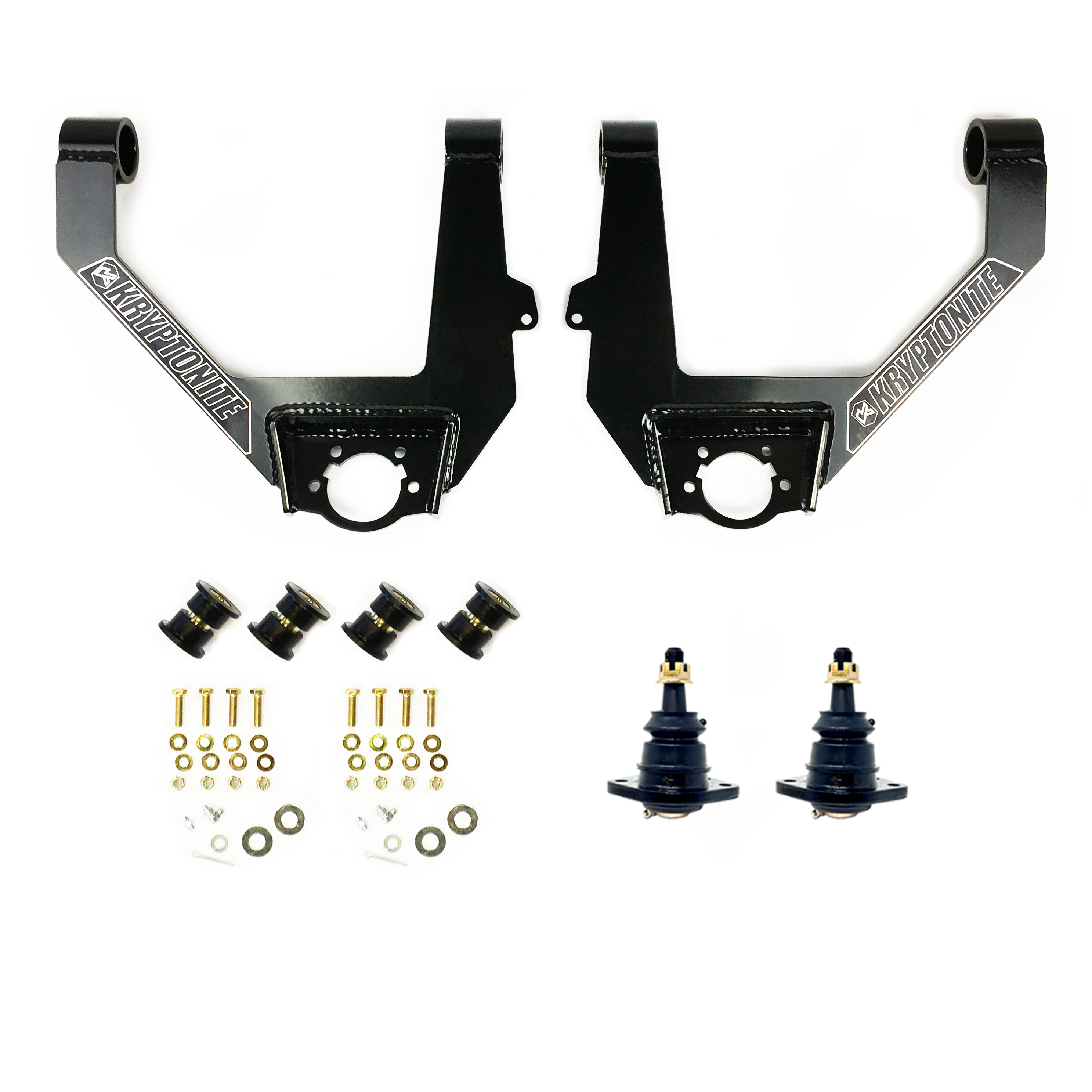

Krytonite stuff also looks solid
Greaseable fittings all over
I would 100% recommend kryptonite. They make a quality product. If memory serves me correctly, I had over 20K on their control arms when I sold the truck.
Edit: These are the arms off of my 2010 2500. They were beefy for sure. The only weird thing is that they didn’t have a attachment point for the ABS wire. I zip tied it to the control arm which never was a issue.

Ok, well my entire plan of buying the UCAs and then the 2.5" front kit and the 2.5" rear block just went out the window
I helped to install a Superlift 3.5" kit on a friends 2015 Silverado High Country today...….impressed with the ease of install and the ride quality, even with his 20" setup
I was going to go with the 2.5" kit and then the 1.5" body lift later in the year. Why do two things twice and have both installs take 10 hours?
SO.........I just ordered the Superlift 3.5" kit, that comes with diff drop spacers and new UCAs
I just will buy the 2.5" tall rear blocks and use the rear shock extension brackets that I have
One kit and done...….plus it will save be money by not having to buy $500 UCAs
