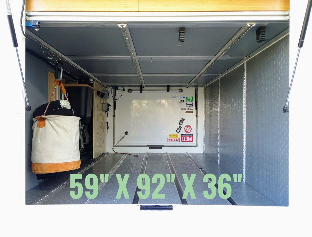

Dimensions of gear garage/storage in the back?
92" between the large hatches allow easy access from both sides of the box. 36" height is enough to fork-mount most bikes on the floor.
113 cubic feet, very spacious, largest gear storage we've seen in any expedition vehicle of this size.
There's L-track mounting hardware throughout the gear garage. Also, it has heat, ventilation, DC and AC power, LED lights and ambient temperature is displayed on the main control panel.
