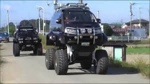

I saw on another forum you were trading the F350 in for a Toyota Previa Minivan? True or nah?
Has to be Supercharged to spin these TSL Boggers :p :geek:;
