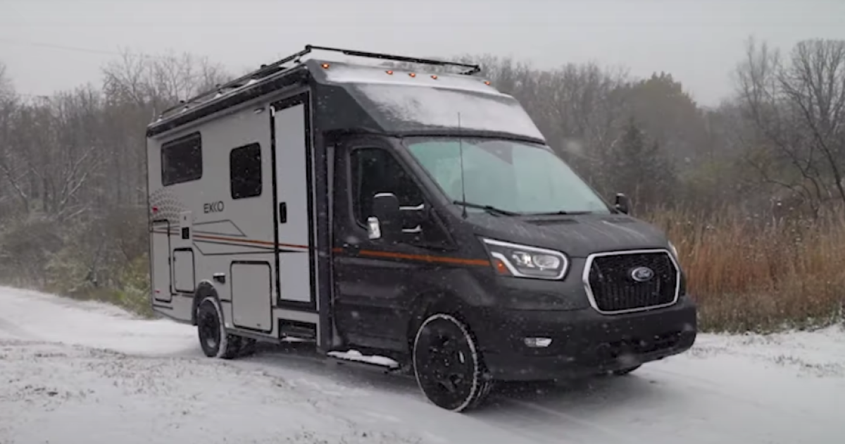

The latest Winnebago Ekko.
Built on the Ford Transit AWD .
90
90
Pretty cool but a bit strange to me to have the body a different color than the cab. This makes a high dollar new MH look like a thrown together home build.

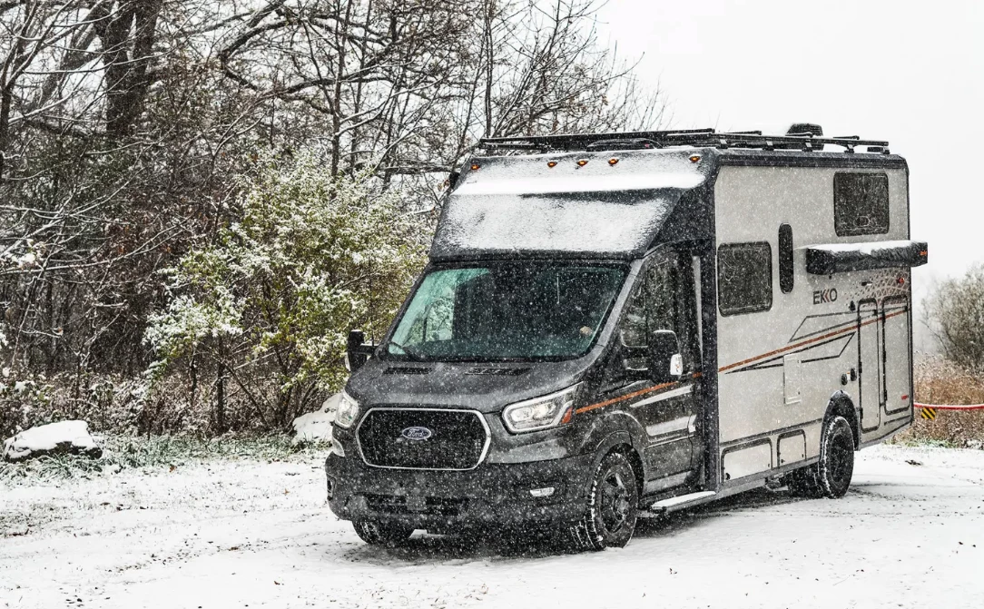

90
90
Don't get too excited... Just another RV mounted on an AWD drive chassis. Dual tires... low ground clearance and typical RV build quality.
i think there is a very interesting element. Dual tire is a non issue for most people that will end up on the Transit platform. I drove both single and dually transit and i prefer the dually. if anything...i make for a even more stable vehicle as a RV. Yours would do very well as a dually for the kind of use ''i think'' you do. The ground clearance is a easy fix once you put 3'' tall tire and the lift kid like most of us do. But i agree....the build quality most likely wont be very good.
They probably leave the box white due to risks of darker colors causing the delamination of the foam core panels. This quote from Total Composites is telling:
“But we do not recommend changing the white color to anything darker. There would be an increased risk of delamination due to higher surface temperatures. These higher temperatures could soften the panel adhesive and possibly cause the separation of foam core and FRP skin.”
Best example of surface temperature change at 10am , in Arizona in may. We vinyl wrapped the rear wall of our last truck in that colour and did not have any issues. But this doesn’t mean someone else wouldn’t! Best to keep the colour very light.
I would love to see the test done with some of these modern overlandy truck colors like desert tan or really light gray. So much better than a white box. Having owned 6 or 8 white boxes I'm just not sure I can live with it again. But, one good thing about a Total composites type box is that it would be very easy to keep the top white without anyone seeing it, given that it's not covered with solar panels, which mine would be.
