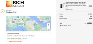

For me system I opted for two Rich Solar MEGA 250W panels. Besides offering the dimensions close to what I was searching for, Rich Solar were also nice enough to post dimensions and electrical specifications in an easy-to-read format.
Free shipping was one of the most valuable benefits associated with purchasing these specific panels. There were many times where I had beautiful Panasonic or Canadian Solar panels in the shopping cart, ready to buy, and when shipping was calculated for two panels I decided not to complete the purchase. It does seem that shipping solar panels has improved a bit over the past few years but there still remains much variability in cost overall.

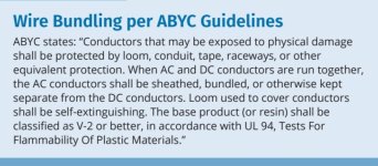

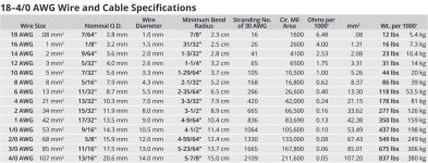

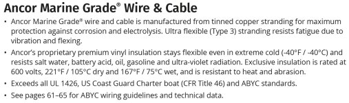

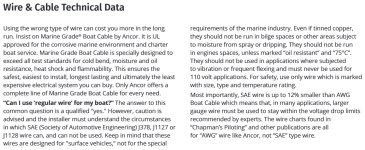

Today I decided to purchase two spools of Ancor 4 AWG marine grade wire to be used for installing my new Victron Energy Orion XS 12/12-50 DC-DC charger that will charge my house batteries via my 380 amp alternators when driving. Some of you may recall me purchasing two spools of Ancor 6 AWG wire that was scheduled to be used on an Orion-Tr Smart 12/12-30 DC-DC charger but plans changed once an insider at Victron Energy confirmed that the newer, more powerful and more efficient XS was being released soon.
For my application, I most likely could have still used the 6 AWG but since I am wired, pun intended, to take advantage of the best tools and materials for my specific application - I took a moment to smile, and the ordered more wire. I just do not see the logic in purchasing premium components from companies such as Victron or REDARC and then pairing them with sub-optimal components such as budget wire and connections. Excessive heat due to increased resistance is a significant concern within an electrical system and voltage loss is yet another reason to make sure you are using the correct components for each application. Here are some details regarding why I selected Ancor marine grade wire:

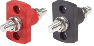

When my Four Wheel Camper was originally installed years ago I decided not to use the common Attwood Marine Heavy Duty Trolling Motor Connectors supplied by Four Wheel Camper. I believe that for most application the Attwood units connectors would work well but keep in mind the wires are 10-gauge so they are limited in how much current they are able to carry over a long distance (from engine to house battery). I upgraded to a nicer Marinco 70A 3-Wire Trolling Motor Plug & Receptacle Combo, and have been happy with the results. The problem is, the Marinco will only accept 8-gauge wire bare and 6-gauge wire with a ferrule.
My solution was to purchase these two Blue Sea Terminal Feed Through Connectors which utilize a 3/8-16 stud on either end, are IP66 rated, can pass 250 amps at 48 Vdc, and most importantly - the studs are tin-plated copper alloy. A Victron Energy XS 12/12-50 using Ancor 4 AWG wire, and passing through the bed of my truck via Blue Sea connectors - I think that's about as good as it can get. And I won't ever look back and wonder why I didn't spend the extra $50-100 and purchase the best components for my application.

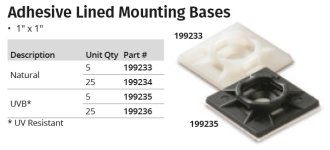

I hope these Ancor cable tie mounts are good quality. I have been searching for good tie mounts for some time but most of the companies I have come across where names I was unfamiliar with. Sure, this is a low cost item although I would rather pay $0.50 each and have them last instead of paying $0.10 each and having them fail a year down the road. The reason I will be using these is to minimize wire and cable vibration which may not seem like a big deal but with 200 Ah of lithium batteries, 500 watts of solar on the roof, and my DC-DC charger pushing 50 amps while I am moving - I want to make a reasonable effort with regards to keeping everything intact while driving for hours along rough trails.
A spontaneous vehicle fire in the middle of the forest or desert is not something I wish to involve myself with. Virtually all men have been burned to various degrees previously and it's no so much the heat of the fire, but all the associated paperwork, negotiations, etc., that I certainly wish to avoid. Happy trails men and always remember, you deserve to spoil yourself on occasion, so spend the extra few dollars and enjoy!!!
As always, I will share the order details. Over the years it is interesting to look back and compare current prices to previous ones and one of these days I plan to walk through my entire post and total up all my expenses.
