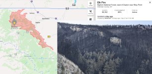

The new fire I was heading to was the 98,000 acre Elk Fire just outside Sheridan, Wyoming. One of my buddies from a previous fire was leading the team at this event so I was looking forward to meeting up with him, sharing some stories and laughs, and slowly beginning to move back towards the east. My schedule was stacking up and I had adventure with other friends scheduled for late November and this next fire was conveniently on the way there.

A new incident management team arrived and at the same time the weather was really beating down the fire - this is good for everyone. For me, this fire season has ended and although I have enjoyed the past few months, I have been dreaming of getting back out on the road again, exploring, adventuring, spending time with friends, and living life...
