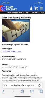

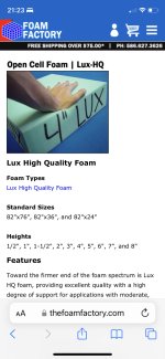

What are you using for foam?
Thickness?
Density?
The wife looked up the details.
She ordered this in the 2" version for the seat cushions and then added 1" on each side of the HD36 ( below).
For the couch backs... 3" version of the HD36 foam. It turned out to be a bit firm so we are changing it to a slightly softer version. The LUX HQ (top) is a bit firm for the couch seats but should break in nicely and has a really good advertised life span.
