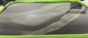

The wife poured a new table for the L couch. Will put a matte finish on it this week.

What is the table made of, clear epoxy? How thick is it?
Yeah I noticed the huggies box. I was definitely curious.
The table is 3/4 plywood with Stone Coat epoxy finish poured over it. Pretty easy process. Wife has it down to a science!
We did the kitchen counter the same way, except it has a 3/4 bamboo board. We used what was left of a 4X8 sheet the shipping company bought us😁.
