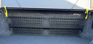

I also mounted up the Builtrite extrusion to the bulkhead of the bed. I have MOLLE panels for that as well as the bed sides on the way. I had these on my last truck but wasn’t sure I’d want them. I already miss them and I plan to use them to mount my cabinets once I figure those out.
I’ll likely use Baltic birch but also kind of want to try 80/20. We’ll see.

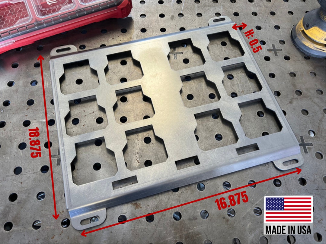

I ended up using one of these plates, and mounted my Packouts to it at the front of my camper. The picture is before the plate was installed, but it’s in the exact same position just 1/2” higher now.
Mines on a Carbonized 7.3 Tremor as well. Just a 22’ lol

That’s a nice Packout plate. I have 4 from Milwaukee and they are pretty bulky.
Great build on the camper too!

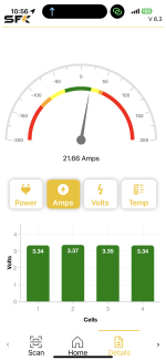

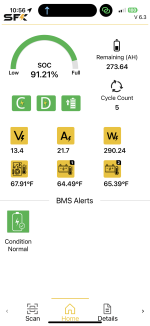

Ran the battery down to 57% by the time I got down to NC which took 5 days with the fridge/freezer running. In about 6 hours of driving it's fully charged. Real world charging has averaged 21-22amps.
I'm going to test out the draw with the heater once I get home and settled back in but I think this makes me feel good about not spending a ton of money on solar.
