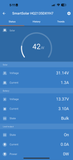

Last year in August and early September I experienced a flat battery due to the DC-DC charger not keeping up due to heat. Victron newer model has some significant improvements but I didn’t want to make the change just yet.
Today I installed a Renogy 200w Shadowflux solar panel as a back up power source and likely solve my charging issue. Relatively straight forward install, the wires in the cap were already done so I just had to make up an extension wire and terminate the gland connections. The panel was almost a perfect match for the factory L track, I just had to enlarge the Renogy mount holes and boom, it was on! I need to get some real wire clamps but other than that it went great.
Very hazy/coudy day at 5pm Eastern in Michigan and still averaging 42 watts.
