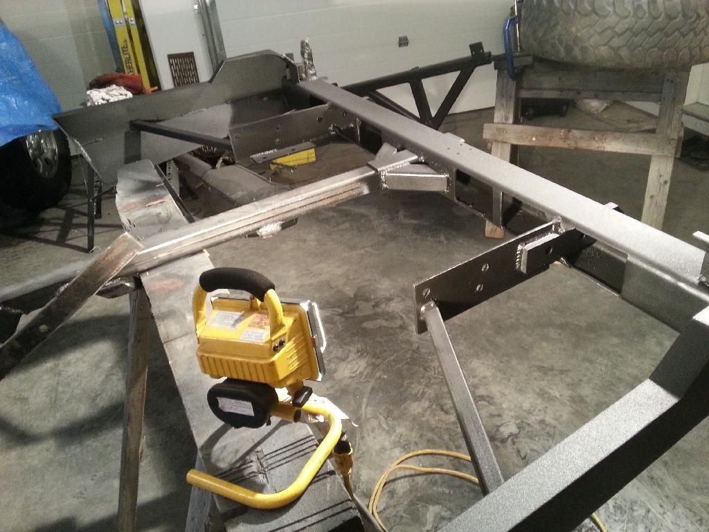

Got all the pieces cut for the 1/4 panels
All tacked up
Starting to grind things down

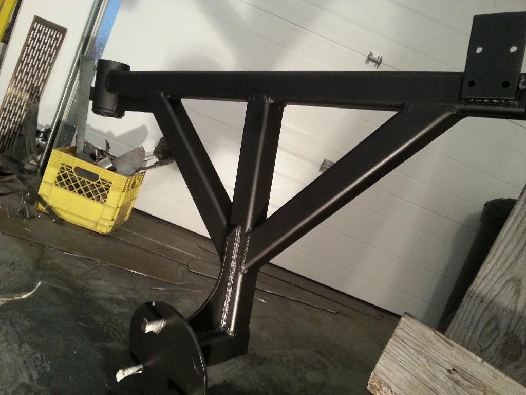

I did decide to go dual swingout. The second spindle is welded in.
Gussets for the swingarm

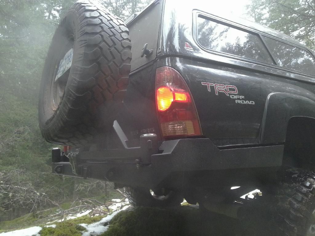

Got the bumper to a driveable condition today.
The trim I put on the cut edges of the bedside lasted for about 15 minutes before detaching and looking like crap, so I will need another source, or I will just leave it raw. I did paint the exposed metal. What are you guys with HC bumpers using?

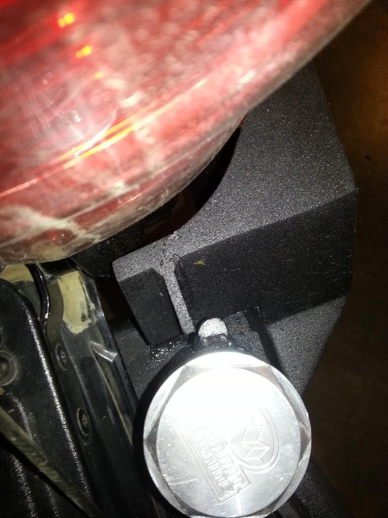

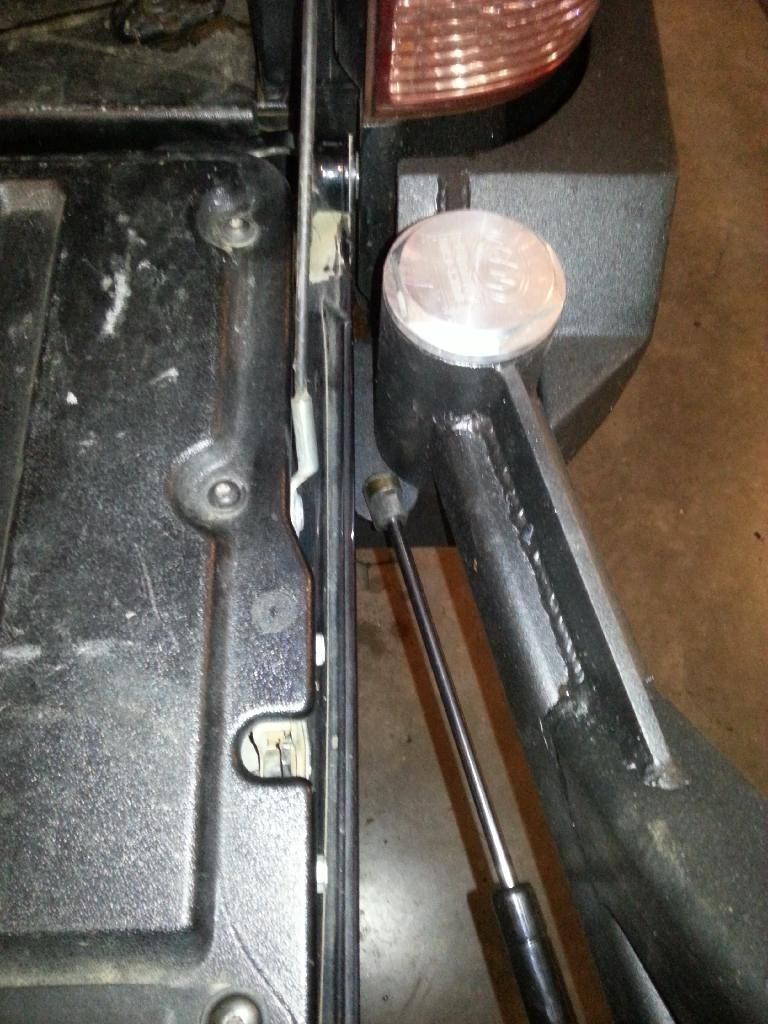

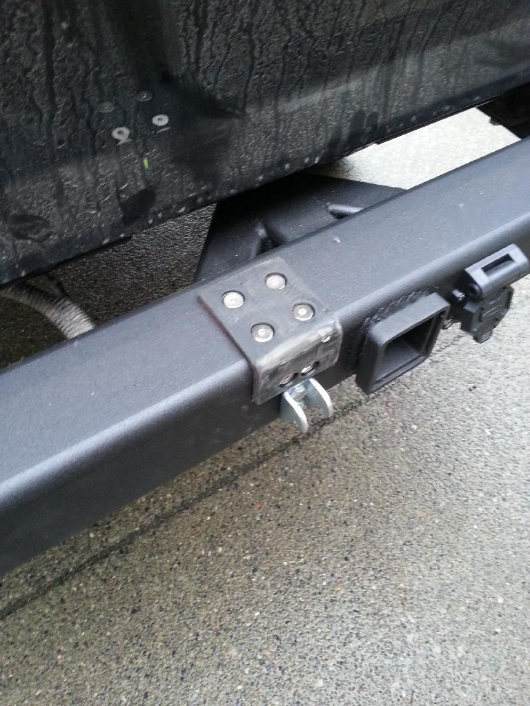

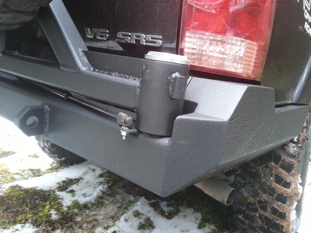

Pretty tight clearance here. This was a bit of an oversight on my part. I didn't build the bumper low enough the clear the gas shocks while the tailgate is down. Not quite as clean this way, but is functional.

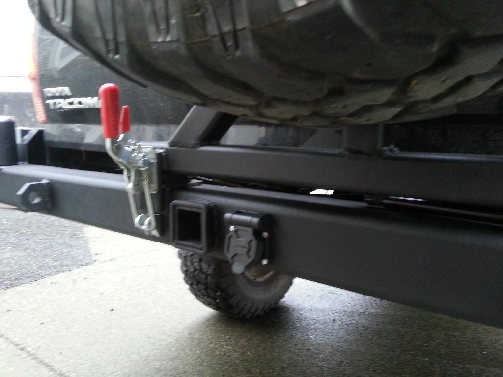

This is the stop for the swing arm
Gotta fix that trim...

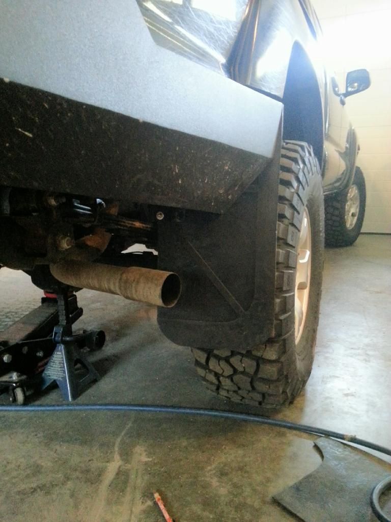

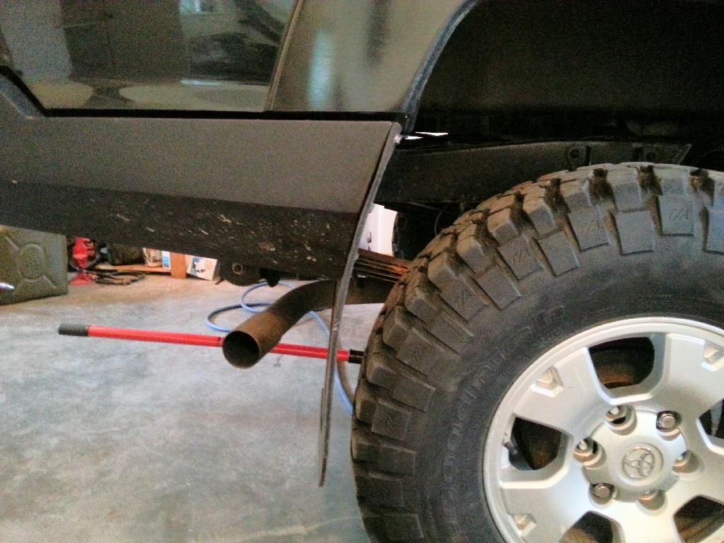

Well after driving 3000km over Christmas, twice through the rockies in winter, I discovered I really need mud flaps lol. The lower part of the bumper looks like a dart board from chips caused by road sanding, salt and other garbage on the road. Easy to touch up to keep from rusting, but I dont want to be screwing with it all the time.

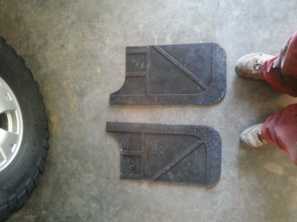

Enter gigantic semi-truck rubber mudflap.
All cut up
