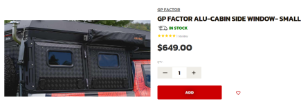

  4. To file under future upgrades, I found this nice outside window options for the AluCabin 1697722076782.png

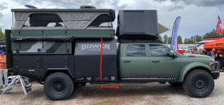

Bowen has done slim front garages on flatbed builds (see below).
I see no reason he can't also do that for a "topper bed". Note that if you go down that path you're going to need to extend the bed to around 7.5-8ft in order to fit a standard size alucab topper. Perhaps you can instead do an alucab from a 1500 series truck with a 5.5 bed. A little less interior space but it would keep the bed from being too long.
Edit: formatting.

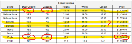

  • We would prefer a 90L fridge and a dual system.

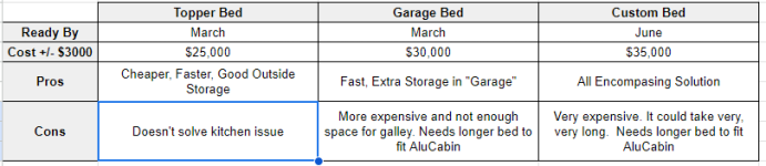

Here's where it gets more complicated, bed options:
  • Goose Gear Storage System: The bed is not compatible with Goose Gear, so we would have to go custom. We like their sleeping platform system. So, with a custom approach, our aim would be to emulate that core functionality. One viable approach is teaming up with Bowen to craft some aluminum panels, then working to mirror the bed platform and integrate storage solutions ourselves. After thorough research, it's clear there's no real competition to Goose Gear in the market. Finally, the other restriction for the sleeping plattaform is the height of the fridge or any other item you want to keep there. It has to be under 19". (See fridge options specifications)
  • Kitchen Setup: Should we opt for a kitchen galley, it's clear we'd need to go all-in on a custom solution from Bowen. The 'garage' space in their bed design accommodates 15" width. We require an additional 5". There's still research to be done on what extending the bed length, potentially by 10-20 inches, would entail.
The Not-So-Fun Part: Budget and Schedule (please note, the following details need confirmation and will likely necessitate a follow-up meeting with Bowen):
One option is to delay the bed upgrade, see how things pan out, and decide later. I'm leaning towards this approach. That said, considering the current incompatibility with Goose Gear and the rear bumper, taking action now could result in about $8k savings. This amount could then be reinvested in the bed project.

  3. Will the larger Dometic Fridge fit when placed lengthwise?

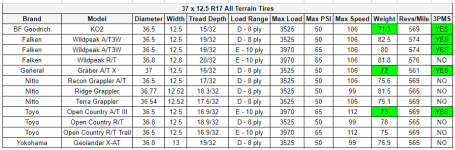

A quick note on tires. It seems like when selecting for size, weight, 3PMS and loading rate the 3 best tires are:
BF Goodrich KO2's
General Grabber A/T X's
Toyo Open Country A/T III
I'm specially intrigued by the Toyo offering, it's a E - 10ply load tire at 73lbs!. However I can't find specific reviews of this tire.

I can't recall where you are located. I have 35x11.5 AT3's in load range E on my truck. I can't say I'm terribly impressed with how they handle snow / ice / slick conditions. Not sure if that is an issue for you. I would not buy them again.
For reviews, I believe this tire has been discussed on this site a few times?
